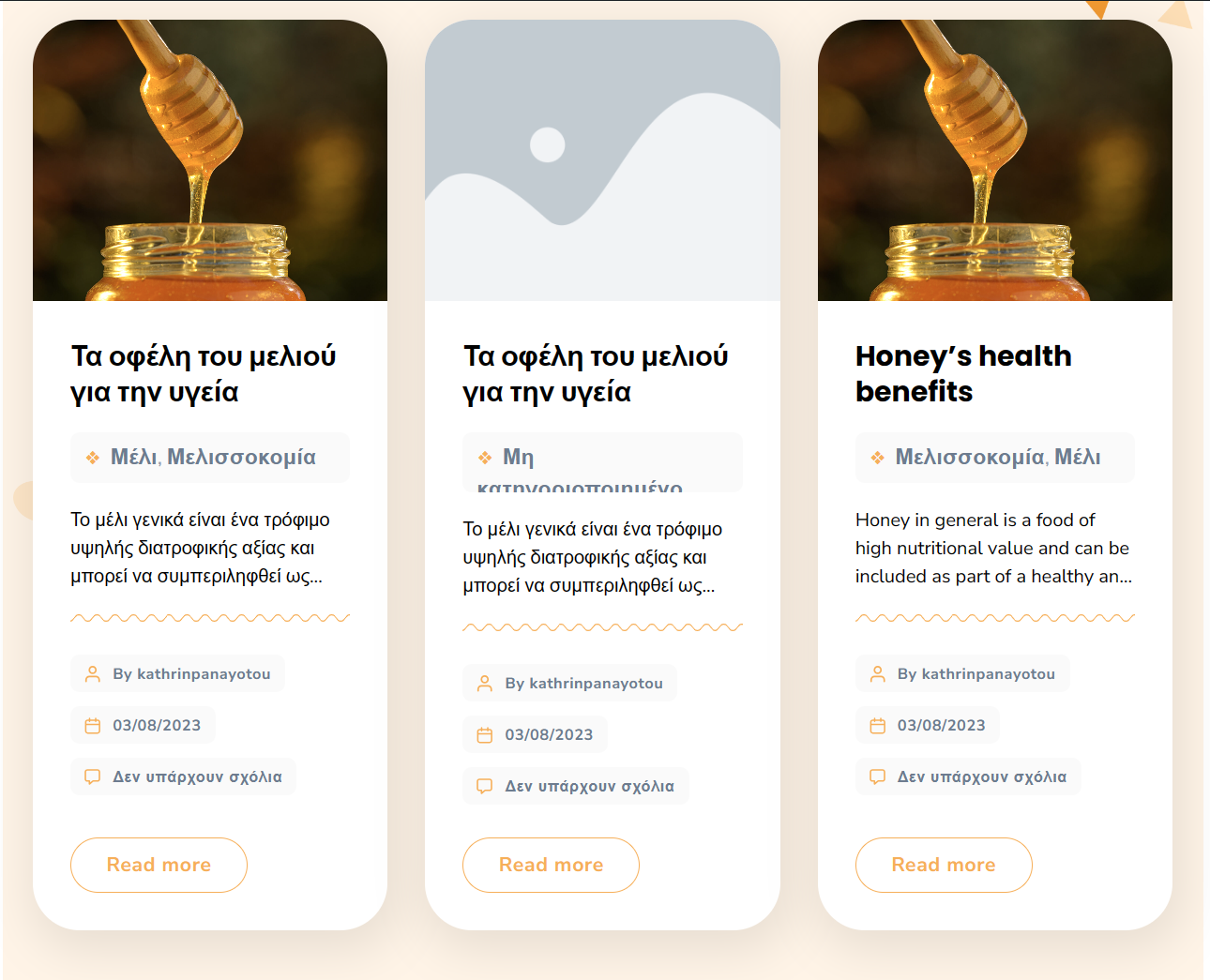

Hello. I am new to wordpress and WPML. I am using Hanio theme to develop my website. I followed documentation of hidden link to develop my website. I used WPML to translate content of my website from English in Greek. For example, when I create an article, I create its translation in WPML.
Though, I am experiencing an issue with the Recent Posts Grid on the Home page and About Us page in section "Blog". No matter what language I choose, some of the posts appear in English and others in Greek. When I select to view the page in English, it should only display posts in English, and when I select to view the page in Greek, it should only display posts in Greek. Also, a post I threw in trash is also displayed in the middle, as you can see in the attached picture. But, by clicking the button "All Posts" in the "Home" and "AboutUs" pages and changing the language, the content will appear in the correct language. I would like your help, since I don't know how to solve this. My website is hidden link
Thank you for taking the time to review my issue. Looking forward to hearing from you soon.

While reviewing the Blog section on the Homepage, I noticed that the blog posts are being displayed using the theme's default Elementor widgets. It's important to note that if a widget does not have WPML support, it might not function correctly in other languages.
For your information, the Theme that you're using currently(Hanio) is not listed in our Compatible theme list. Therefore, it could be a compatibility issue as well.

Thank you for recreating the issue in our sandbox. I've taken a closer look and it seems the support for WPML hasn't been extended yet for the widgets. This is why, the default and translated posts are showing in the frontend all along.
However, by tweaking the code for the widget template, I was successfully been able to display the post correctly in each language. You can take a look at this page: hidden link
