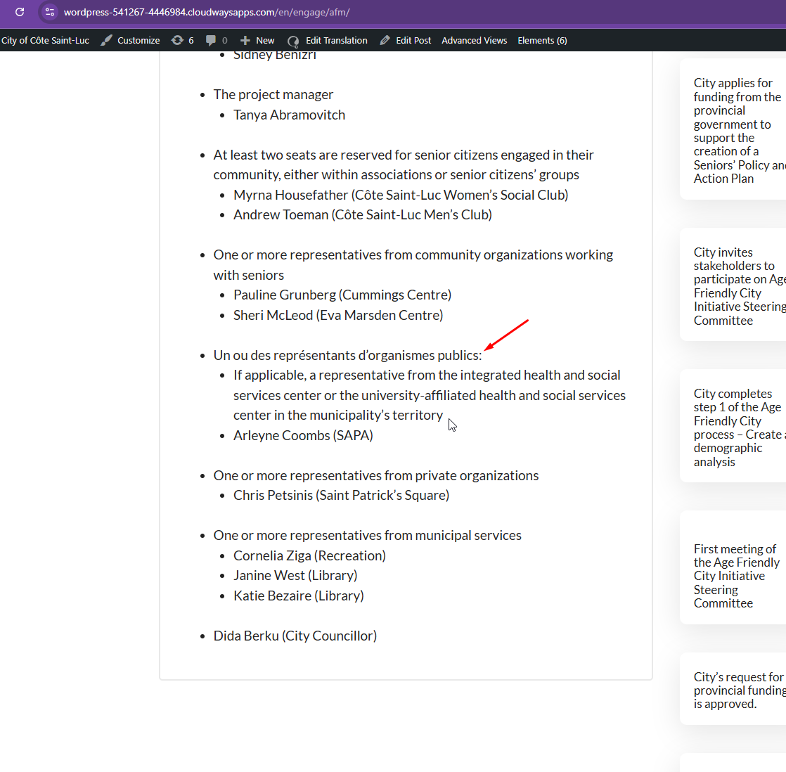

I am trying to translate lists with two levels on some pages. Even though the text is translated in the WPML translation editor, the translation doesn't appear on the front-end for the text in the first level of the list. I purged the cache and made some edits to the page, but it didn't work. The only thing that worked was adding a colon at the end of the first level/before the second level in the original language. Link to a page where the issue could be seen: hidden link
The text in the first level of the list was not translated on the front-end until I added a colon at the end of the first level/before the second level in the original language. Now it works because I added the colon, but before I did that, the text was not translated (Steering Committee tab).

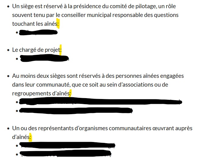

Mary

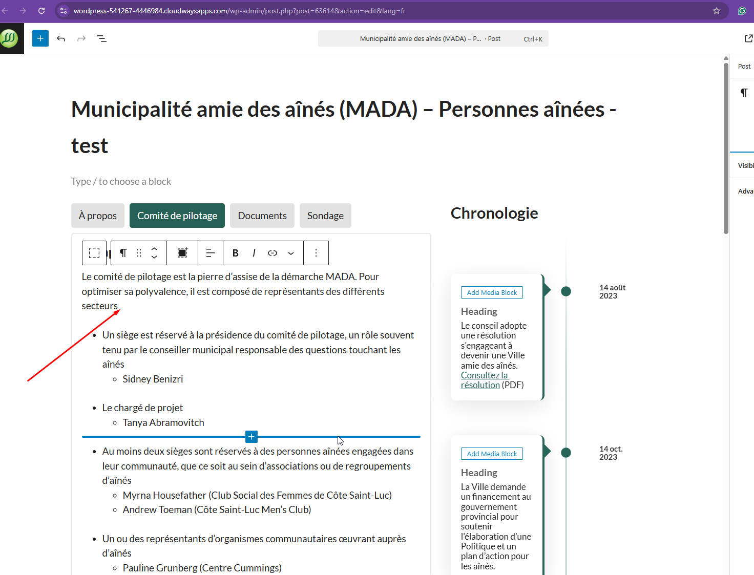

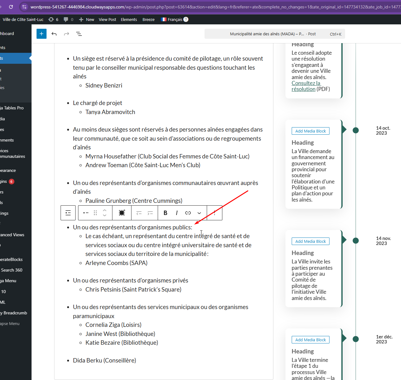

In the image attached, if I don't put the colons highlighted in yellow, the sentence preceding that colon is not translated in the other language on the frontend, even though it is in the WPML ATE. This only happens with list that have 2 levels. I haven't tested it with lists with more than 2 levels.

Mary
This is not the sentence I was talking about. That sentence was already in English.
Please see the (yellow) highlighted text in the images below. One is in the Steering committee tab, the other is in the About tab.
The highlighted text is in French when it should be in English. In both cases, the issue is in a list with two levels, and it affects a sentence in the first level of the list.

Thanks for your reply. I can see the untranslated strings you mentioned. You said, "if I don't put the colons highlighted in yellow, the sentence preceding that colon is not translated in the other language on the frontend."
However, after adding a colon to the first level of your lists in French hidden link , as shown in the attached screenshot, the issue still persists, as also shown in the screenshot. Could you clarify how the colon is related to the translation not appearing on the English language page hidden link ?

Here is my clarification:
At first, I had a list with two levels, and in those lists, the item in the first level did not appear as translated on the front end even though it is translated in the WPML ATE. I tried editing the French, resaving, editing the translation, resaving, etc. Eventually, in the original language, I added a colon at the end of the first level. And after I did that, the sentence appeared as translated in English. That's how I found out the colon seemed to be related with this bug.

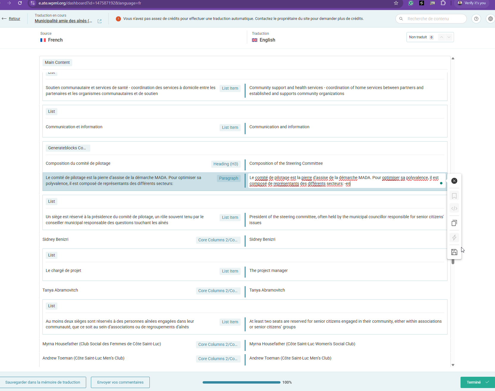

As you'll see, in some cases, the sentence actually disappears from the ATE.
I can't find a clear logic for the issue other then it only appears in the first item of 2-level lists, but I think the video may still be useful.

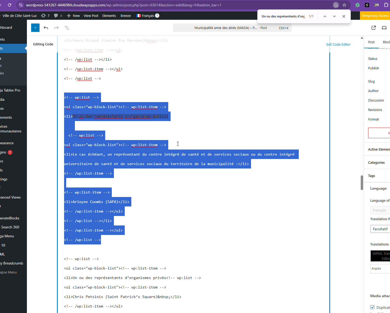

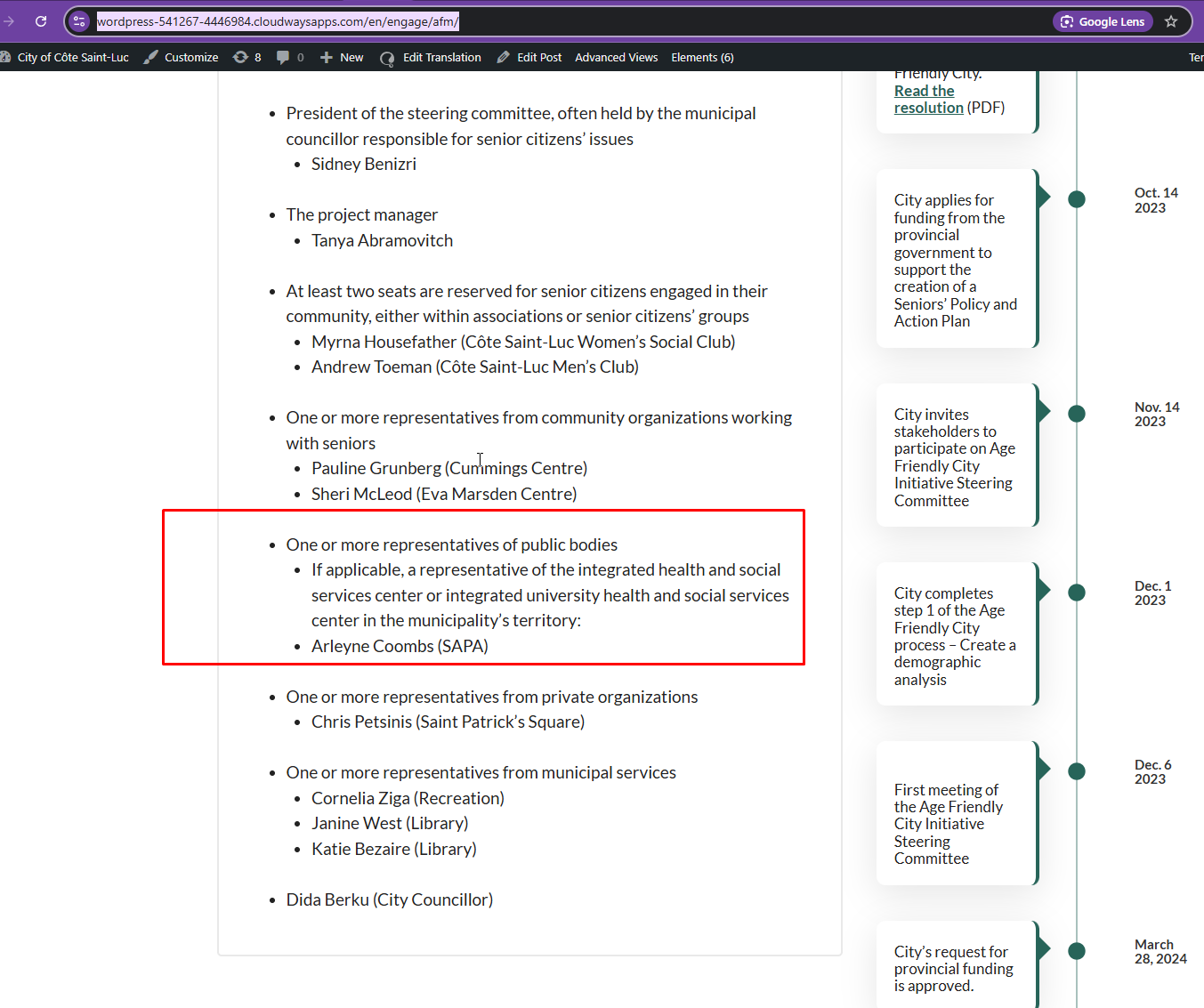

Thanks for your reply. I've checked and I can see the issue now. It looks like the HTML structure is incorrect, hence causing the translation issue. I copied the HTML structure of the "Un ou des représentants d’organismes publics" section and corrected it using ChatGPT. Now the translations show up fine in the English language, as shown in the attached screenshot.

What you can do would be to switch to the code editor and copy the entire HTML structure. Then, ask ChatGPT to double-check the structure for you. I hope this helps.

Hm, that's unfortunate, because this is how WordPress created the list when I inserted a list block.
Also, on my end, when I tried to edit the HTML in the problematic list under the About tab, it caused an error, and I couldn't return to the visual editor unless I reverted to the original HTML. When I looked at your updated French HTML in the code editor (in the Steering Committee tab), it ended up creating some duplicate list items.
After some trial and error—switching between the HTML and visual editors—I was finally able to resolve the issue. Just wanted to flag this in case others run into the same problem or if there's a more stable way to edit these lists without breaking the block editor.
