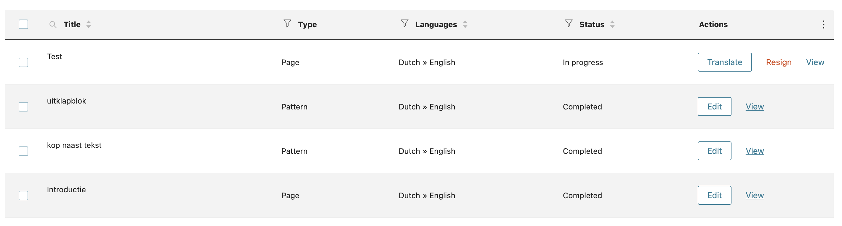

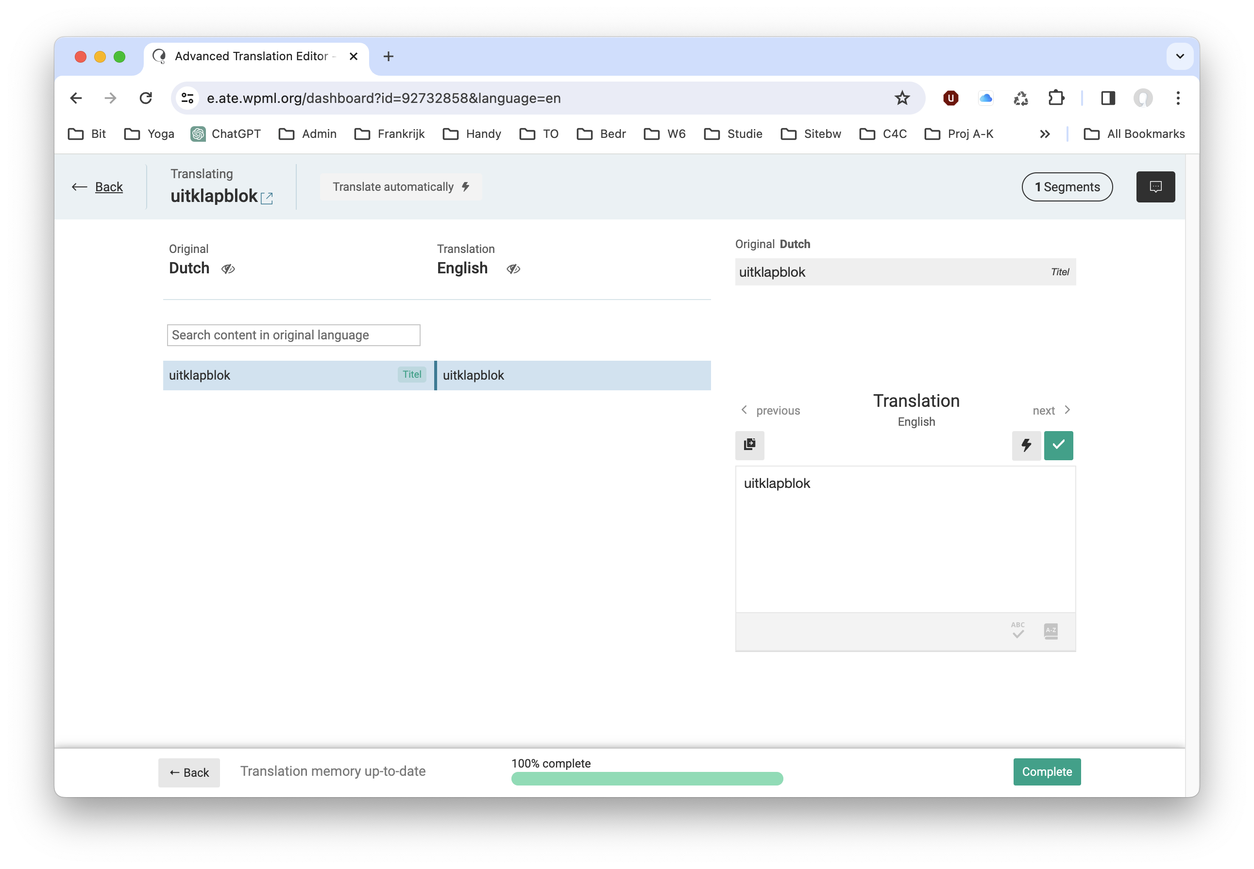

- I followed the checklist and everything is okay. There is only one php-plug-in missing: eval(). Could that be the problem? If so, I'll ask my provider to install it.
- as I mentioned to your collegue Noman yesterday, I followed the instructions for 'reusable blocks. And indeed, I can translate patterns. But the elements that are part of these patterns are missing. I added screenshots.

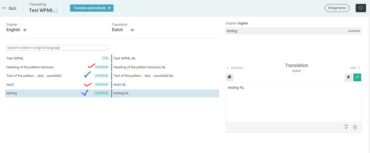

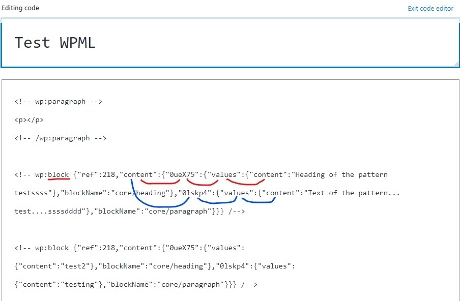

I tried a pattern from one of your existing ones which has the following footprint:
<!-- wp:block {"ref":218,"content":{"0ueX75":{"values":{"content":"Heading of the pattern testssss"},"blockName":"core/heading"},"0lskp4":{"values":{"content":"Text of the pattern... test....ssssdddd"},"blockName":"core/paragraph"}}} /-->
So I used following XML to register it in WPML -> Settings -> Custom XML Configuration:

Then I made some change in the original content, saved and I was able to translate in ATE.
Screenshots are attached for reference, as well as, the test page at hidden link.
Since a pattern is a collection of blocks, which may already been recognized by WPML. But you can consider pattern itself a block, so it needs to be registered/recognized with/by WPML.
