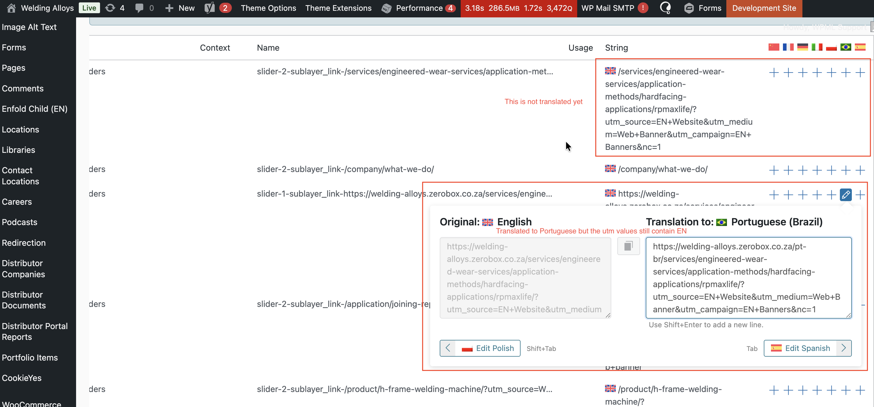

Regarding the UTM tags, I see that in String Translation there are URLs that aren't translated yet, and there's also one URL "hidden link" which is translated to Portuguese but the translated URL still contains UTM tags referring to "EN".

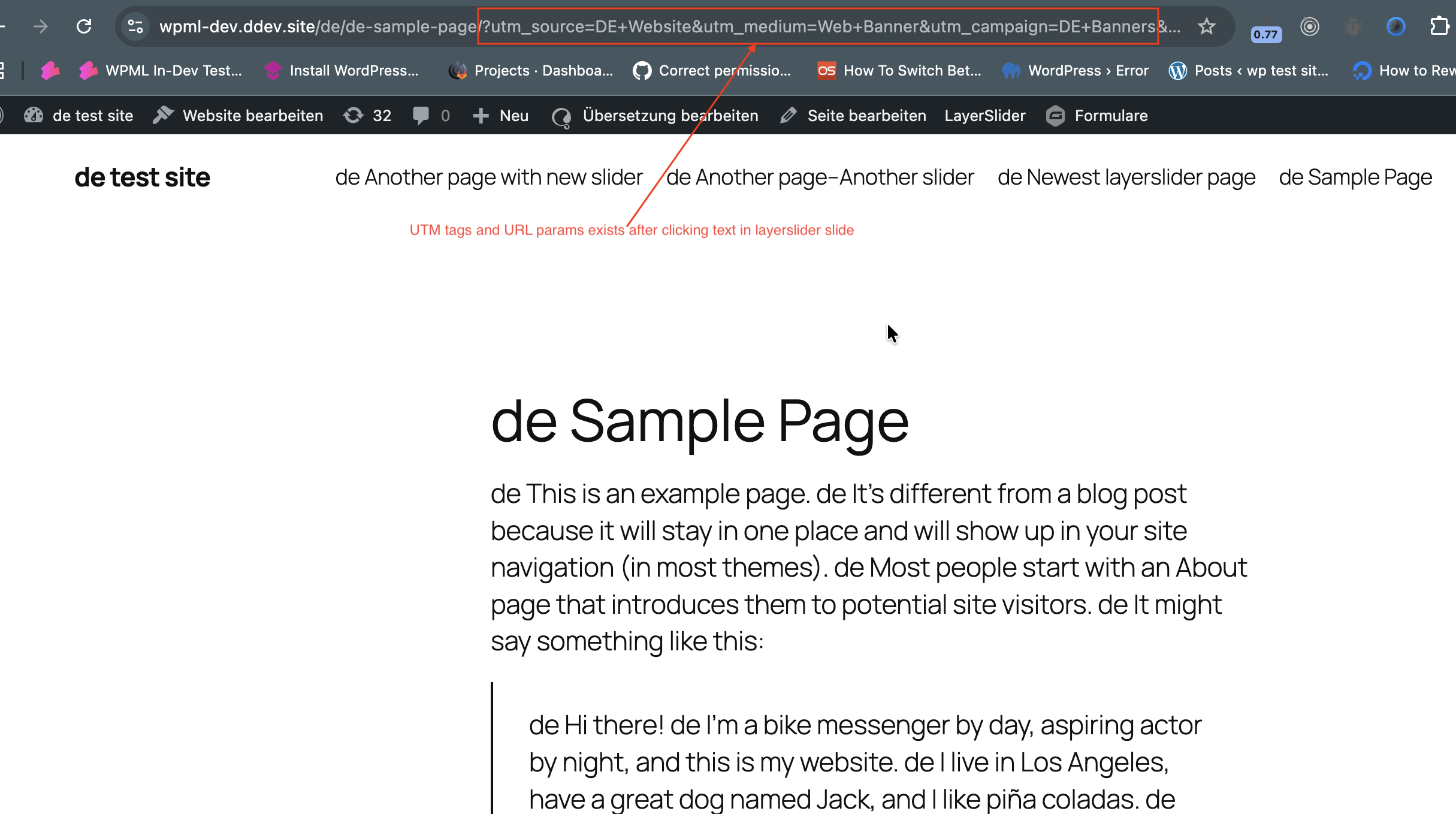

I've tried the same scenario locally and all I needed to do is:
1. Go to String Translation page and start translating the URLs
2. When translating a URL, make sure you're adding the correct translated version of it and change the UTM tags if needed.

Refer to the attached "screenshot-from-client-site.png" to see untranslated links on your site.
Refer to the attached "screenshot-from-local-site.png" to see my testing result after I translated link and clicked on it on a LayerSlider slider.
