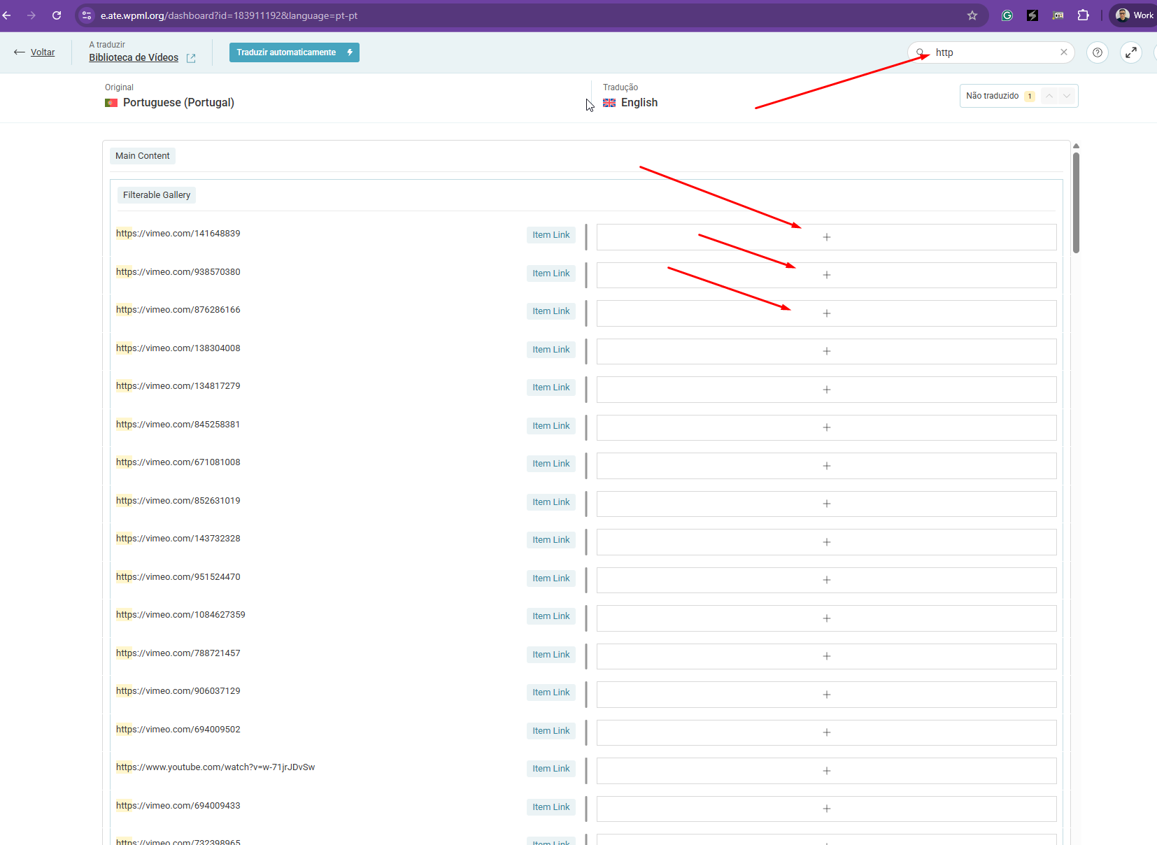

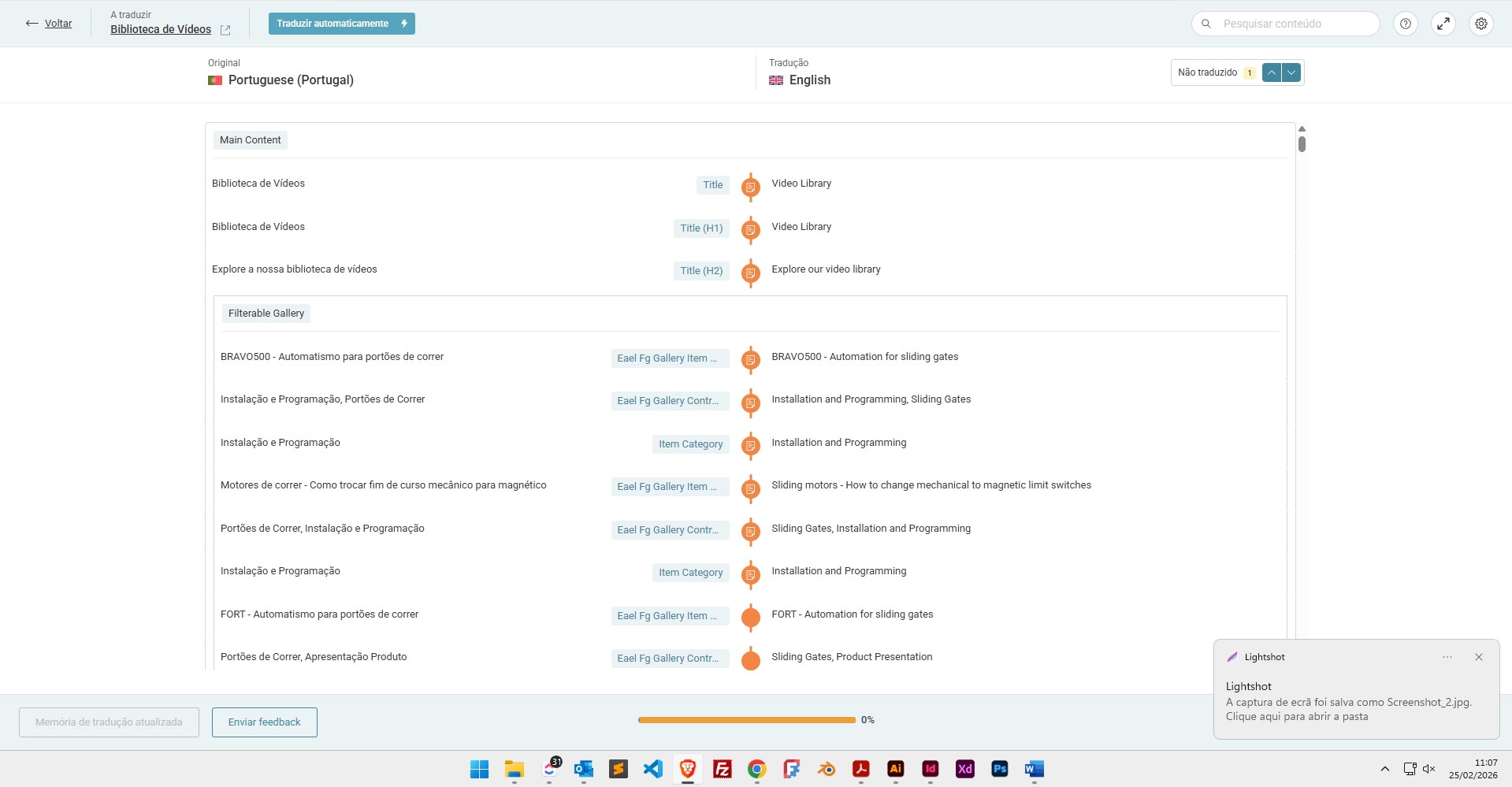

I'm trying to translate the same template em 5 different languages. In some languages it appers in advanced mode, in others is in a simple mode (previous used). I attached images.
In the simple mode the links is translate, like it always had been. In the advanced mode, the i cannot translate, and the previous link translation was forggoten.

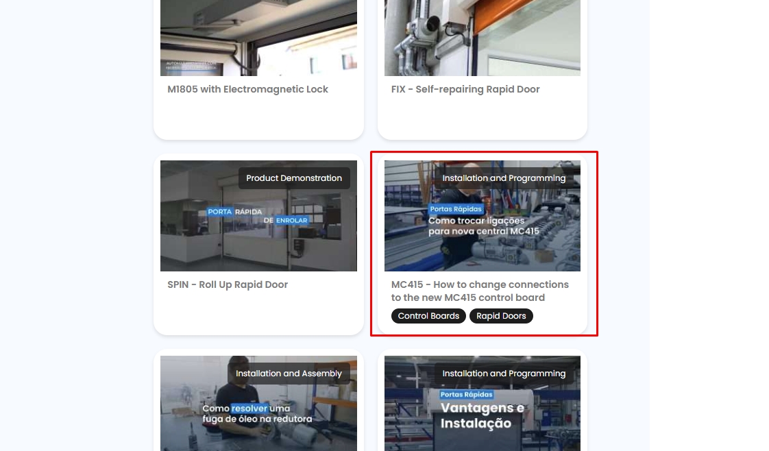

The media images, also isn't translating. Even the previous translation isn't translate

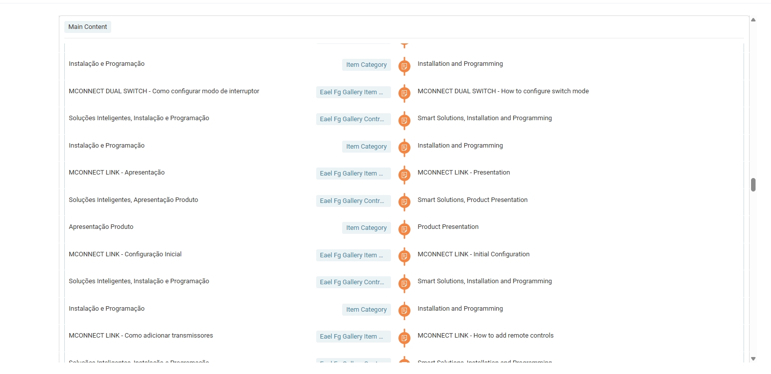

But now, the previous translation translation is missing, and I dan't have the the field to translate.
In the previous image I attached before (which is from another template), we can see that the same template the fields translatable is different from each other.
The images files it's not translating, but in the "media translation" is translated

Thanks for your reply. I've checked your English translation here hidden link, and I can see that you have not translated the video links as shown in the attached screenshot. Please try inserting "http" in the search form as shown in the attached screenshot.
Since these are considered external URLs, you need to translate them manually.

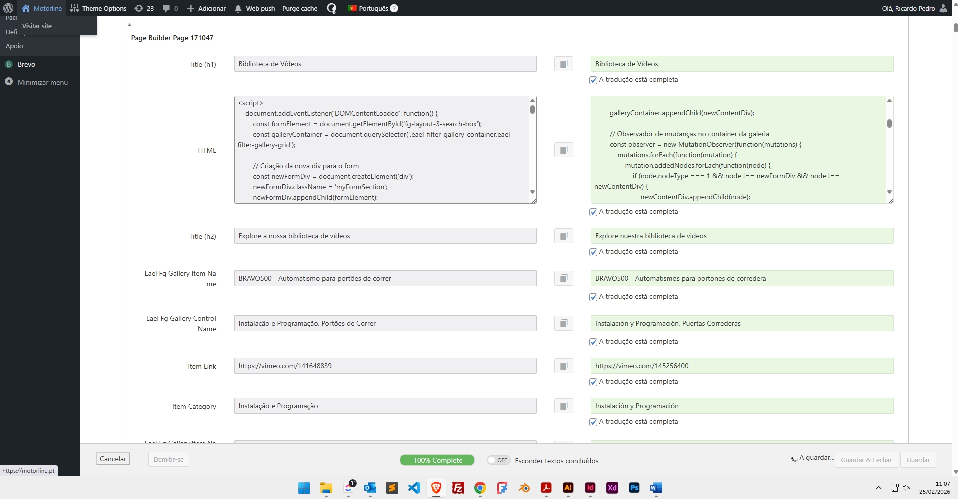

Rafael Viana
Before we updated the plugin to the advanced translations editor, the links was already translated

Rafael Viana
they were translated manually using Classic Translation Editor

Rafael Viana
What about image files.
In teh page isn't translated but in the in the wpml is
