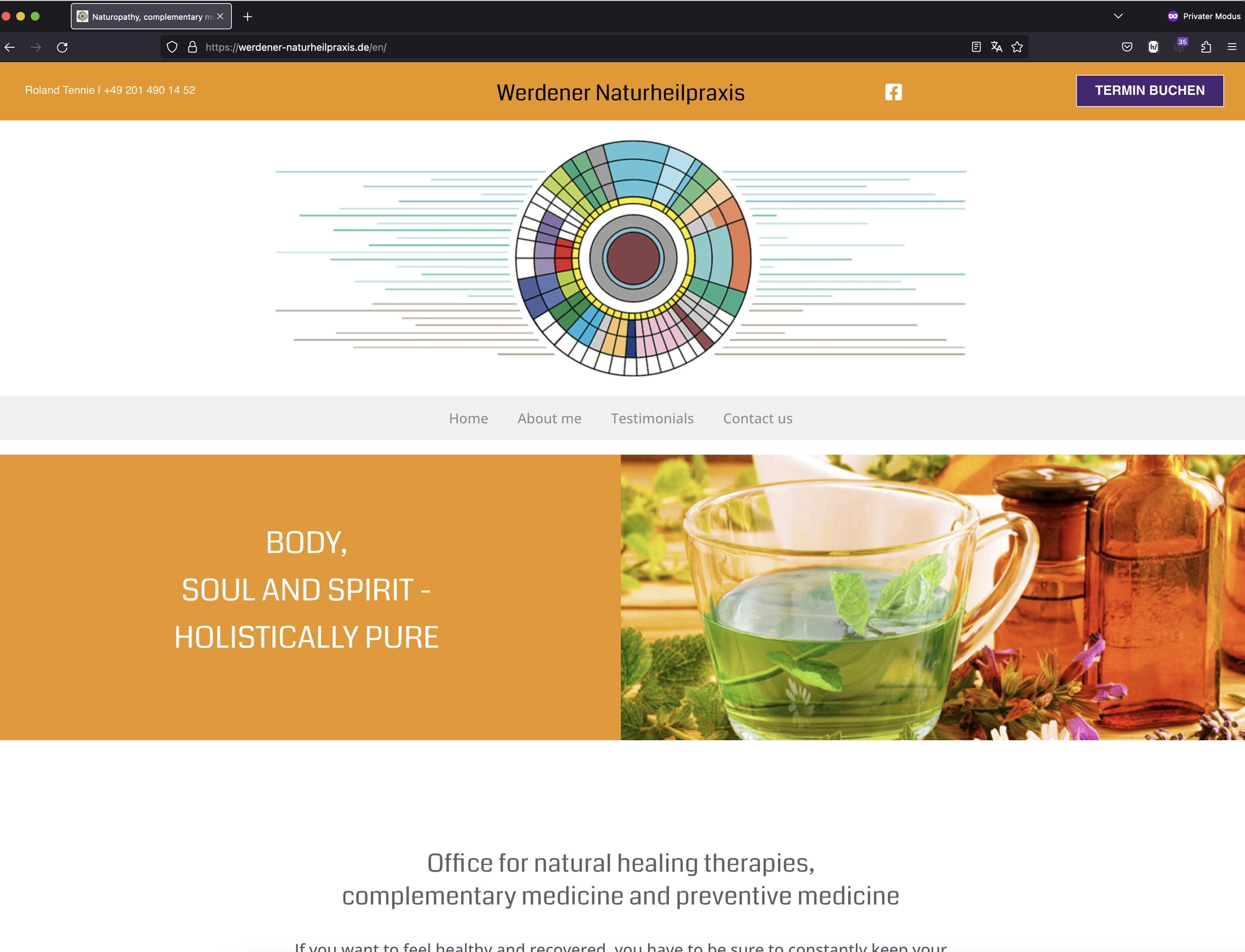

I saw that there is still a problem. When I close the WordPress backend and delete the browser cache or use a private (save) browser window, then the translation suddenly stops working. E.g. the button at the top right “Book an appointment” is not translated when you go to the English page. The same is with the footer.
What is wrong?
Kind regards,
samy

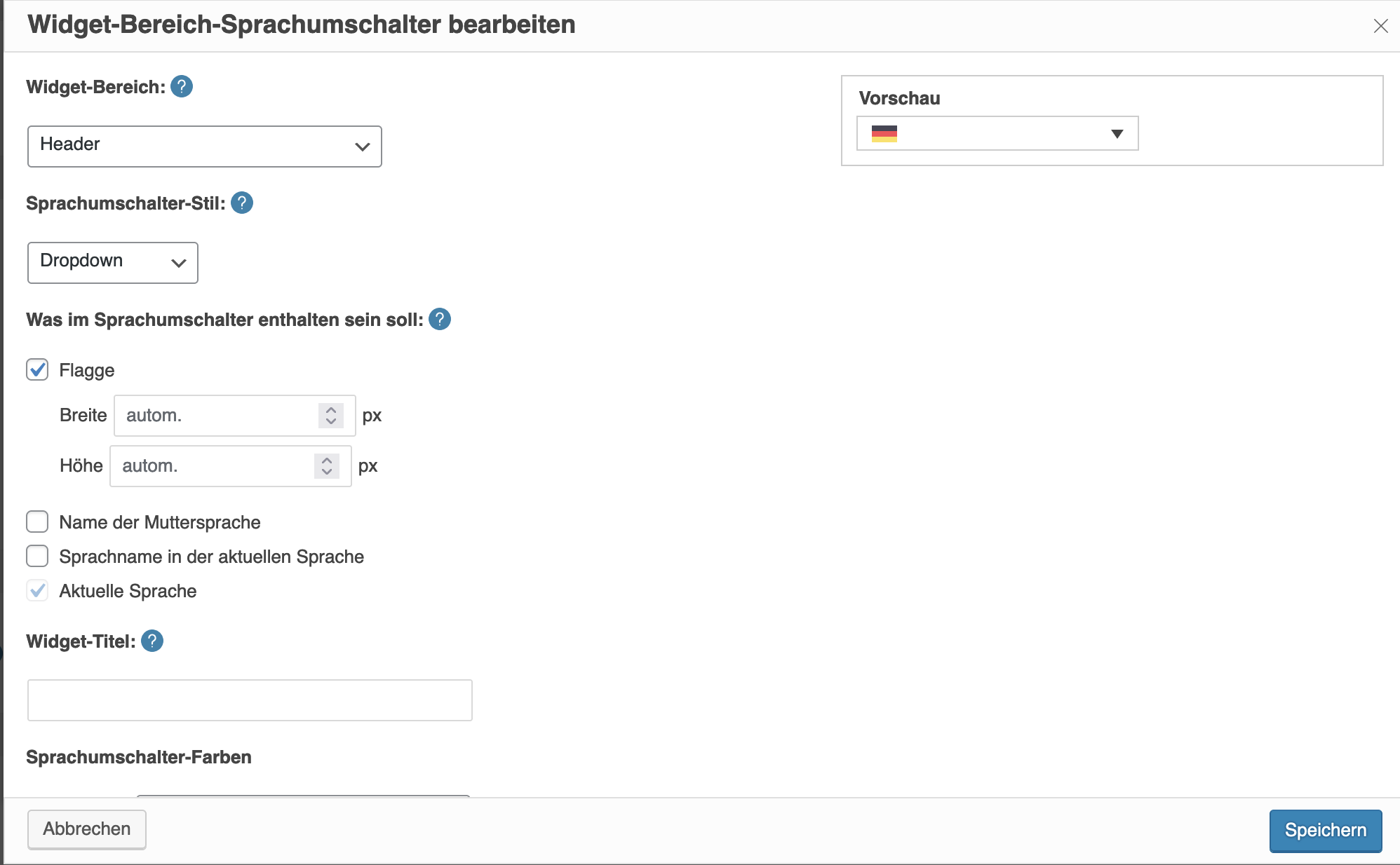

another problem is: I cannot choose the language dropdown function although I set it in WPML as you can see in the screenshot. The flags are displayed either all next to each other or all at the same time, but not as a dropdown.
regrads,
Samy

Since you've mentioned that the English version of homepage is still showing the button and footer untranslated, I checked as per your instructions(private browser) and found that the English translation of the Button and Footer is showing perfectly. Please check this screenshot[ hidden link ] for a better understanding.
It appears that a part of the footer ('Kontakt') has not been translated, causing it to remain in German even when other languages are selected. To resolve this, please ensure that the entire footer is translated. After completing the translation, clear the caches of both the website and the browser. Once this is done, the elements should display correctly in English when accessed from an English language.

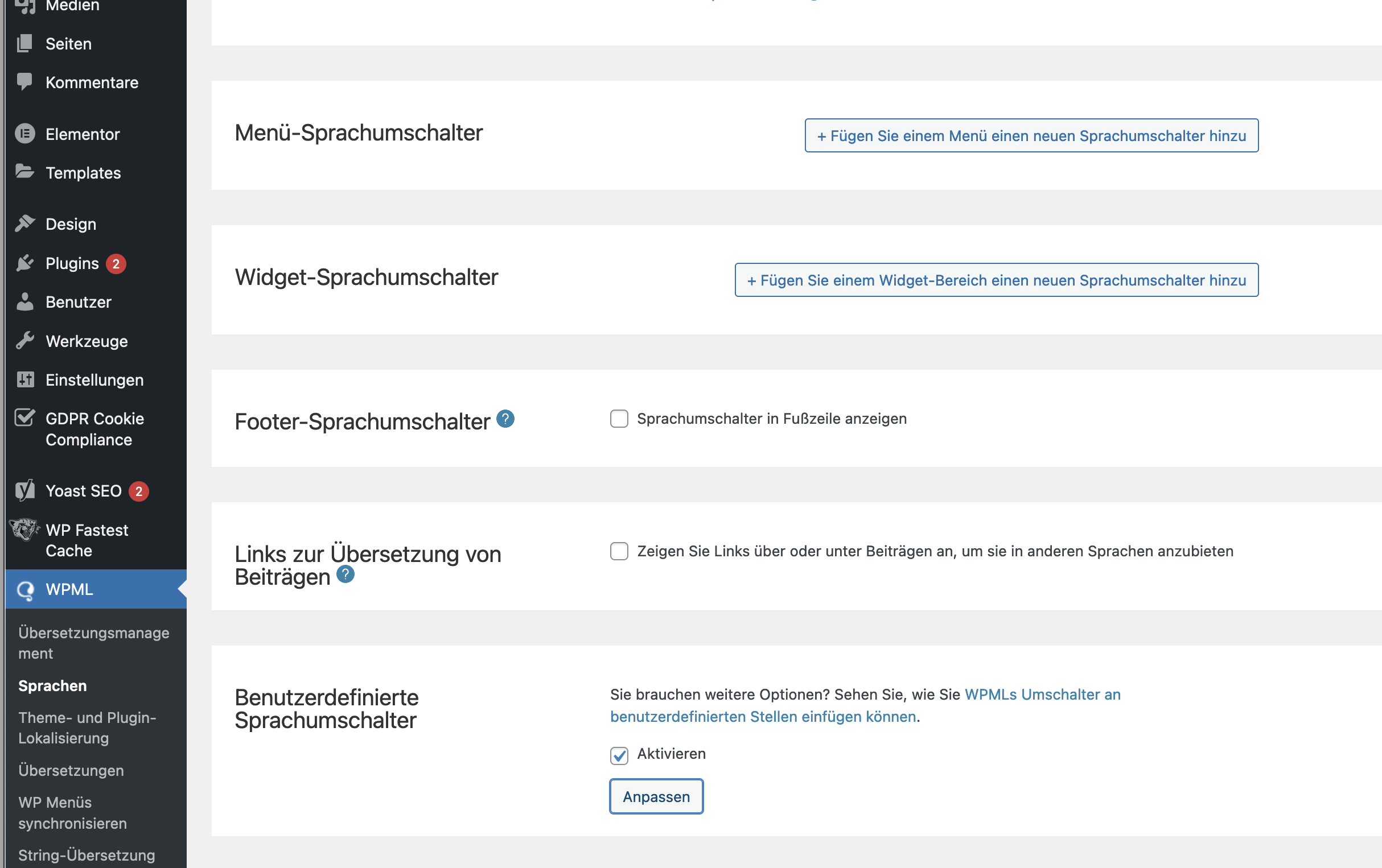

Regarding the issue with the language switcher- From the screenshot, I can see that you've configured the Widget language switcher but on the site, you've used the Astra Language switcher element to display the language switcher. In order to customize it, you need to enable the Custom Language Switcher option available within the Language Setting and make further customization there. Here are the steps to follow.
- Please go to "WPML > Languages" and scroll down to the "Custom Language Switcher"
- Enable the Option and click on the "Customize" button
- Once the customizer loads up, enable Dropdown from there and save the changes.

This, that you have told me, I have done:
"- Please go to "WPML > Languages" and scroll down to the "Custom Language Switcher"
- Once the customizer loads up, enable Dropdown from there and save the changes."

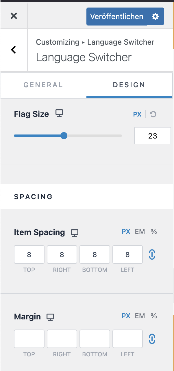

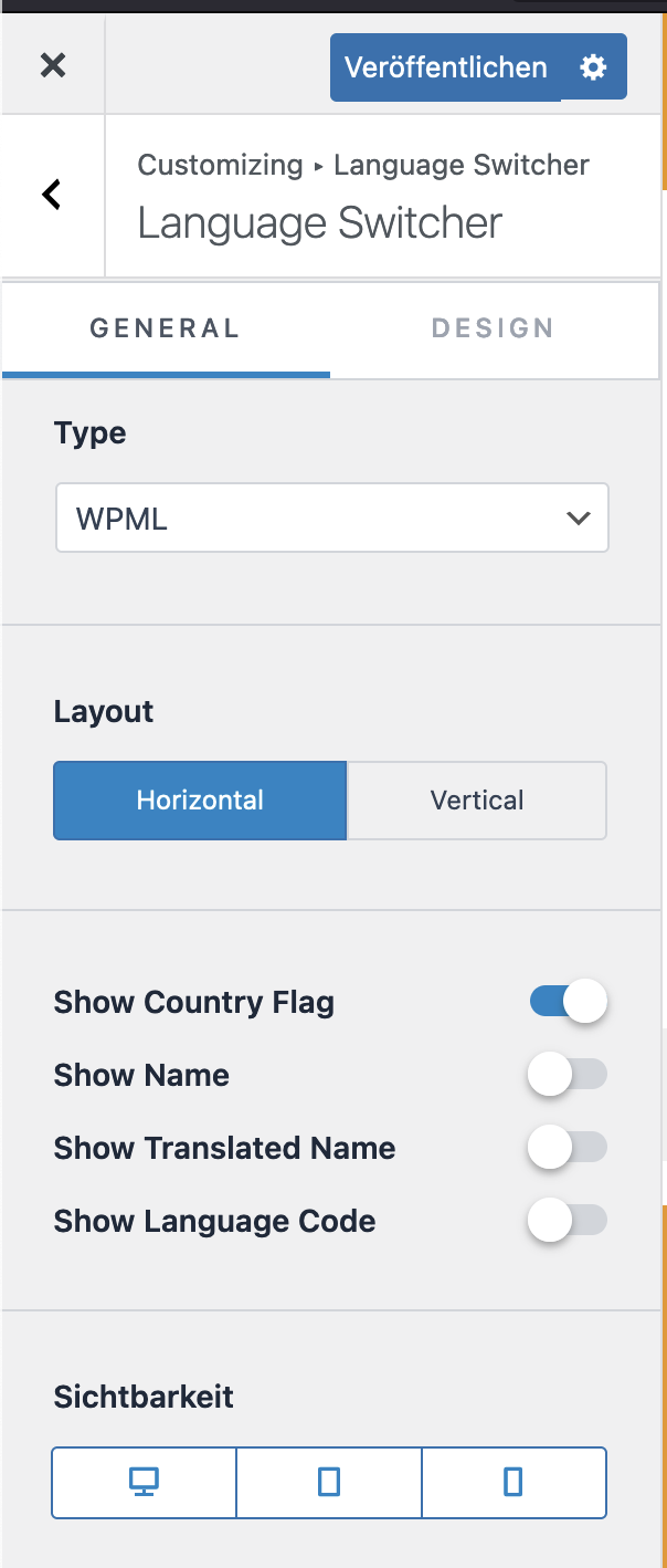

As you can see in the screenshot, I don't have the "Dropdown" option to choose from in the Customizer, neither under "General" nor under "Design". I do not know what I'm doing wrong!
Samy

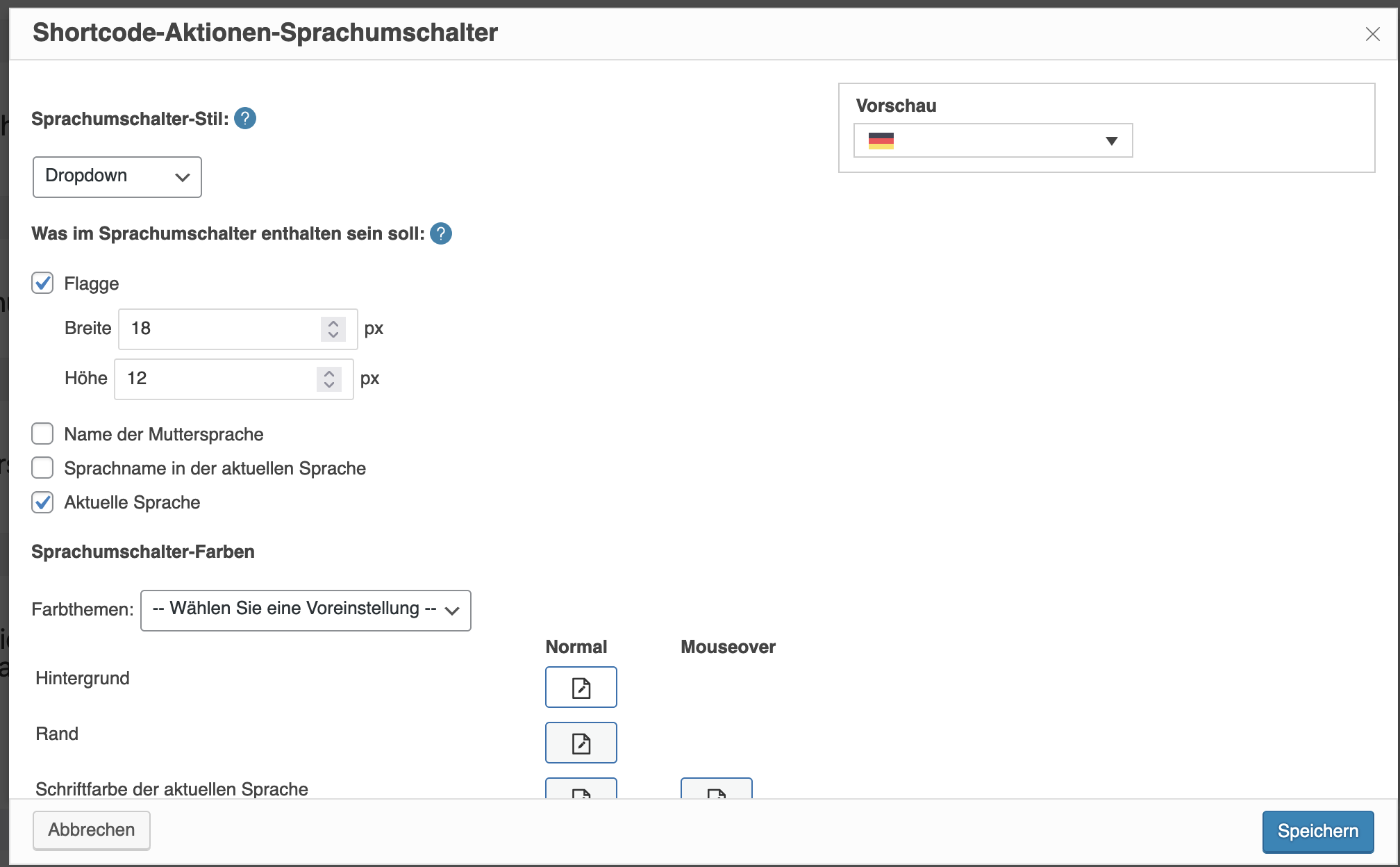

Thank you so much for patiently following the instructions. It appears that the "Language Switcher" module of Astra does not have the support for dropdown, which is why, it is not working as you're expecting. If you want to display the languages in the Dropdown, please consider adding the language switcher using Shortcode and customize it from "WPML > Languages > Custom Language Switcher → Customize". Here are the steps to follow.
- Please copy this Shortcode: [wpml_language_switcher]
- Go to "Appearance > Customizer > Header Builder" and add an HTML element in the Header.
- Paste the Shortcode within the HTML Element and Publish the changes.
- Now go to "WPML > Languages > Custom Language Switcher" and click on the "Customize" button.
- Make the customization for the language switcher as per your needs.
I hope it will help. Please let me know if you need further assistance in this matter. I will be happy to help.

yes, this step works very well! Thank you very much!!!!!
