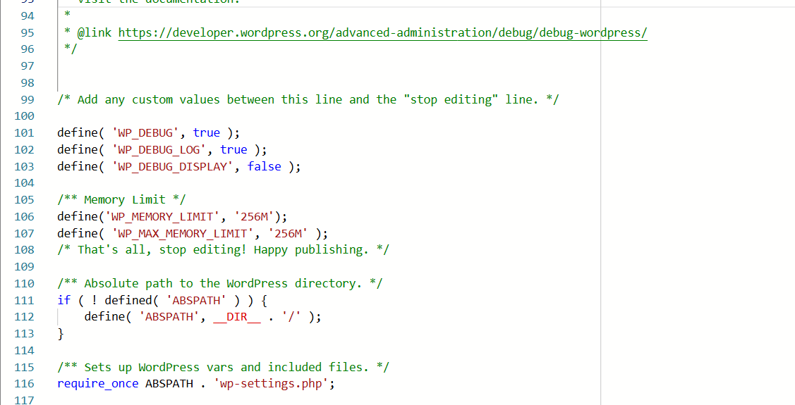

June 6, 2025 at 6:46 am #17112928
Thanks for contacting us. Based on your screenshot, it looks like the debug log is enabled. Please share the debug log file with us so we can review it and identify what’s going on.

June 6, 2025 at 5:13 pm #17114722
Thanks for your reply. I've downloaded a new debug.log using the file manager plugin since the FTP access is still not working for me. I will escalate this further to our 2nd Tier Support for further investigation.
In the meantime, you can share the attached screenshot along with the error logs below with your hosting provider. You can tell them that this error 500 is being generated and regarding the parse error, WPML support will check this on their end. In the meantime, try updating the server's PHP version to 8.X and see if it helps, as it could be related to the error log below.
[06-Jun-2025 17:08:10 UTC] PHP Parse error:  syntax error, unexpected '-', expecting :: (T_PAAMAYIM_NEKUDOTAYIM) in /home/kilimpoi/domains/kilimpoint.com/public_html/wp-content/plugins/sitepress-multilingual-cms/vendor/wpml/wpml/src/Infrastructure/WordPress/Component/Item/Application/Query/SearchQuery/QueryBuilder/ManyLanguagesStrategy/SearchQueryBuilder.php on line 90
[06-Jun-2025 17:08:11 UTC] PHP Parse error:  syntax error, unexpected '-', expecting :: (T_PAAMAYIM_NEKUDOTAYIM) in /home/kilimpoi/domains/kilimpoint.com/public_html/wp-content/plugins/sitepress-multilingual-cms/vendor/wpml/wpml/src/Infrastructure/WordPress/Component/Item/Application/Query/SearchQuery/QueryBuilder/ManyLanguagesStrategy/SearchQueryBuilder.php on line 90
