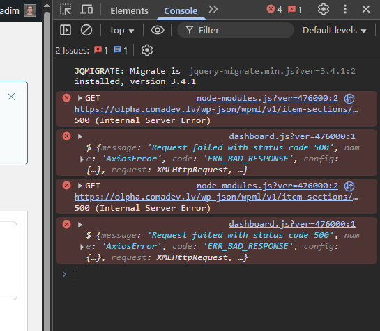

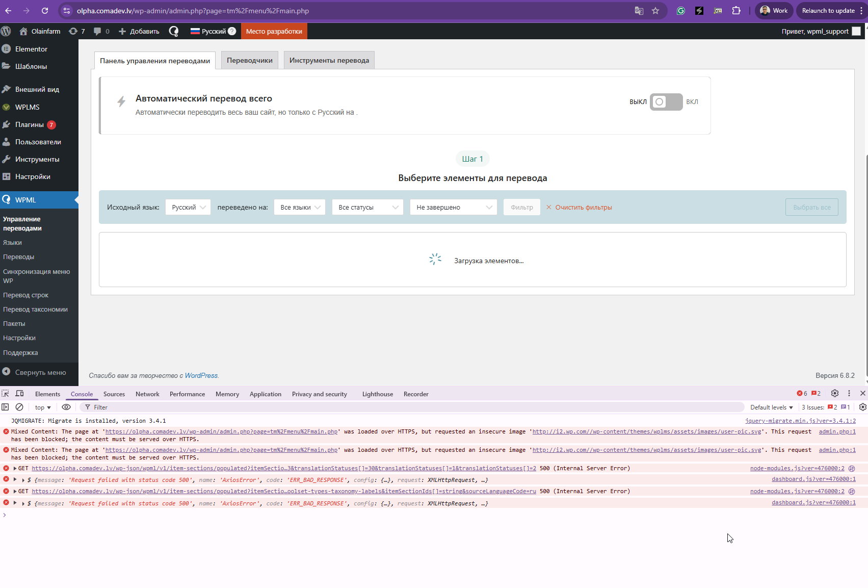

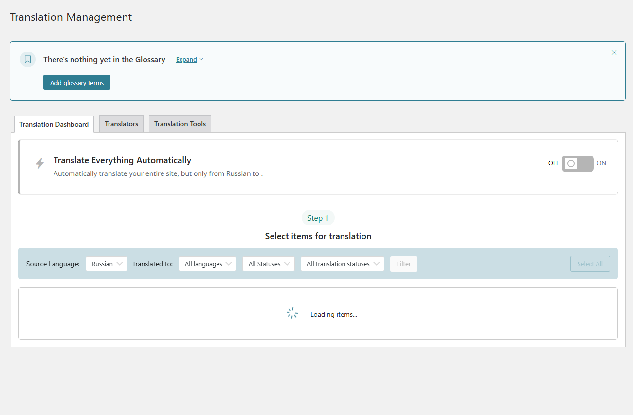

I am trying to open and use translation management in WPML. You can see the issue at this link: hidden link.
I am experiencing an infinite loading issue with translation management, and there are console errors.
Why is translation management stuck in an infinite loading state?
What are the console errors causing this issue?

Copy-pasting the two objects from the console errors I attached in the screenshot. Looks like they're the same, but adding both just in case:
"message": "Request failed with status code 500",
"name": "AxiosError",
"stack": "AxiosError: Request failed with status code 500\n at xe (hidden link)\n at XMLHttpRequest.c (hidden link)\n at et.request (hidden link)",
"config": {
"transitional": {
"silentJSONParsing": true,
"forcedJSONParsing": true,
"clarifyTimeoutError": false
"adapter": [
"xhr",
"http",
"fetch"
"transformRequest": [
null
"transformResponse": [
null
"timeout": 0,
"xsrfCookieName": "XSRF-TOKEN",
"xsrfHeaderName": "X-XSRF-TOKEN",
"maxContentLength": -1,
"maxBodyLength": -1,
"env": {},
"headers": {
"Accept": "application/json, text/plain, */*",
"X-WP-Nonce": "782d0f6039"
"params": {
"itemSectionIds": [
"post/post",
"post/page",
"post/wp_block",
"post/wp_template",
"post/wp_template_part",
"post/wp_navigation",
"post/speaker",
"post/docbase",
"stringPackage/acf-field-group",
"stringPackage/toolset-types-taxonomy-labels",
"string"
"sourceLanguageCode": "ru",
"targetLanguageCode": null
"method": "get",
"url": "hidden link"
"code": "ERR_BAD_RESPONSE",
"status": 500
"config": {
"transitional": {
"adapter": [
"xhr",
"http",
"fetch"
null
null
"timeout": 0,
"env": {},
"headers": {
"params": {
"itemSectionIds": [
"post/post",
"post/page",
"post/wp_block",
"post/wp_template",
"post/speaker",
"post/docbase",
"string"
"method": "get",
"status": 500

Thanks for your reply. This appears to be a server-related issue, as shown in the screenshot. I've already deactivated all plugins and switched to a default theme, and there are no PHP errors in the debug logs. hidden link
Please share the screenshot with your hosting provider and ask them to review the server logs for any related issues.
July 31, 2025 at 8:50 pm #17286677
vadimP
Hi!
Here's the response from our server-side dev on the matter:
There is no errors 500 on server logs (apache, nginx, php)
It seems to be a problem inside WordPress related to WPML (Multilingual Plugin). Some AJAX request is sent without specifying the target language code, which leads to a fatal error on the server.
response: Object { data: "The request data for GetPopulatedItemSections is not valid.Target language codes cannot be empty", status: 500, statusText: "", … }
Are you sure there's nothing you can do to help? It would bad idea for us to start editing plugin files ourselves, for obvious reasons

Thanks for your patience. One of the secondary languages was missing from your Website, so I’ve added English back and the issue is now resolved. Could you please check?
August 8, 2025 at 10:37 am #17305088
vadimP
Hi! 🙂 Yes thank you, it's much better now.
