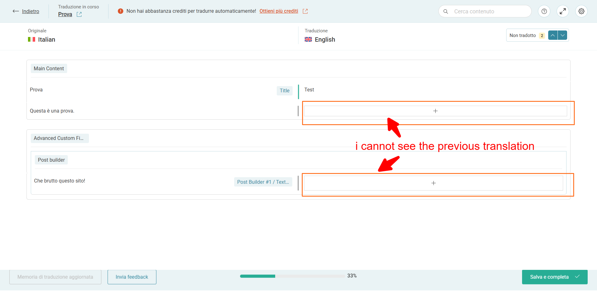

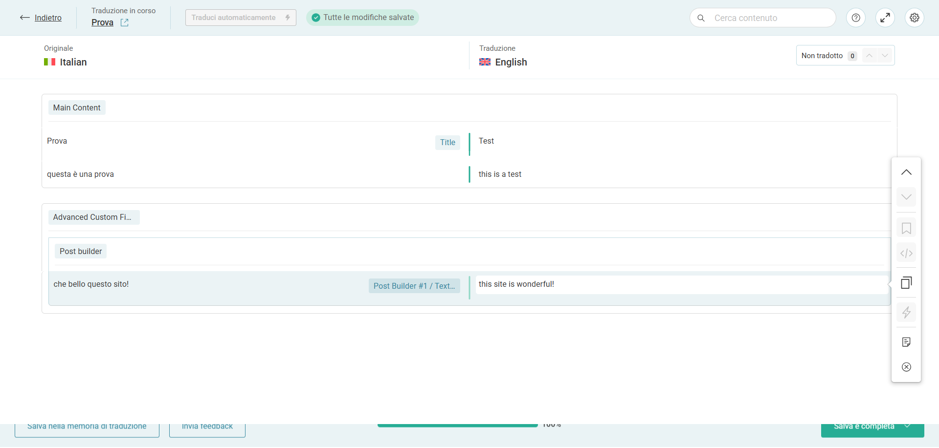

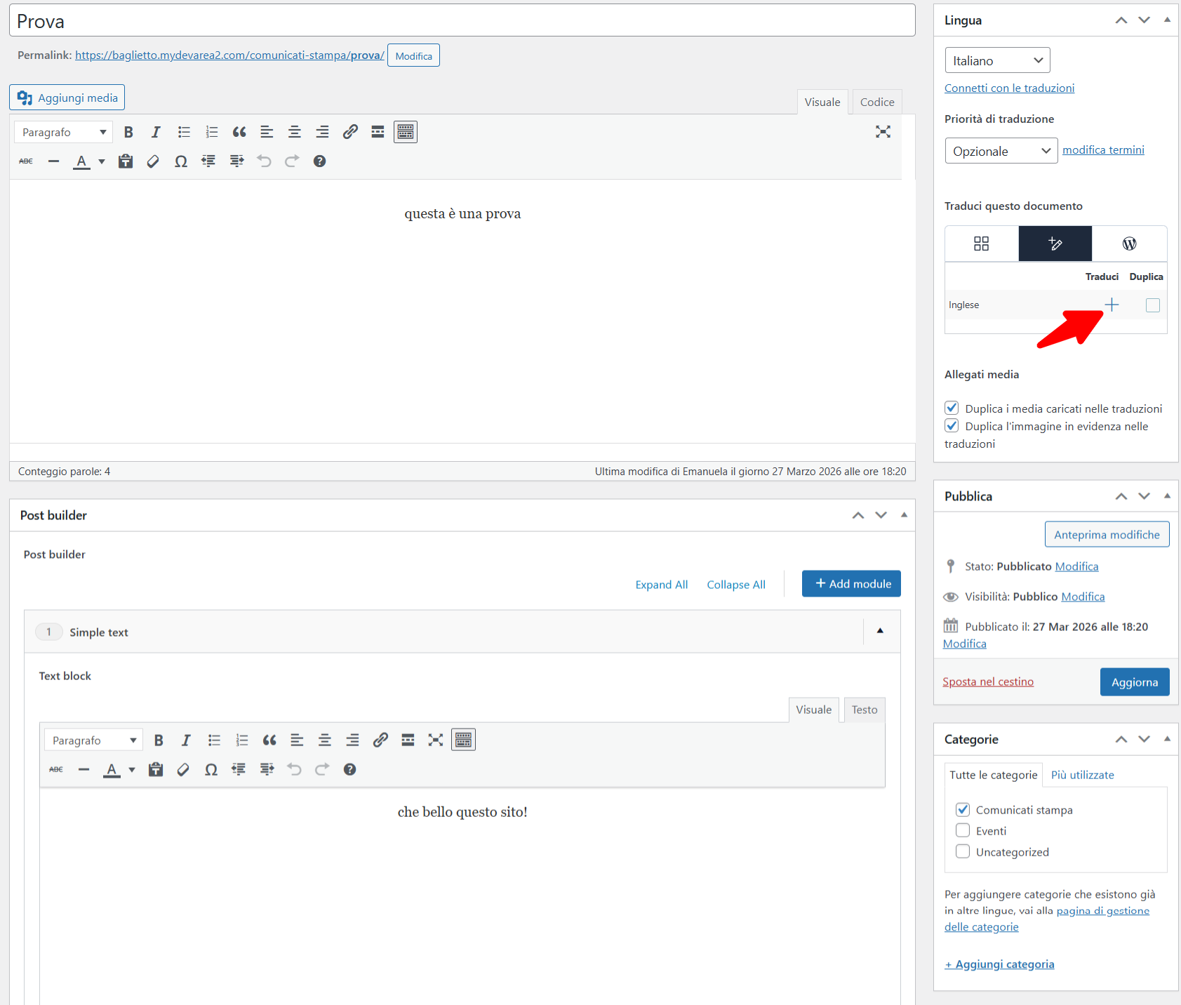

Let's have a look at the procedure for creating contents on the site:
1) I create a brand new post in Italian with the_content() and some custom sections with ACF (repeater with WYSIWYG editor, text or textarea fields inside)
2) I create the English version of the post with ATE, the_title(), the_content() and my custom fields are filled
3) both posts are ok

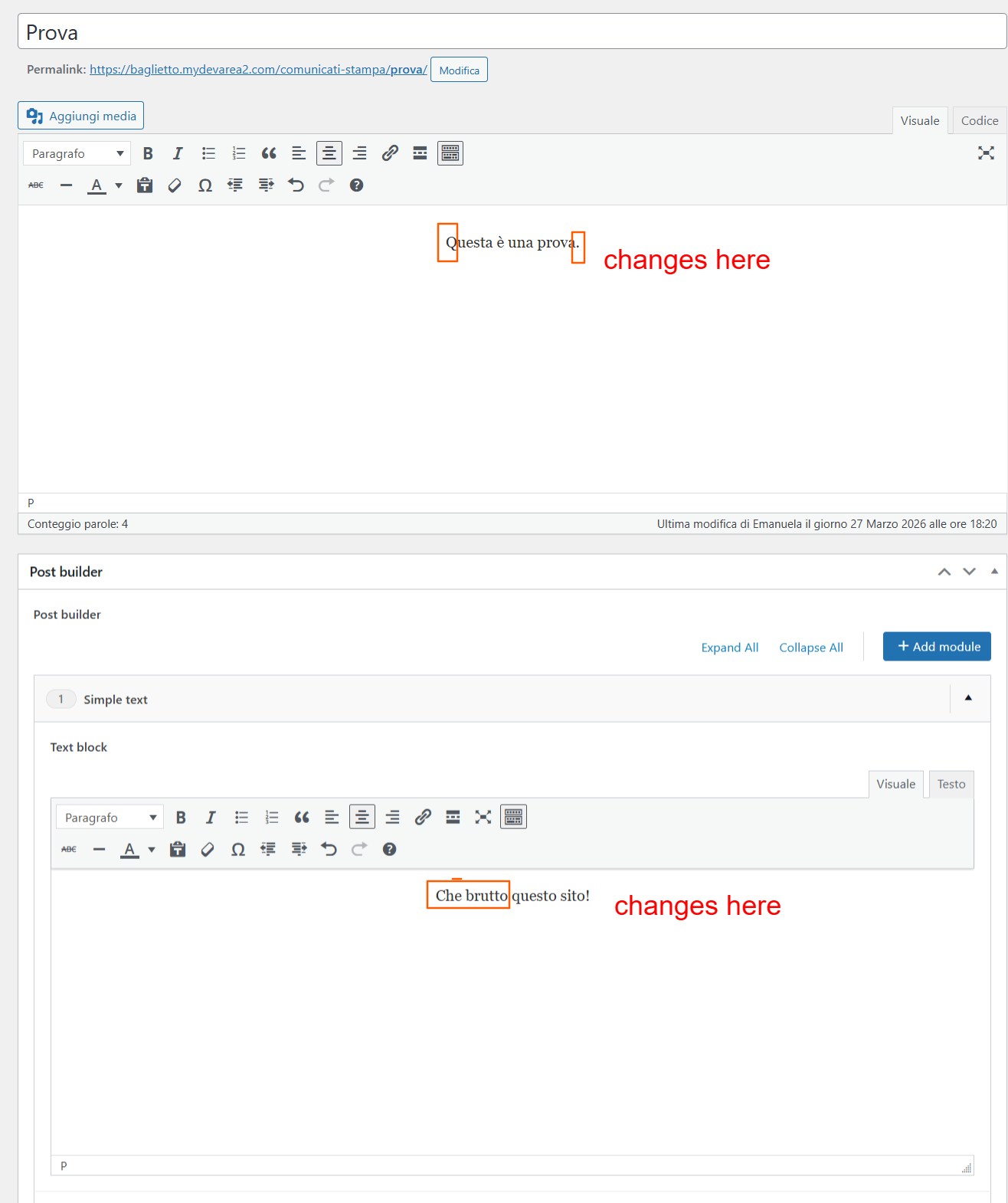

4) I edit the italian version of the post: I change title, the_content() and some custom fields (also little changes for example just a comma or a small part of the text)
5) I open ATE to update my translations and in the right column I dont' see the previous English texts but empty fileds. For all fields I changed in the italian version the corresponding English fields are gone in ATE

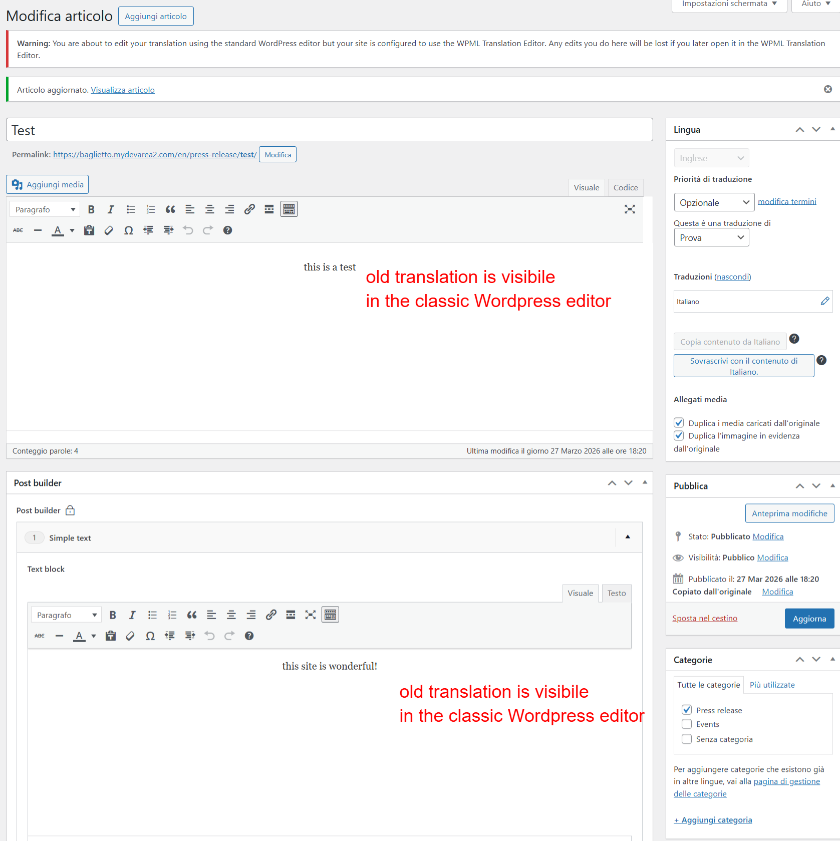

6) if I switch to the standard WordPress editor in English, the previous translations are there, I cannot see them in ATE!
I attached some screenshots with all these steps.
