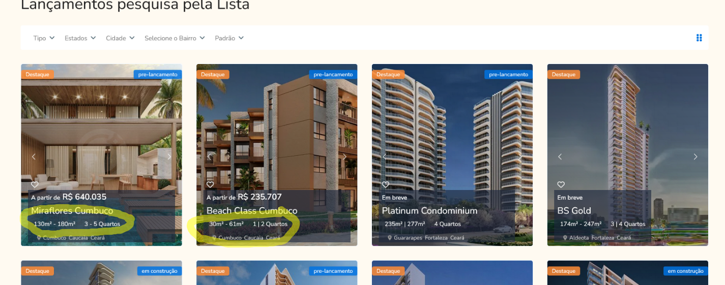

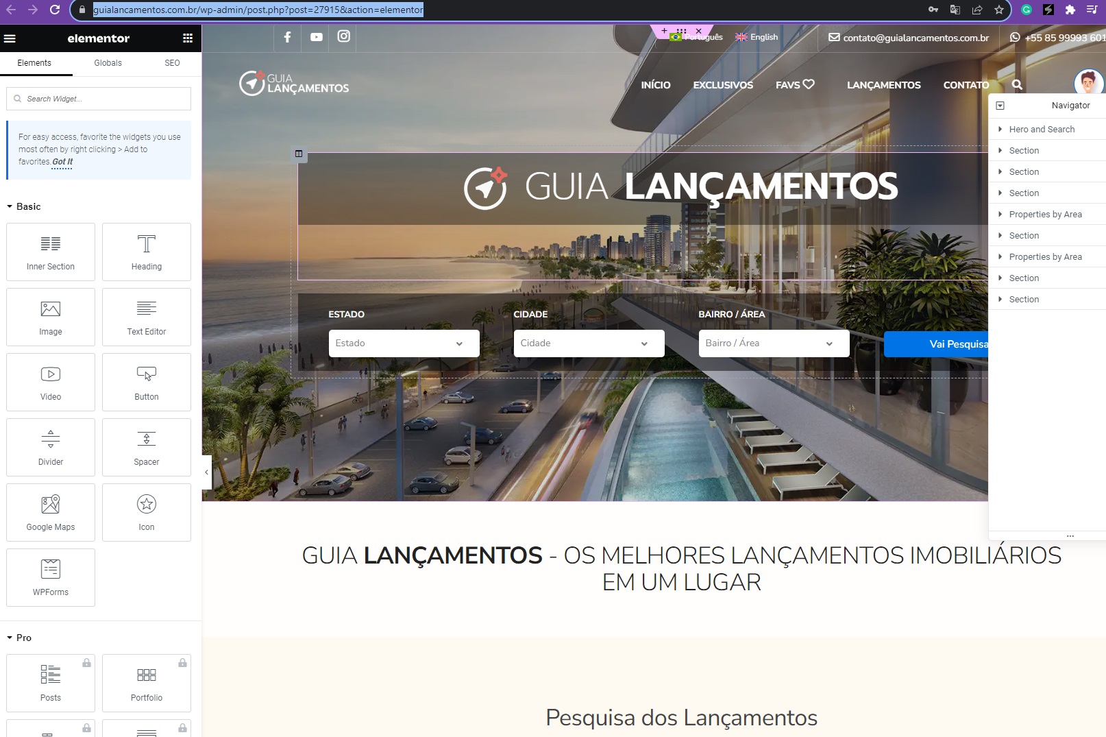

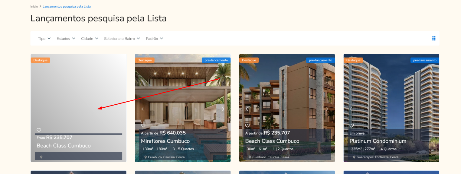

November 3, 2023 at 2:13 pm #14726355
thomasL-104

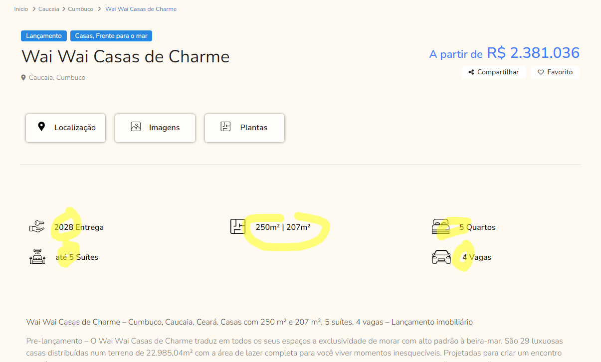

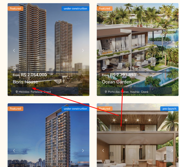

Yes, now it open the elementor, but on some sites don´t get copy things , I will attach images,
also like you can see some graphics arent working proper

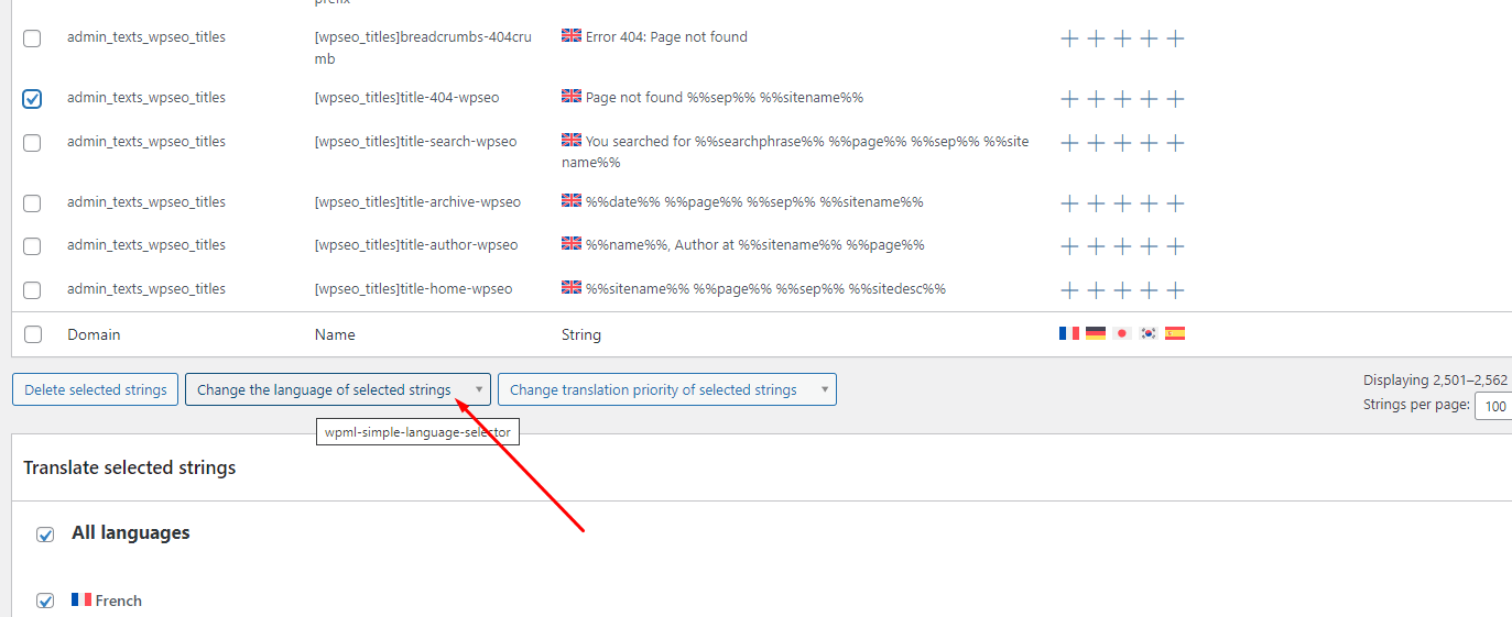

Thanks for your reply.
You can change the string language as shown in this screenshot. You just need to select the string and "change the language of the string" using the option shown in the attached screenshot. Could you give this a try?
November 3, 2023 at 4:42 pm #14727401
thomasL-104
yes , I tried. You know, I have already 3 other portals ALSO with wpresidence, I made them in english as main language and afterwards I translated them in portugues..was working seamless. now occuring more problems, as I was translating the english theme with a third party plugin in portugues (don´t know how much was mixing this up) and now back to english.
Even english translated porperties find their way to the portugues list of properties.. its all not working 100%.

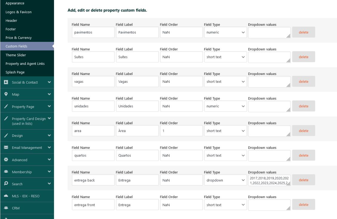

November 6, 2023 at 4:53 pm #14740275
thomasL-104
This image is nothing about graphic, its about a value which don´t get transmitted, it´s a simple custom php, but it´s a custom whats included in wpresidence..
it´s just named different with another value, but don´t get forwarded to the english part.
I can´t find the string with wpml which I created.. area and quartos
Should I get in touch with wpresidence?
The part which is seperated with /* */ is the original and there it works.

November 14, 2023 at 1:18 pm #14798061
thomasL-104
ok, I check with the theme autors, but they ended up with, thats the problem of WPML. So I use the custom fields from the normal theme, see screenshots, and not one get translanted/forwarded/copied.
That is the issue

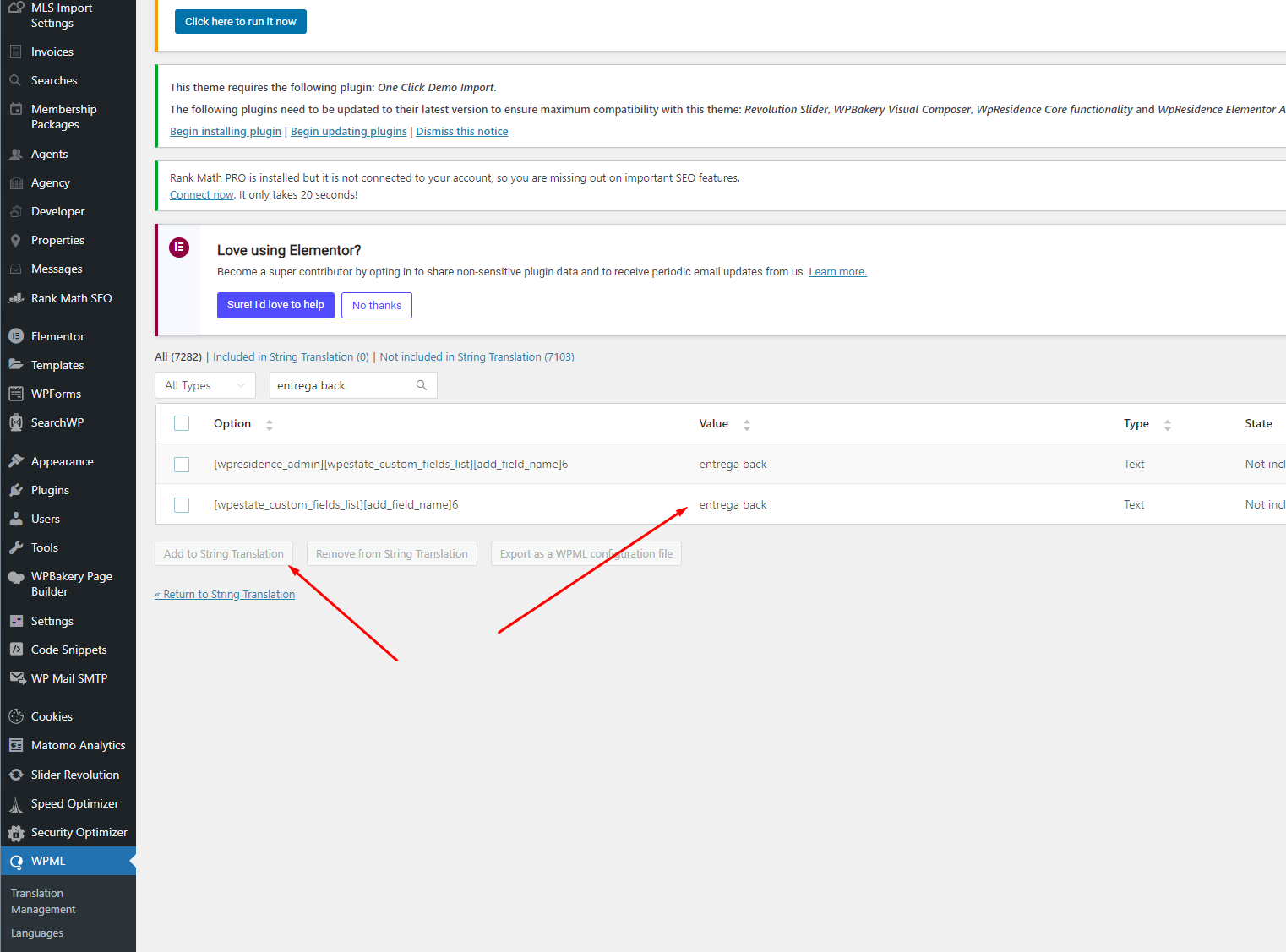

I understand what's going on now. To translate the theme options, you need to search here hidden link and add it to the string translations as shown in the attached screenshot.
Once it's added to the string translation, you can then translate it to another language.
November 14, 2023 at 4:12 pm #14800629
thomasL-104
Hi Kor, I followed your explanation, but still the values of the custom fields don´t get delivered in the english language
