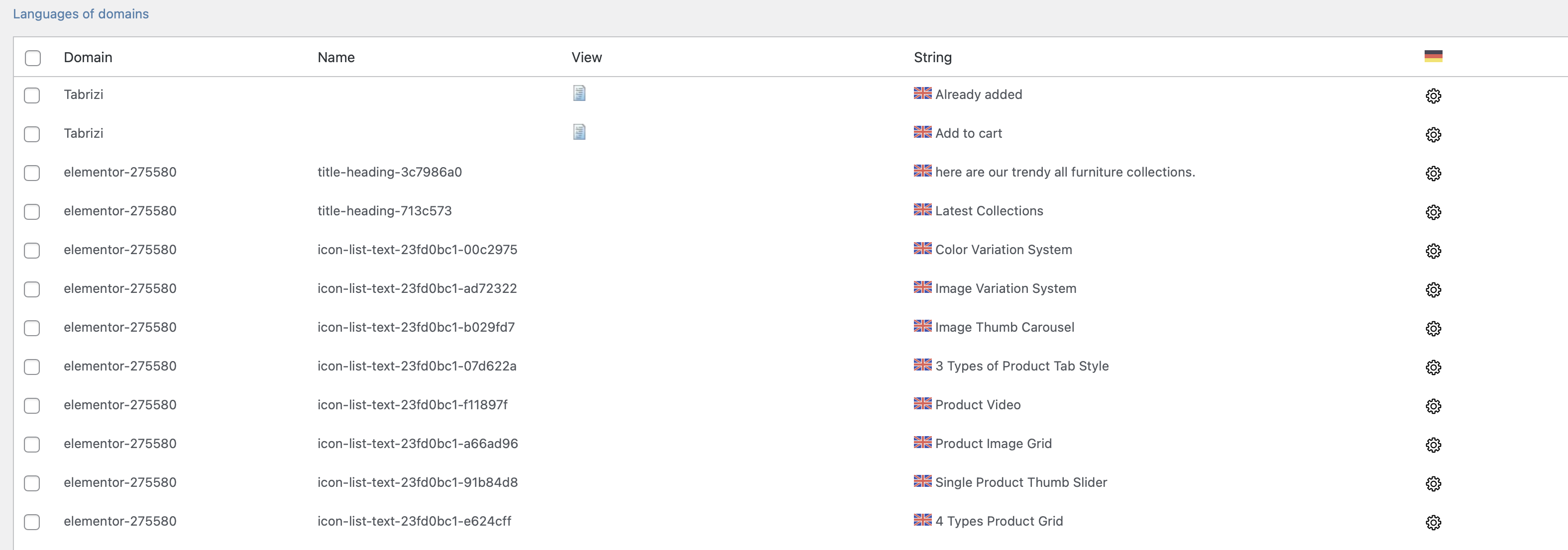

October 24, 2024 at 7:22 pm #16328236
ebrahimG
I just scanned my plugin and template folder and selected strings to translate into German using WPML. I have a memory limit of 2048 MB.
The translation process has been stuck on 'Translation in progress!' since yesterday.
How can I stop the translation process?

October 24, 2024 at 8:11 pm #16328399
ebrahimG
Yes, I refreshed my page multiple times, but it is still stuck. 🙁 Here is the debug information.

October 27, 2024 at 10:15 pm #16335550
ebrahimG
Thank you very much for your response! I just updated the entire plugin, but it still didn’t work. I don’t see any "Job" menu under WPML → Translation Management or WPML → Jobs, so I’m unsure how to cancel the jobs. I can’t modify them manually either, as only a gear icon appears, and I can't take any actions.
Is there a way to cancel everything? Do you need access to take a look yourself?
Thanks again, and have a lovely day!
