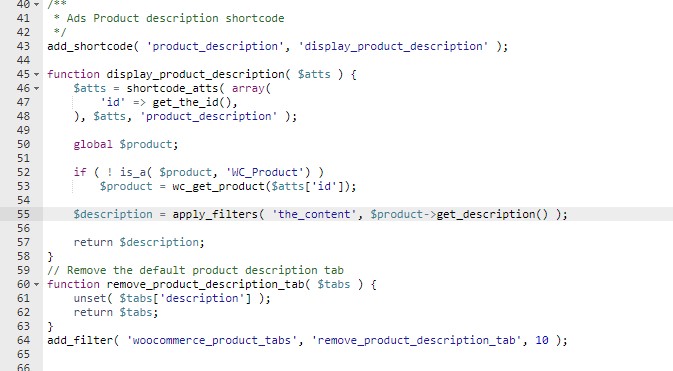

This is how this line looks like in functions.php
this piece of code is supposed to create a shortcode for "Product description" as i wanted to move it outside of the Product Tabs
January 29, 2024 at 10:37 am #15237378
WPML Supporter since 08/2022
Thanks for your reply.
Could you please confirm that if the code is removed, the Advanced Translation Editor works fine?
January 29, 2024 at 10:40 am #15237397
jakubP-13
I didn't remove the code. But everything seems to be working fine. So i will leave it like this for now. We will investigate the php code further with the theme support.
