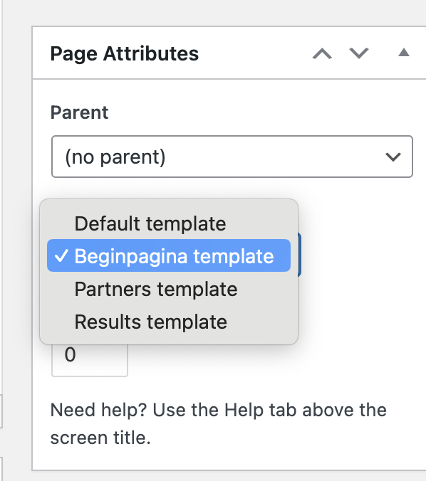

That is not the case, I checked it with support from the chat. But i looks like it has something the do with the template setup. Where should I make changes? We I choose for default, the images show in translation, but when one "Beginpagina template" it doenst show any translation perhaps text of one field
