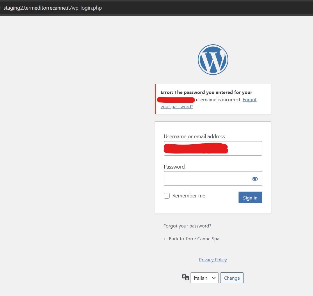

Thank you for the updates. But unfortunately password isn't working for the provided user (see attached).
I've enabled your next reply again as private to provide the updated access to the staging/test site.
P.S.: If you don't see the section for providing access information, do not write in the message box or the information may appear as public.
