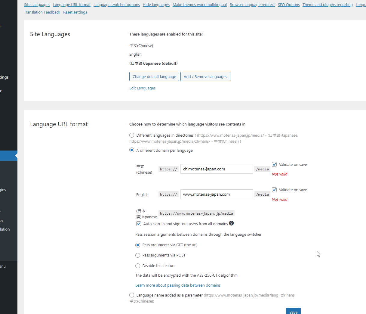

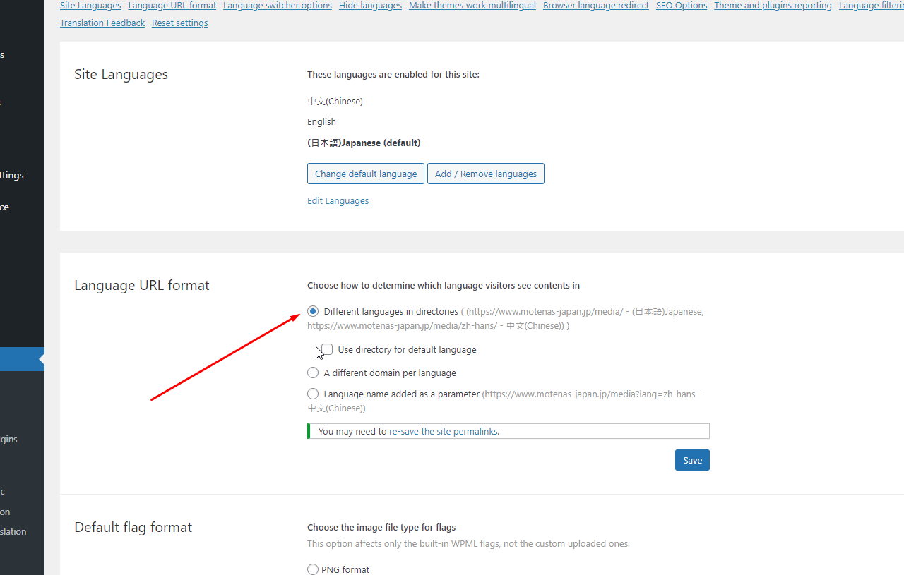

June 6, 2024 at 8:38 pm #15713259
Thank you for responding.
Upon reviewing, I found that when I changed the "Language URL format" to "Different languages in directories," the link hidden link started working.
It seems that the domains are not validated, as indicated in the screenshot attached. Could you please verify with your domain provider? You'll need to ask them to direct the domain hidden link to the server IP.

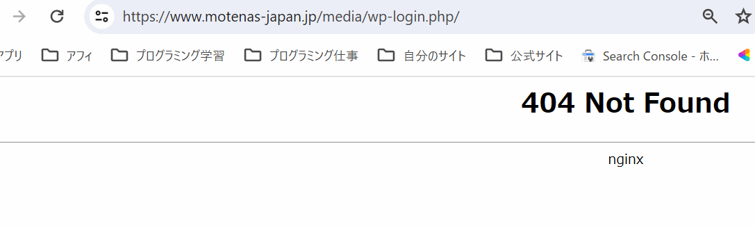

June 7, 2024 at 10:54 am #15715092
毅 青木
Thank you.
Did you change any settings or set up any plugins?
When I try to log in at hidden link, I get redirected to hidden link and a 404.
Therefore, I could not log in and check. We have had a similar event before after wpml confirmed it.

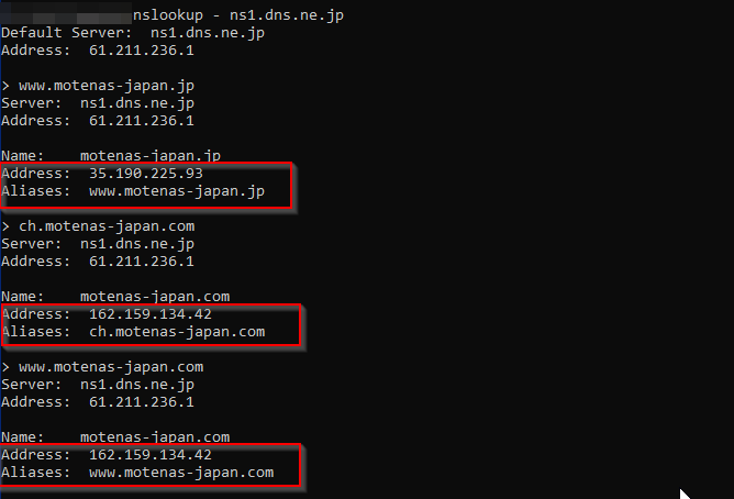

June 11, 2024 at 6:54 am #15724671
Our secondary support team investigated and here's what they discovered: The domain hidden link has a different server IP address according to the NS host NS1.DNS.NE.JP, as indicated in the attached screenshot.
To ensure synchronization of language, it's essential that all domains share the same server IP address. Could you kindly double-check with your hosting/domain provider?
