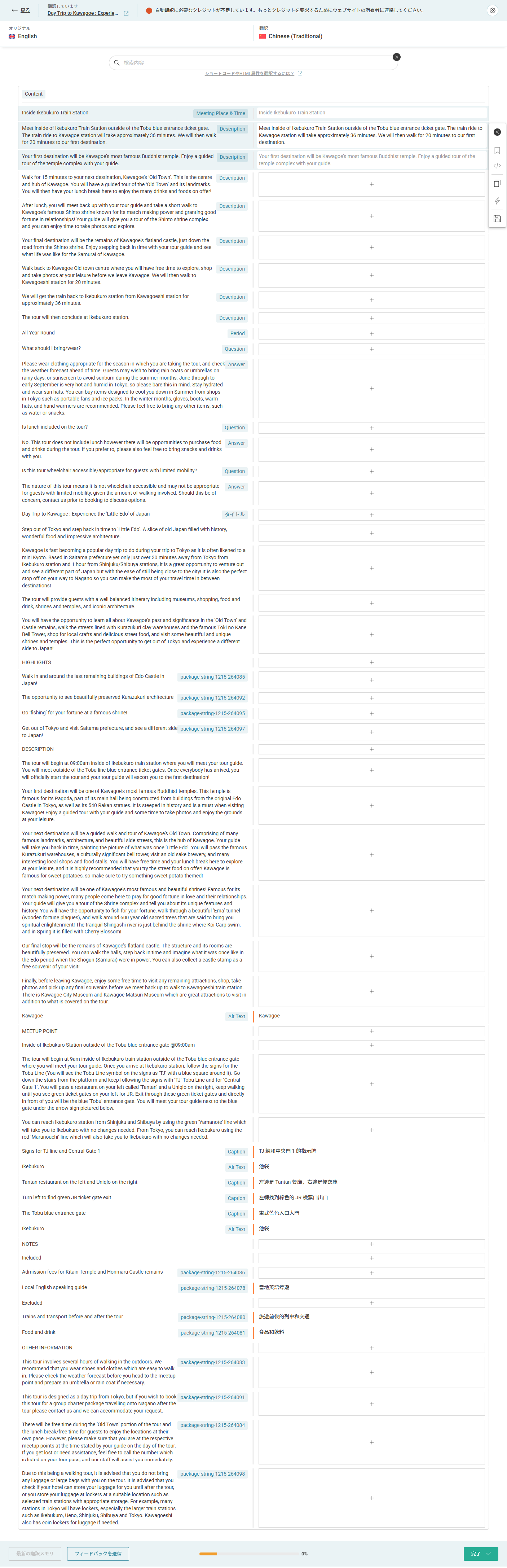

February 7, 2025 at 7:15 am #16678006
takahiroK-2
Is there a tutorial for migrating to the Advanced Translation Editor?
When I just switch the editor, the translation completion percentage decreases from 78% to less than 20%, as shown in the attached images.
I don't know how to build the translation memory from our current translation saved for the standard Translation Editor, either.
Thank you for your support.
