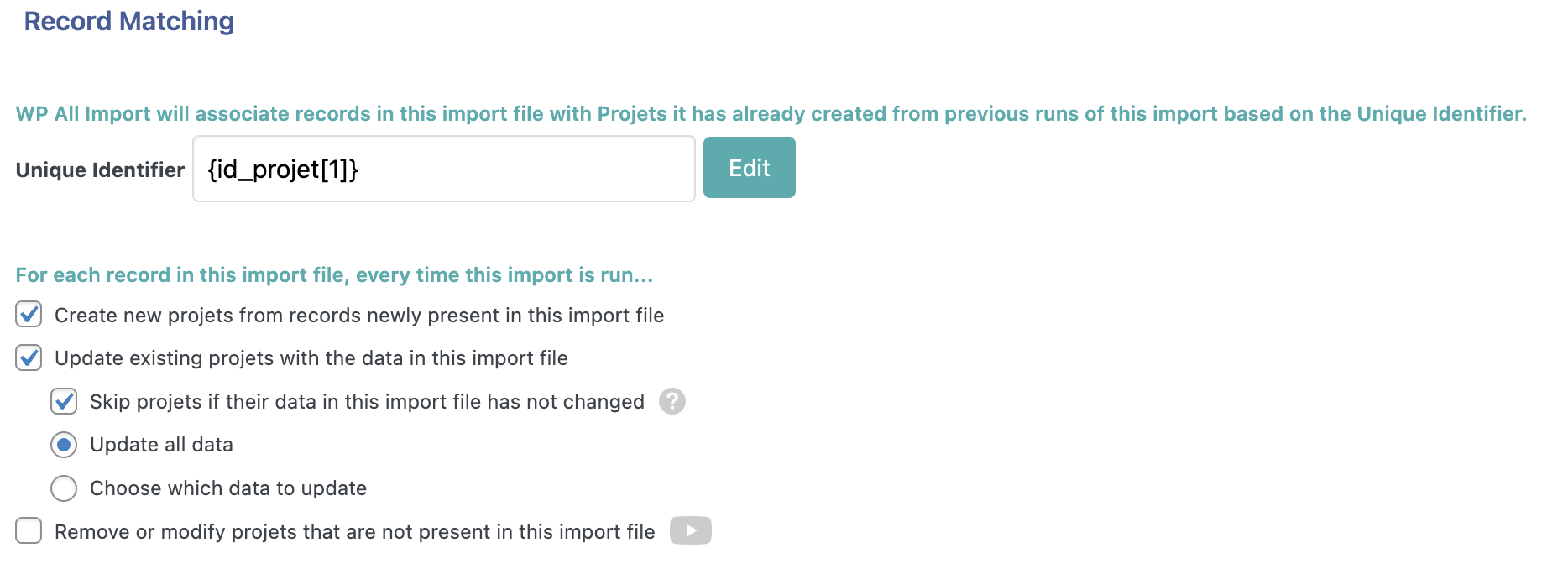

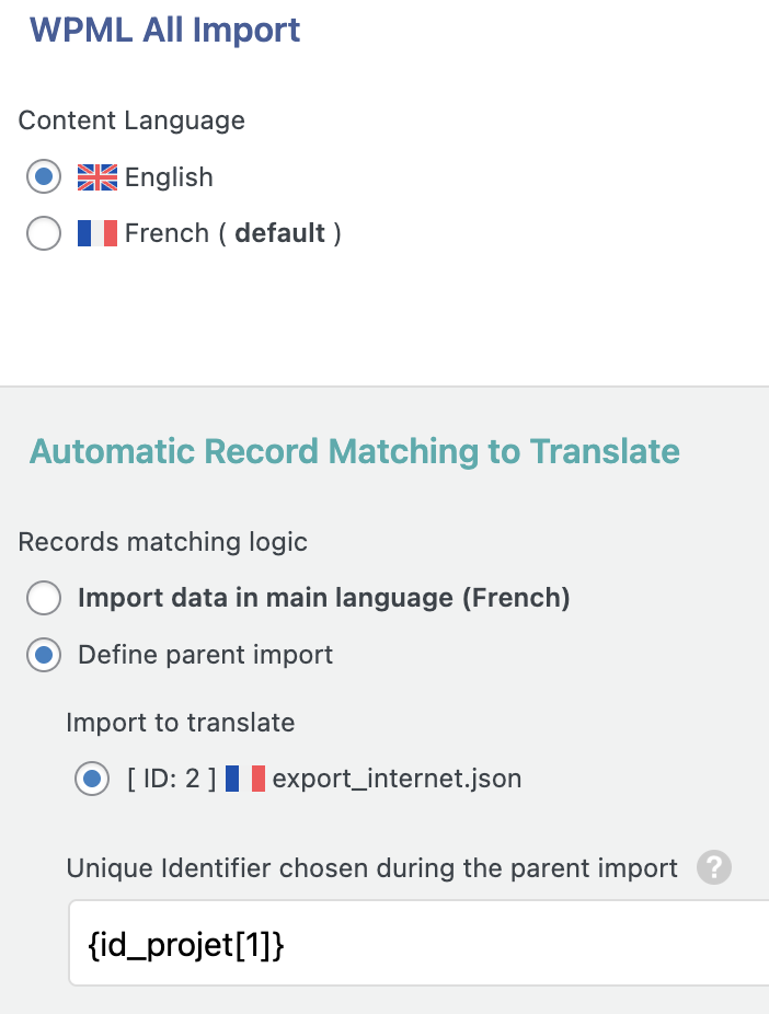

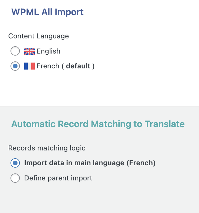

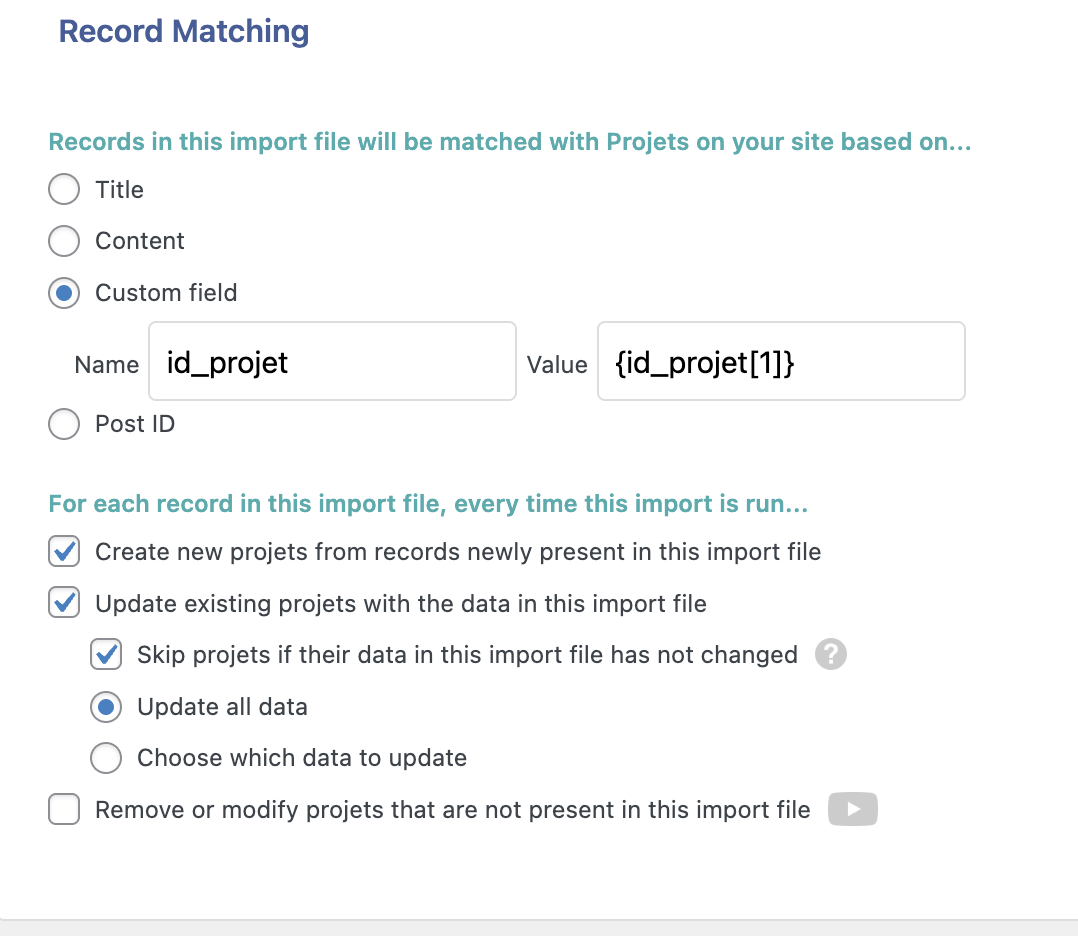

I am trying to import translated custom post types using WP All Import Pro (WPAI) with WPML. I have set up two imports: one for the original language (French) and one for translations (English). The custom field id_projet is used as a unique identifier in both imports. In the English import, the French import is selected as the source, and the matching field is dynamically set as {id_projet[1]}. The ACF multilingual sync options are configured to 'copy', and the option 'Disable do_action calls in wp_insert_post' is unchecked. All involved plugins (WPAI, WPML, ACFML) are up to date. Link to a page where the issue can be seen: [URL not provided].
Only the first item in the translated import is linked properly to its French counterpart. All following English posts are created with correct content but remain unlinked, resulting in orphan translations. No WPML hooks or WordPress post-save hooks are triggered after the first item, preventing the WPML post-creation logic from running.

I added screenshots to my first post. You can see I'm always using "projet_id" to link both posts.
Besides, even if I already debugged it just in case, this value always matches as both imports are from the same file.

2) Sure, I went and clicked New import and selected your JSON file. Then loaded saved template, and saved FR import and run it. Then did same for EN import, just selected inside template that this is EN language and parent Import is FR ID 4. Run it and it worked fine.
