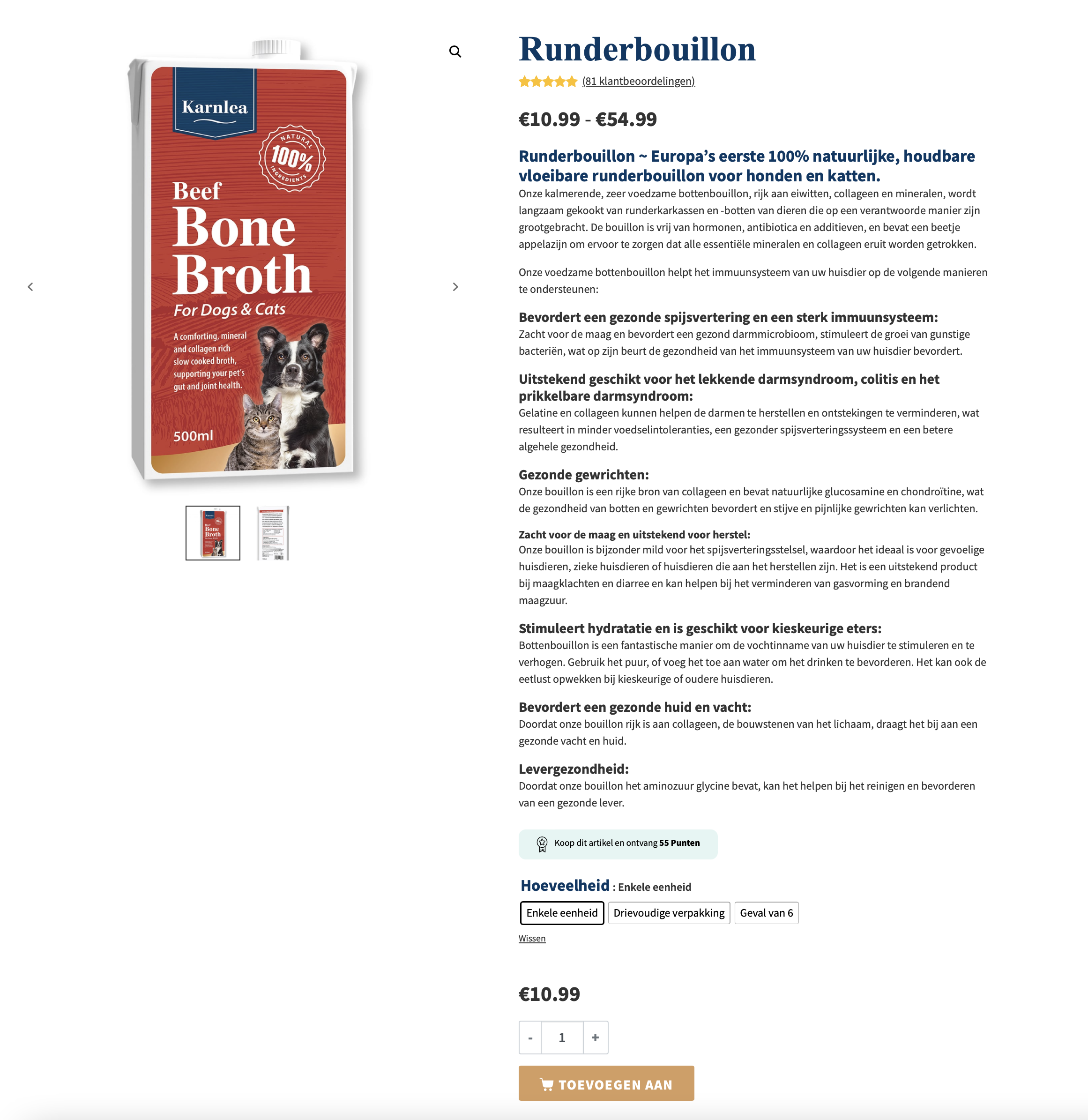

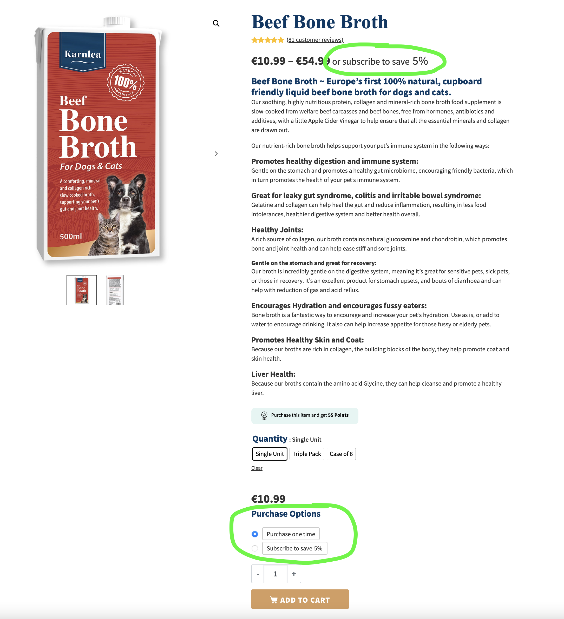

Hello, Ive have successfully translated most of the site from English to Dutch, however I can seem to get the subscription products to show at all on the translated version?
The site is running WooCommerce Subscriptions and All Products for WooCommerce Subscriptions. The Subscription options show up on the english version but not the dutch translated version? Ive attached two screenshots to help show you what I mean.
Am I missing something or doing something wrong?
Really appreciate your help,
thanks - Will

The problem is the translation of at least one string:
"All Products for WooCommerce Subscriptions require at least PHP %1$s. Learn hidden link"
It is translated to:
Voor alle producten in WooCommerce-abonnementen is minimaal PHP %1$s vereist. Leer hidden link .
Using %2%24s inside the translation is invalid and causes an error. Those placeholders need to be identical in all languages.

One string that is causing an error can be found on WPML > String Translation when searching for
%s&#37
You will find two strings. In this case, it is the string with the context "subscribe to save discount."
The string is not wrongly translated, but it throws an error if it is translated.
Fatal error: Uncaught ArgumentCountError: 3 arguments are required, 2 given in /var/www/vhosts/karnlea.eu/httpdocs/dev/wp-content/plugins/woocommerce-all-products-for-subscriptions/includes/product/class-wcs-att-product-prices.php:360
Deleting the translation for this string solves the first error.
Then I run into the next error:
Fatal error: Uncaught ValueError: Unknown format specifier "w" in /var/www/vhosts/karnlea.eu/httpdocs/dev/wp-content/plugins/woocommerce-subscriptions/includes/core/wcs-time-functions.php:33
This refers to a falsely translated string "%s months" which was translated to "% maanden" but should be "%s maanden".
The final string I needed to search and fix was "%1$s every %2$s".
Now, I already fixed various strings earlier for which I do not recall the value, but on the dev site, the translated product is now visible again.
If you would like me to revise this on your production site, please let me know. the private reply form is enabled again.
