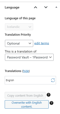

This helped a lot, thank you. I think have all these oddities straightened out. One final question about something I noticed that seems a bit strange but not sure what to make of it.
When looking at all pages, filtered for only english, all entries have a pencil in the language column telling me they have a connected translation and no need to update.
If I switch to filter on icelandic pages, most of them are exactly the same, with one exception. One of the pages has the circuilar arrow thing indicating an update is needed. When I hover over it, it says "update english translation".
I have come across this before, and found that the they were pages that had been origionally created in Icelandic. Once I used your process above to disconnect and reconnect, that fixed it.
However this page does seem to be correctly identified as a translation. See attached screenshot. Why would a translation be saying the origional language needs to be updated?
