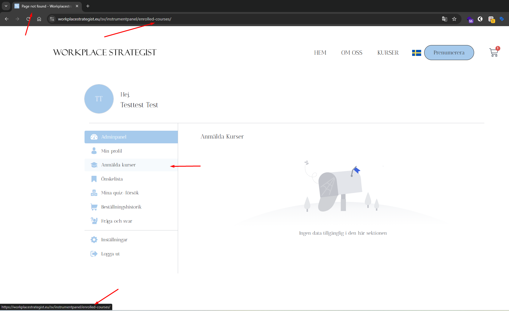

You are using Tutor LMS with WPML for a bilingual English and Swedish site, and you're facing issues with translating dashboard slugs like 'purchase_history', 'my-profile', 'enrolled-courses', etc. into Swedish. The page content loads correctly, but the page title displays 'Page Not Found' in Swedish, while English works fine. Additionally, after updating the Tutor LMS plugins, the sidebar menu in Swedish started working, but clicking the inner tabs redirects to a 404 page.

I am trying to use Tutor LMS with WPML in English and Swedish so that the dashboard slugs (purchase_history, my-profile, enrolled-courses, etc.) are translated into Swedish and show the correct page titles. You can see the issue at hidden link. I expected to see the page title in Swedish corresponding to the dashboard section (e.g., 'Köphistorik' for 'Purchase History') when viewing in Swedish. Login details as a user: email: test123@gmail.com, password: test123@gmail.com.
The page content loads correctly, but the page title says 'Page Not Found' when using the Swedish version. This only happens in Swedish — English works fine. It seems the Tutor LMS endpoint slugs are not translated. I could not find them in WPML → String Translation or Tutor LMS settings.

I checked further and seems the issue is coming from custom code that you added in the parent theme functions.php.
I have deleted theme and re-installed new Hello Elementor theme and it works fine then in SW. Note, we can not support or debug custom code solution, for that would be best to hire or advise further with your developer.
I also see Tutor LMS plugins are older version, so please update to latest.
I have done these testing on local version, not on your staging site.

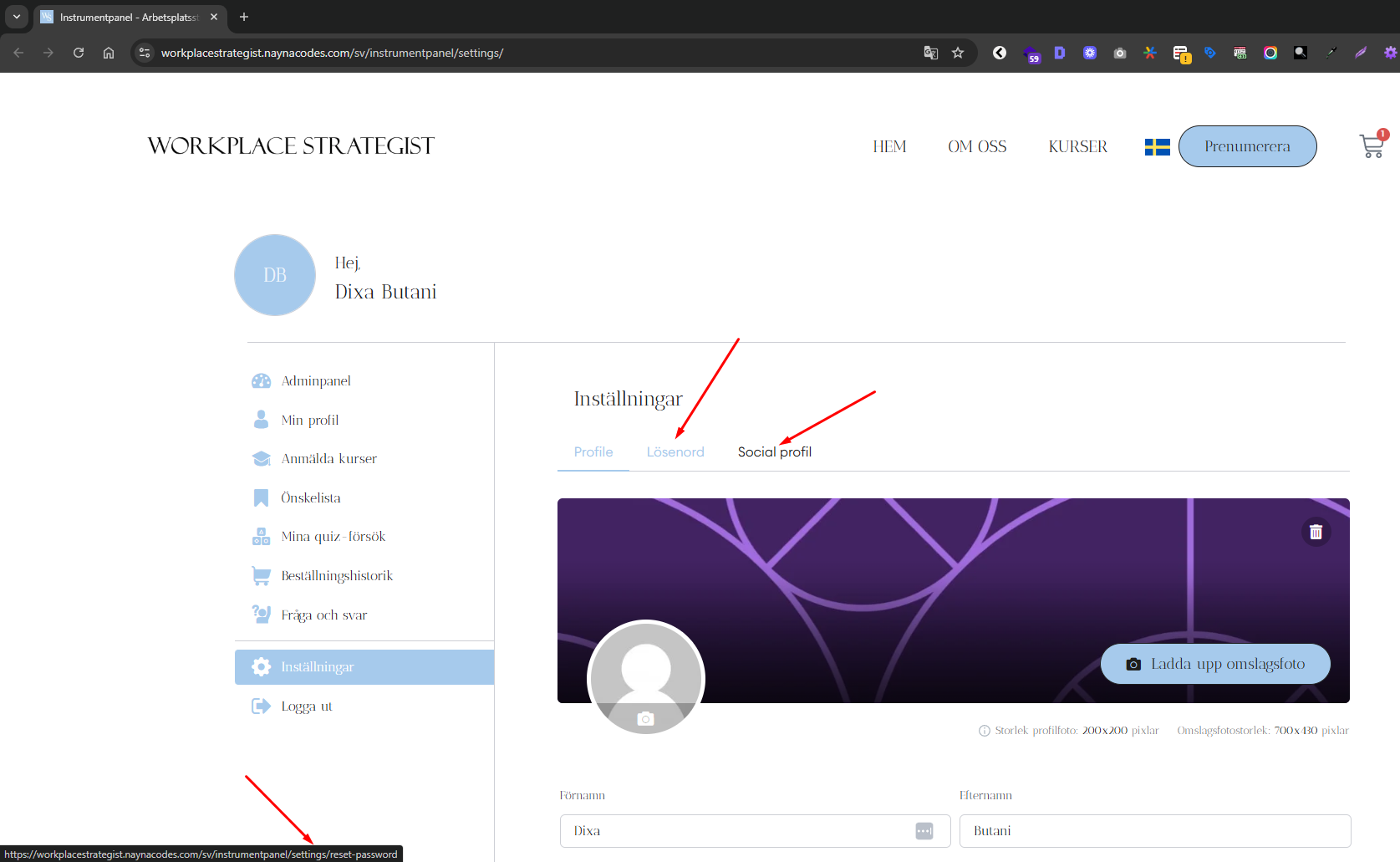

The issue with the sidebar menu in the Swedish version of the user dashboard has been resolved after I updated both Tutor LMS plugins. However, the inner tabs within the menu are still not functioning as expected — clicking them redirects to a 404 page.
I have also checked by commenting out all my custom code, but the issue with the inner tabs remains. The main menus now work after the plugin updates, but do you happen to have any idea what might be causing the inner tab issue?
