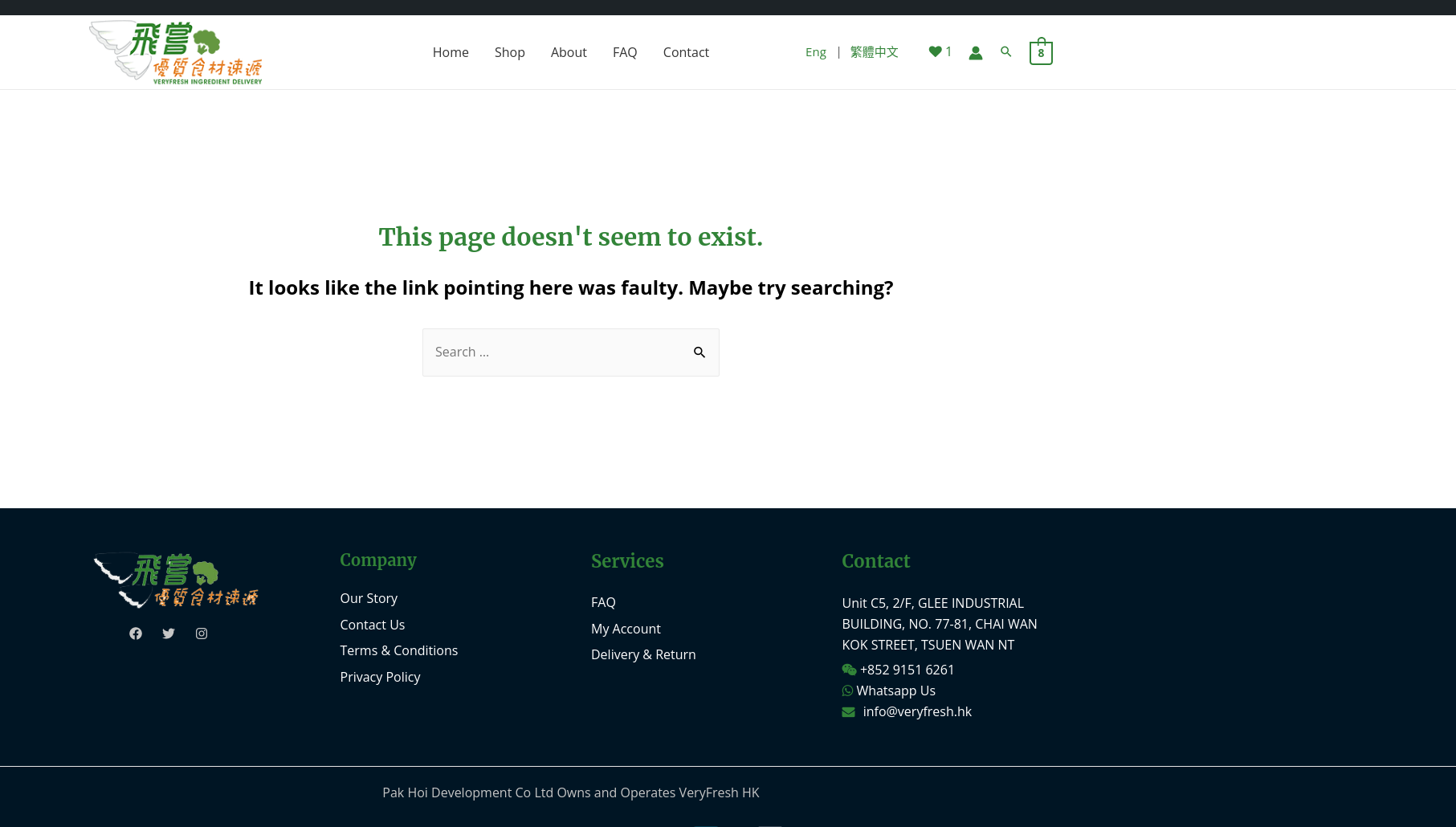

sheldonJ
I am trying to: When I am in the admin page and I try to logout.
Link to a page where the issue can be seen: any page in the admin section
I expected to see: Logout and redirect to home page
Instead, I got: It give me 404 error page when i click on the log out in the admin section

I am able to replicate the issue on your site. I see the login URL is modified with Defender Pro plugin at: Defender Pro -> Tools -> Mask Login Area.
The issue seems to be a conflict between WPML and Defender Pro or between WPML, Defender Pro, and some other plugins. Although I could not replicate the problem on my test site when deactivating either WPML or Defender Pro/Mask Login Area on your site, the logout works fine.
Please note that Defender Pro is not on our official compatible plugins list linked on the next link, and is not tested with WPML before, so there might be some incompatibilities. Therefore, If you haven’t already done so, I recommend asking the Defender Pro plugin provider to see if the plugin is compatible with WPML.

After further troubleshooting, I found that the Defender Pro plugin’s “Mask Login Area” area is conflicting with WPML on your site.
I tried replicating the issue at my end again, but I could not replicate it on a clean site with the Defender free version, so it looks like the problem is only with the Pro version of the Defender plugin. Please note that the Defender plugin is not on our official compatible plugins list linked on the next link so there could be some issues.
https://wpml.org/plugin/.
I recommend you contact the Defender Pro plugin provider and see if they can join our Go Global program linked next and work with us on making the plugin compatible with WPML.
https://wpml.org/documentation/support/go-global-program/
As a temporary fix for the issue, please:
1. Go to WPML -> Settings page
2. Scroll to log in and registration pages
3. Disable the “Allow translating the login and registration pages” option and save.
This will fix the logout issue on the site, but please note if you are also translating the login and registration page using WPML, the feature will not work with these settings update.
