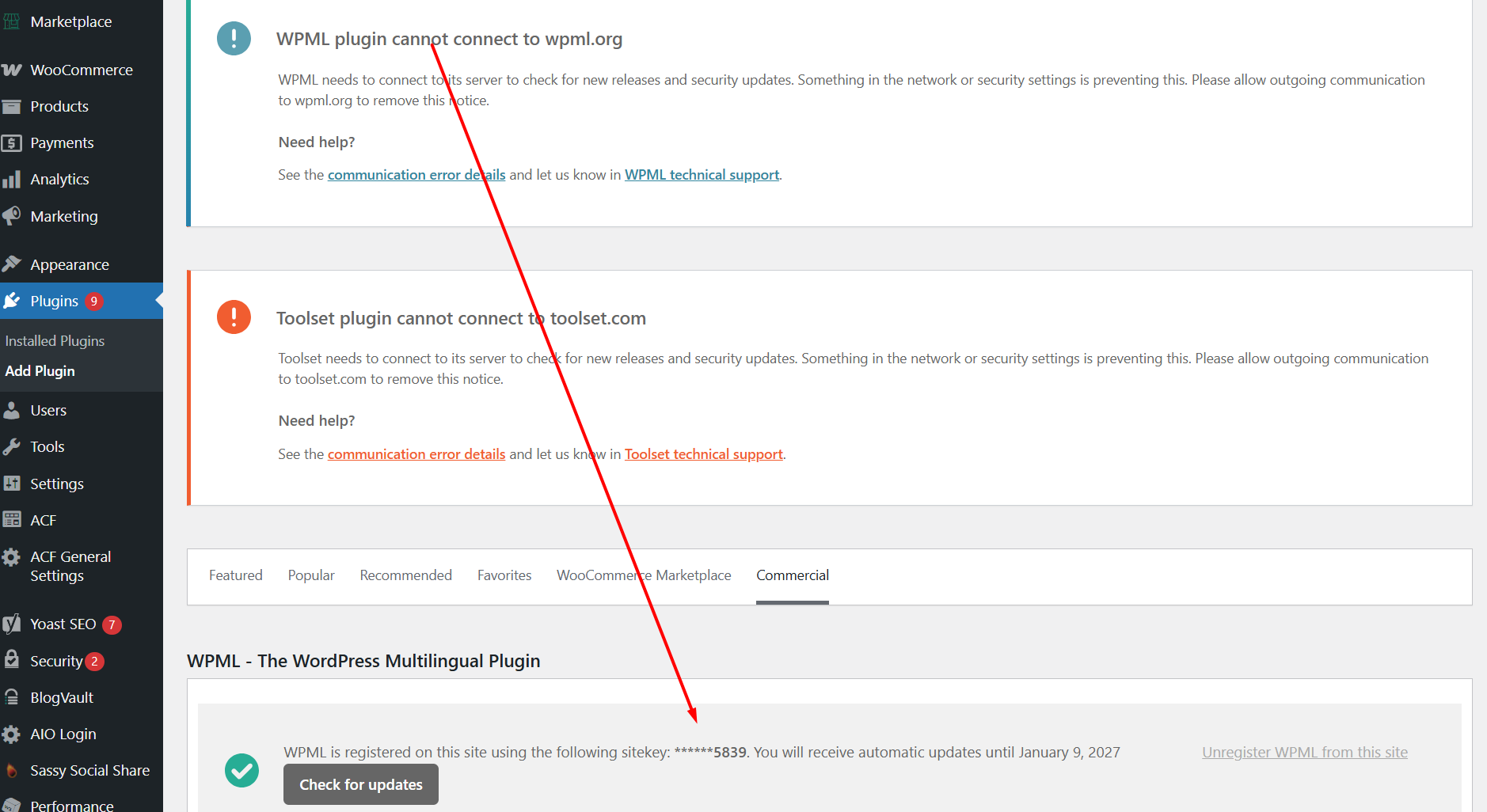

Now that we’ve connected the site key, we’re still getting the error: “WPML plugin cannot connect to wpml.org” (see connection.jpg).

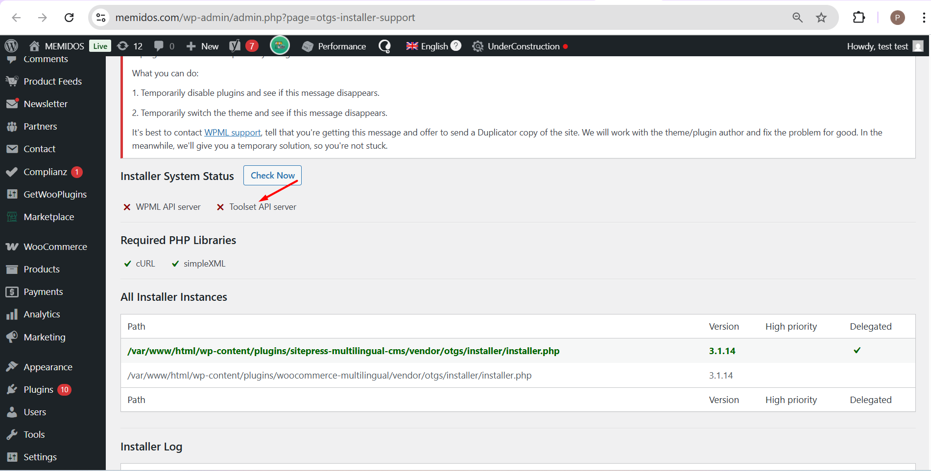

In Installer System Status, when we click the “Check now” button, both the WPML API server and Toolset API server show as disabled (see api.jpg).

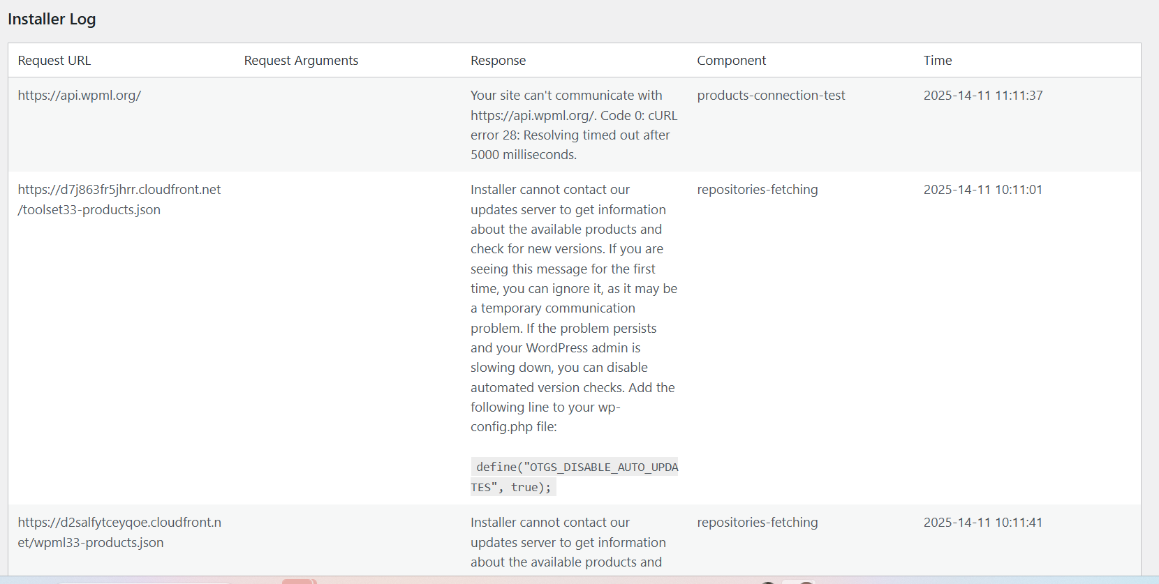

Please also see the Installer Support log (see log.jpg).

After reviewing this, it looks like there might be a firewall from the server side that is preventing our servers to connect with yours.
The wpml: cURL error 28: Operation timed out after 45009 milliseconds with 0 bytes received points to an overall slowdown, however, with the failing checks it points to a possible firewall blocking.
If possible, please verify that the firewall is not blocking and contact your hosting provider and ask them to whitelist the following domains:
wpml.org
cdn.wpml.org
api.wpml.org
api.toolset.com
cloudfront.net
