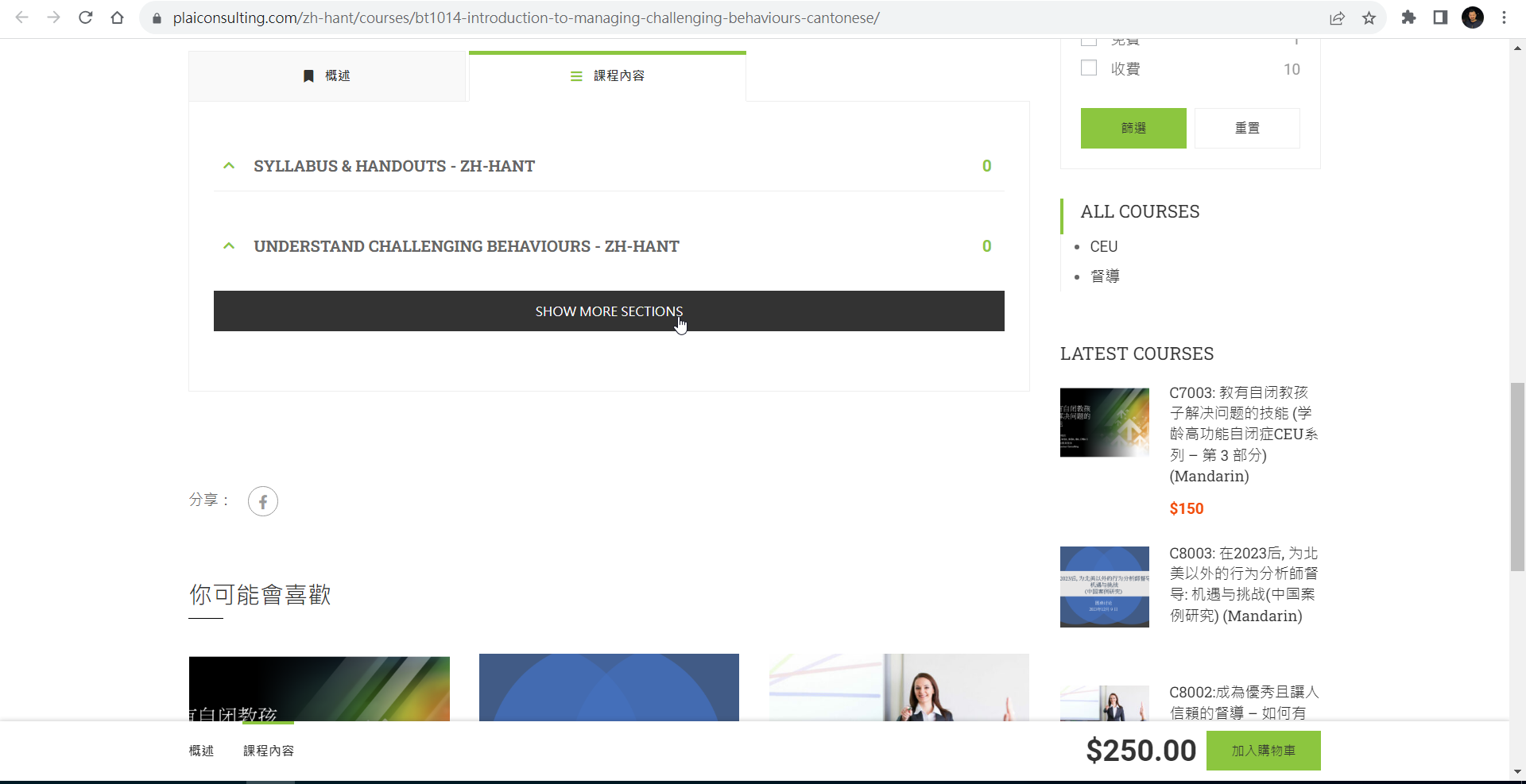

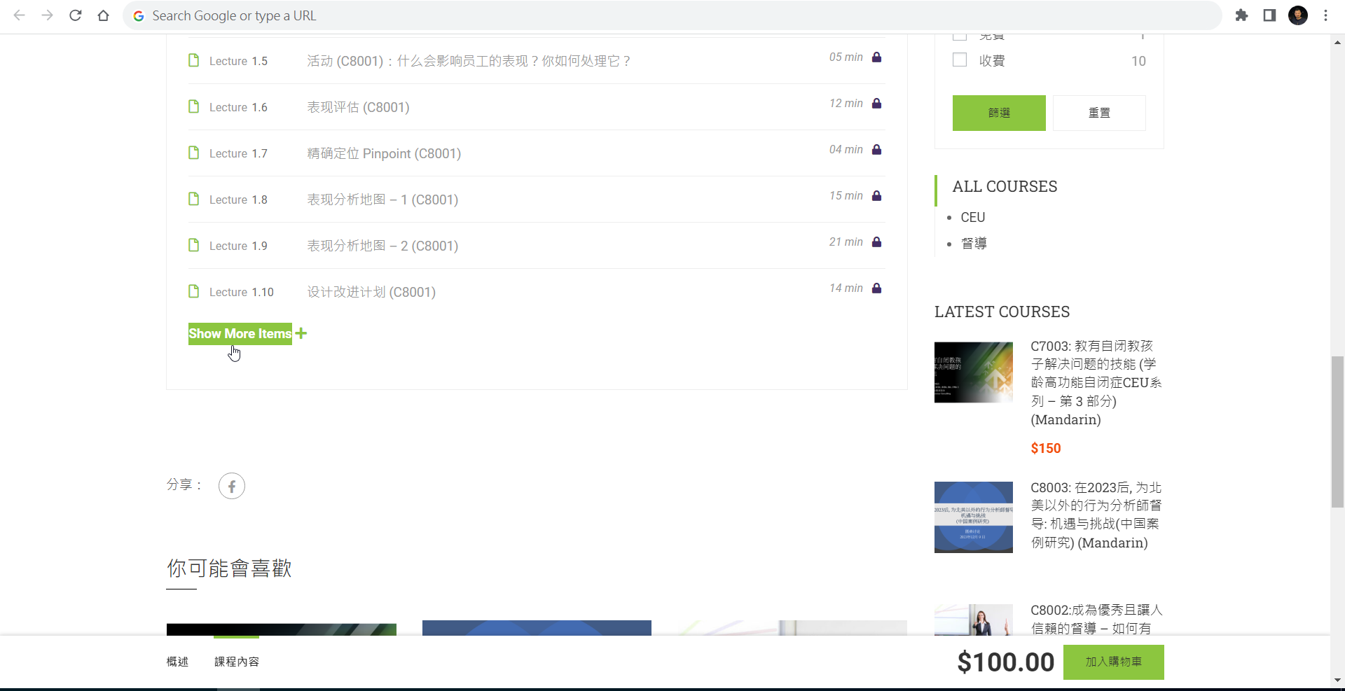

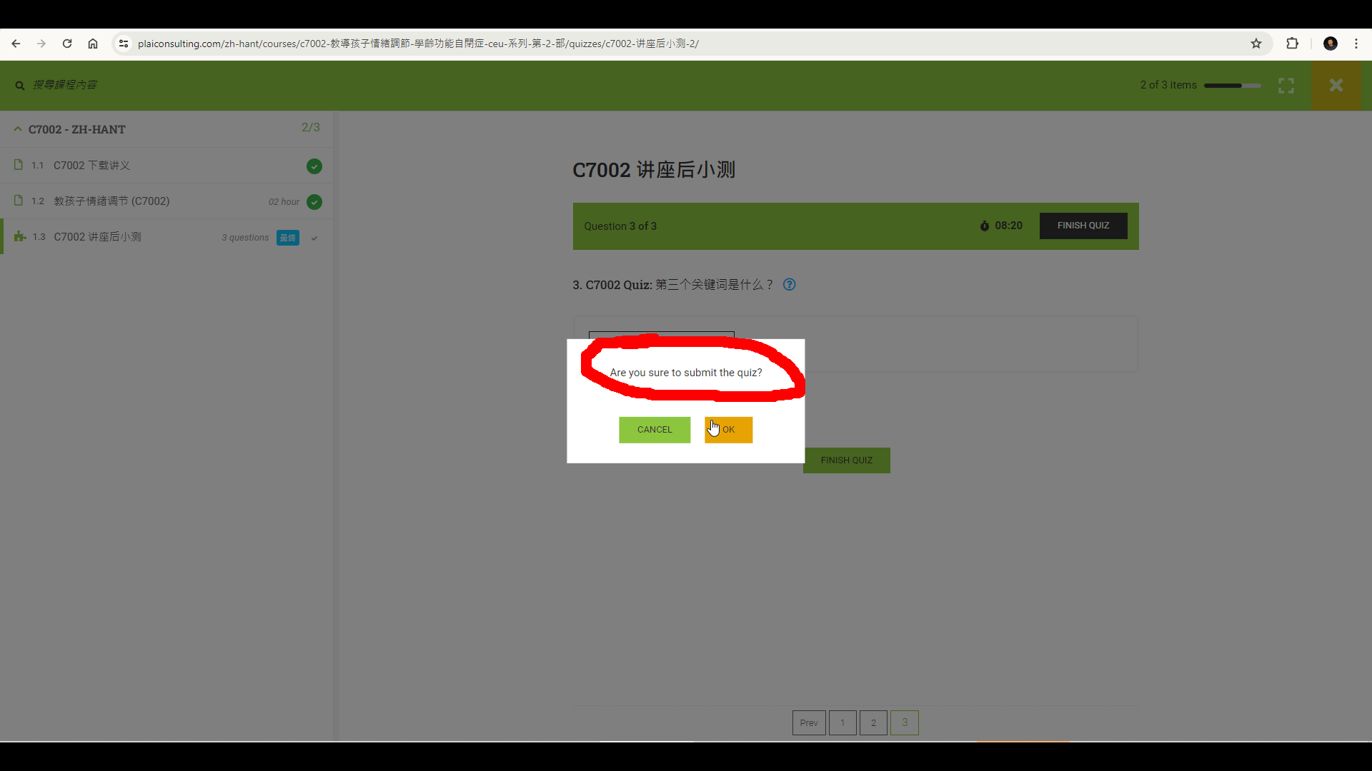

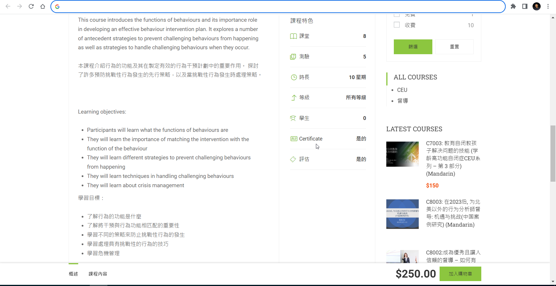

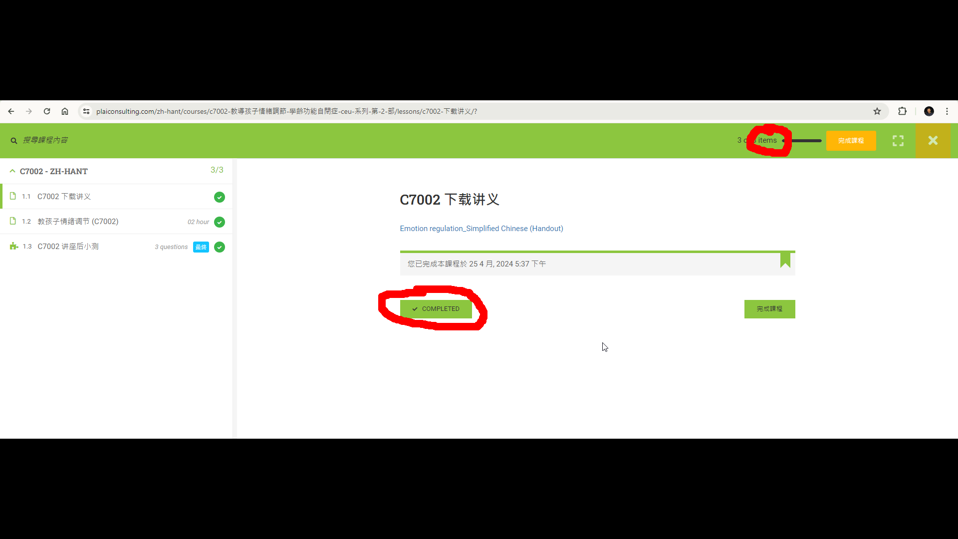

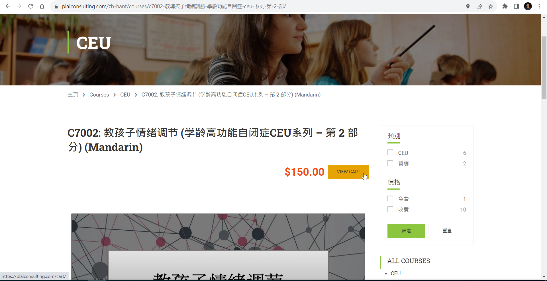

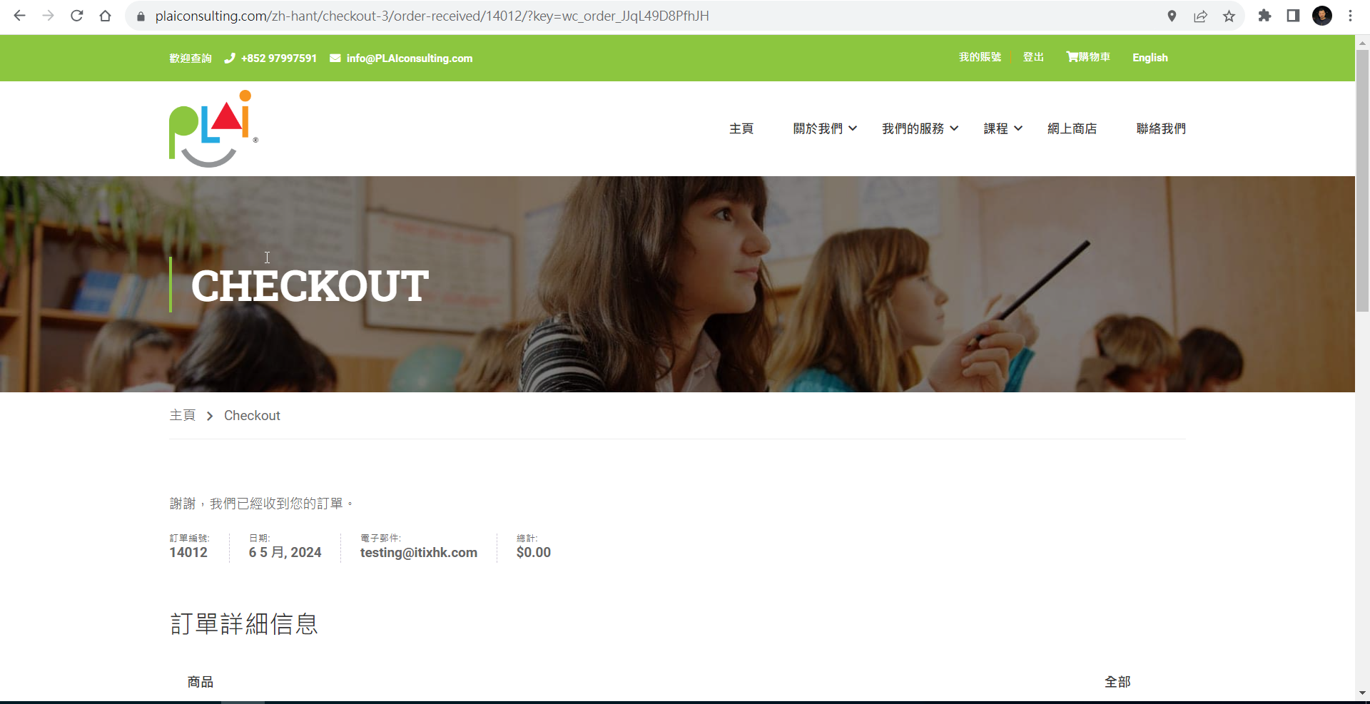

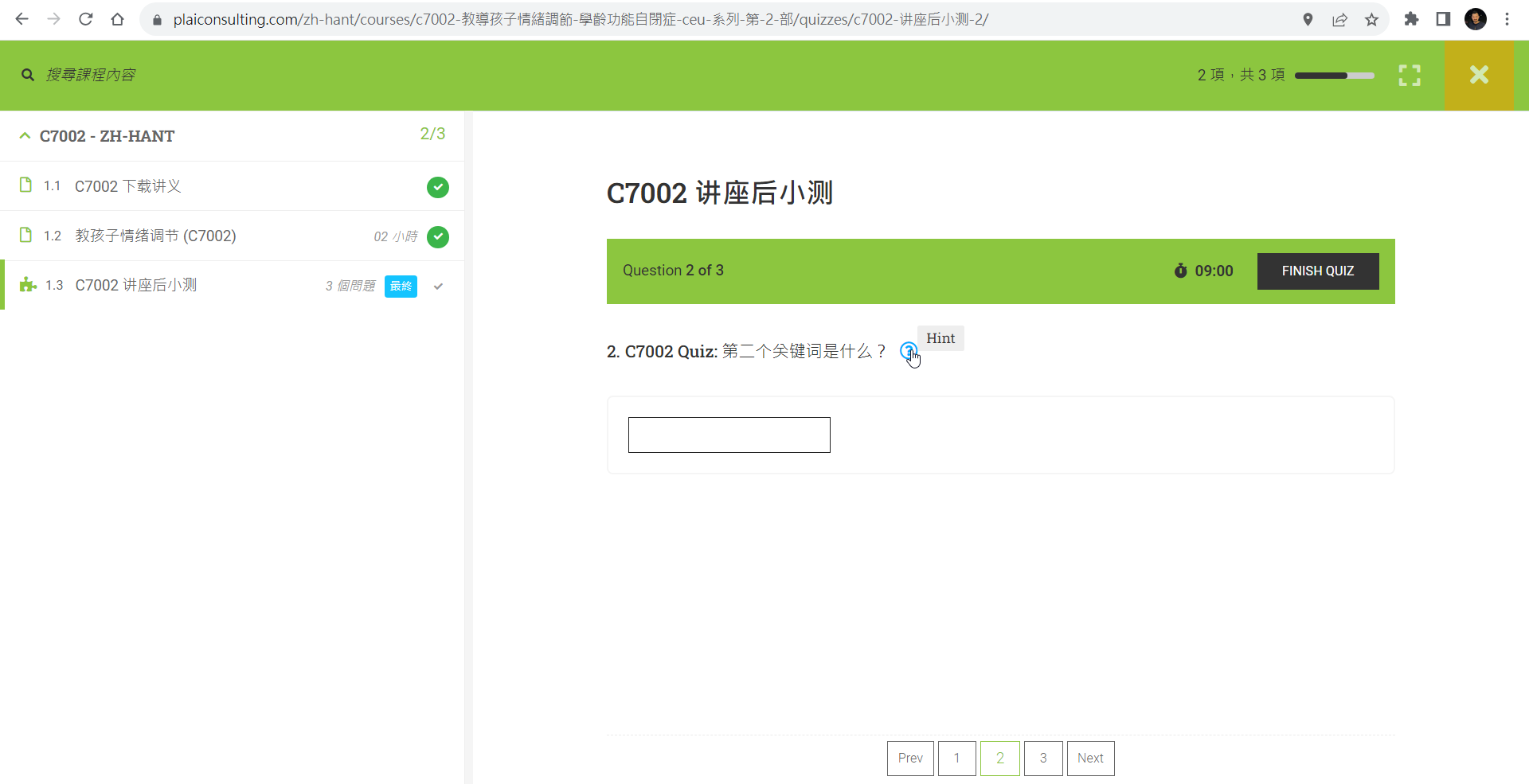

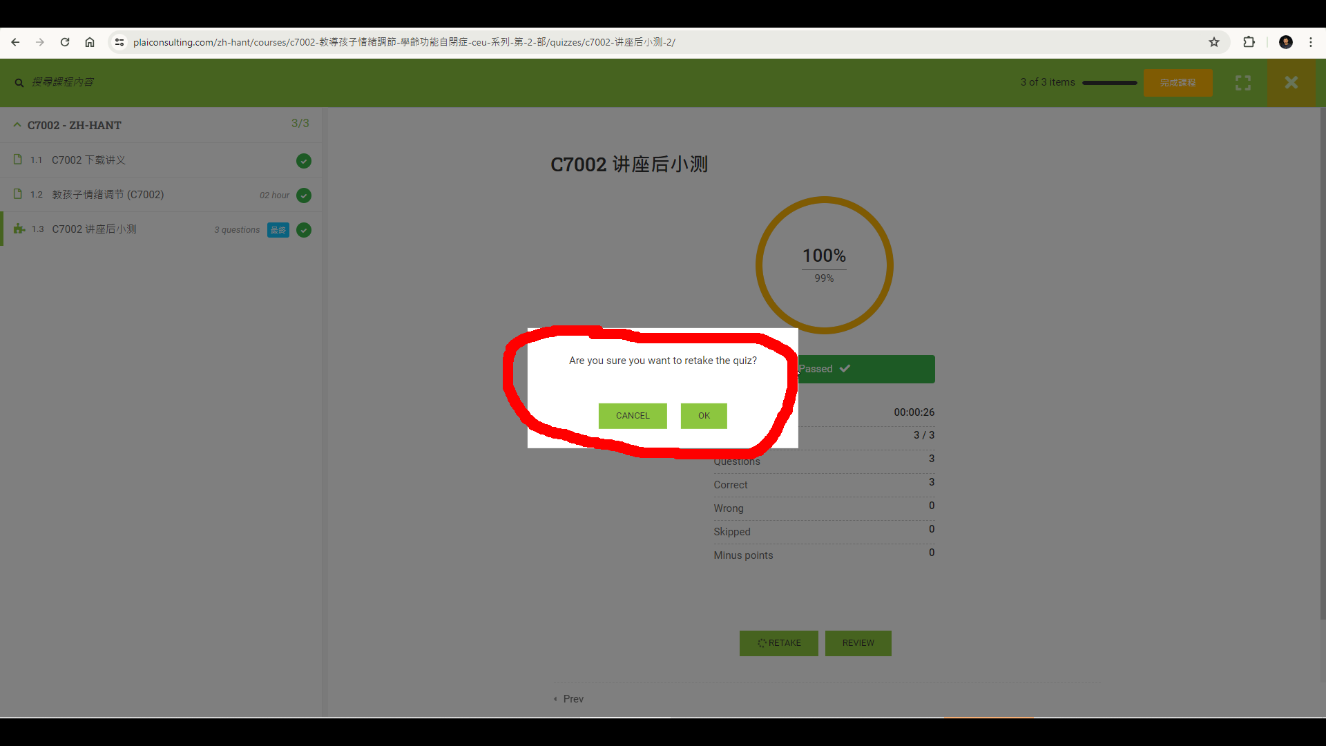

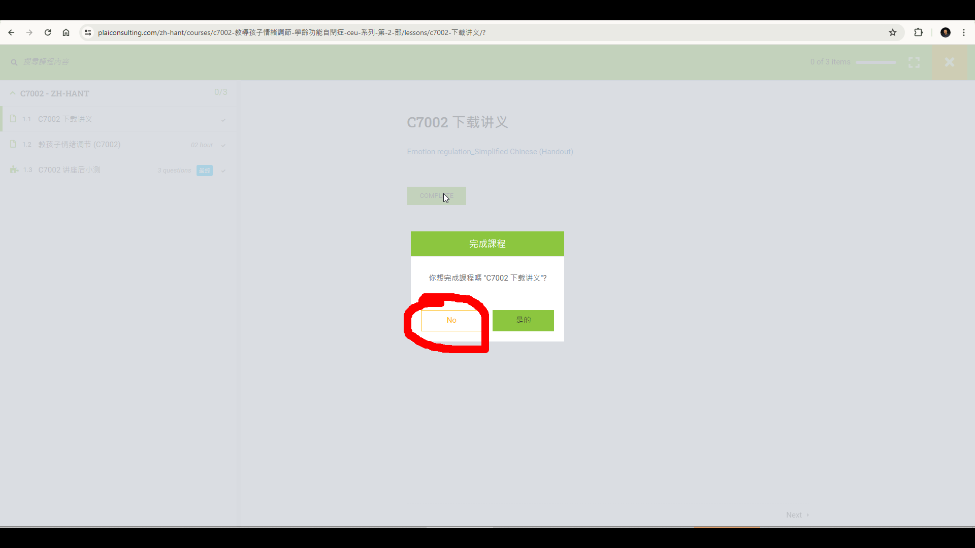

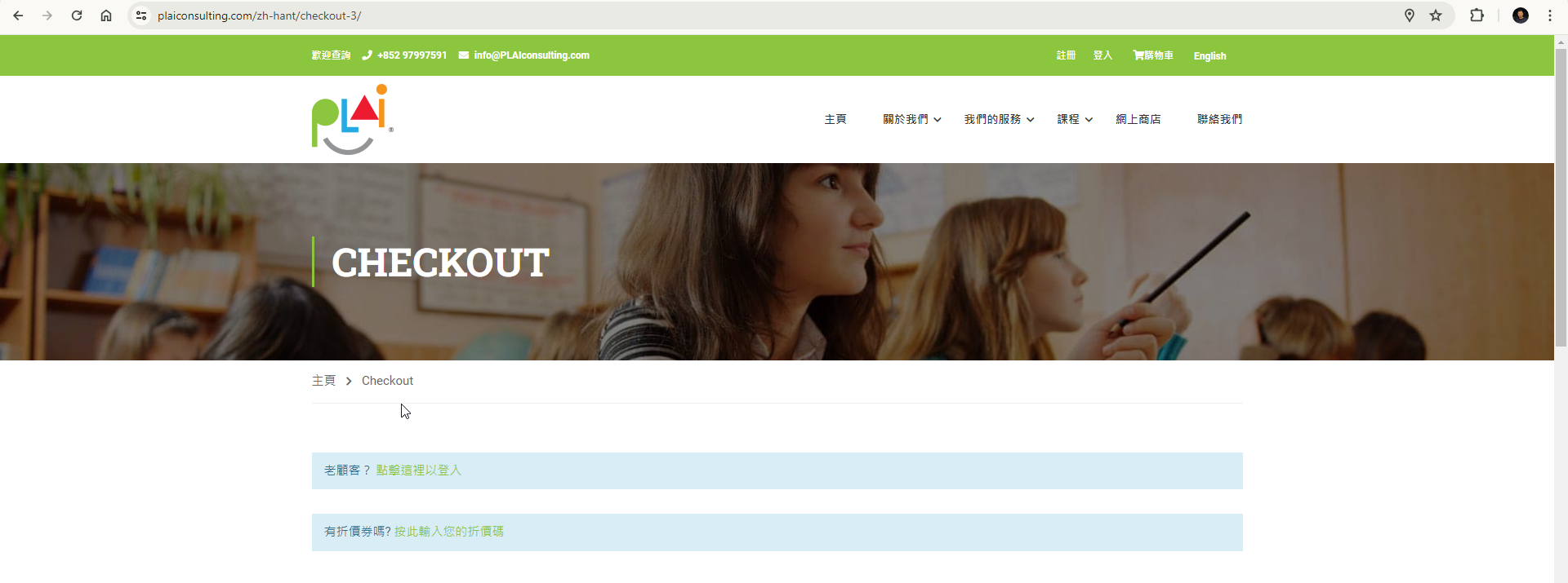

I searched documentation but still fail to do the translation of some text. Please see screen captures and let me know how I can translate them. Thx.
1.
2.
3.
4.
5.
6.
7.
8.
9.
10.
11.
12.
13.
14.

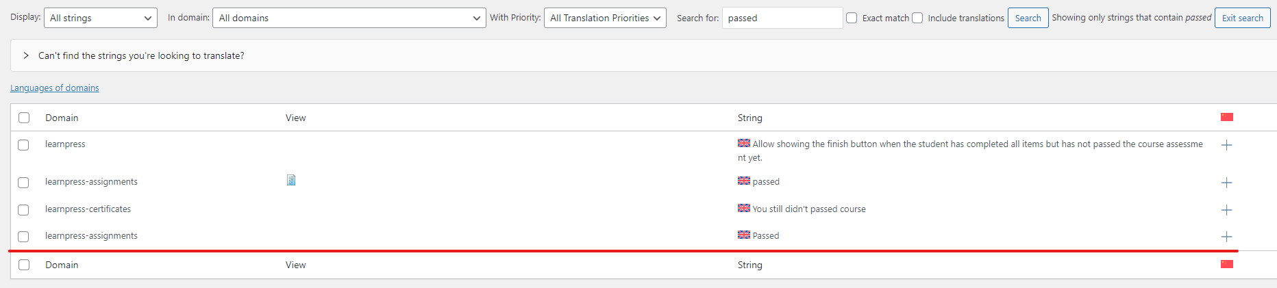

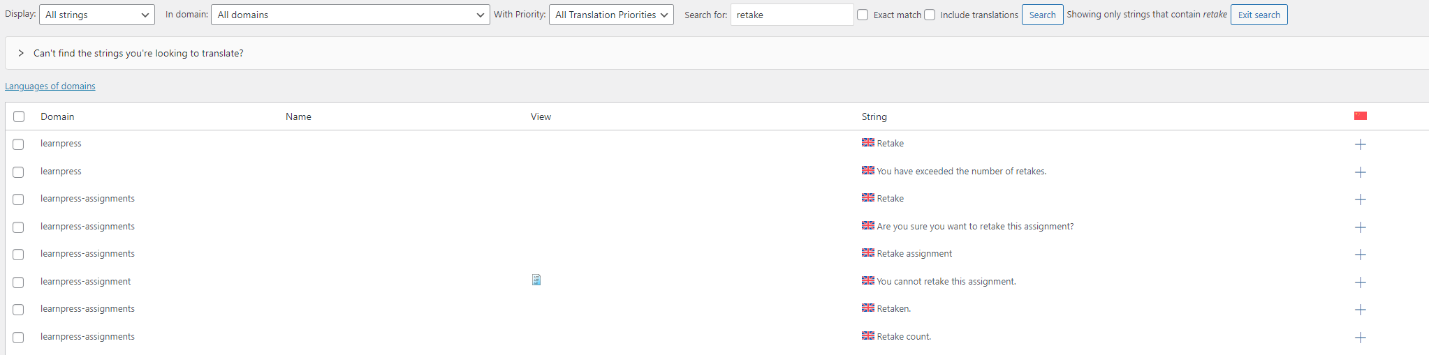

Thank you for the access, I was able to check and I've noticed that there are some strings not translated (you might need to switch to the second page of the strings table when searching for a string or change the number of strings that show in the table).
By default, the table is set to show 10 strings, you can change that on the right-bottom of the table where it says "Strings per page:"
I've done a check for two of the strings (Retake, Passed) you were having issues and as you can see on the attached images they are not translated, please translate them and check if the issue persists. (I've found both strings on the second page of the table).
Let us know if that works or if you need further questions.

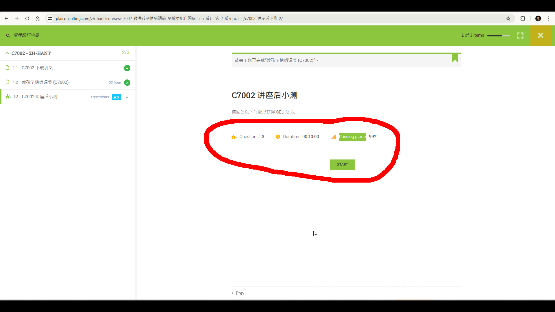

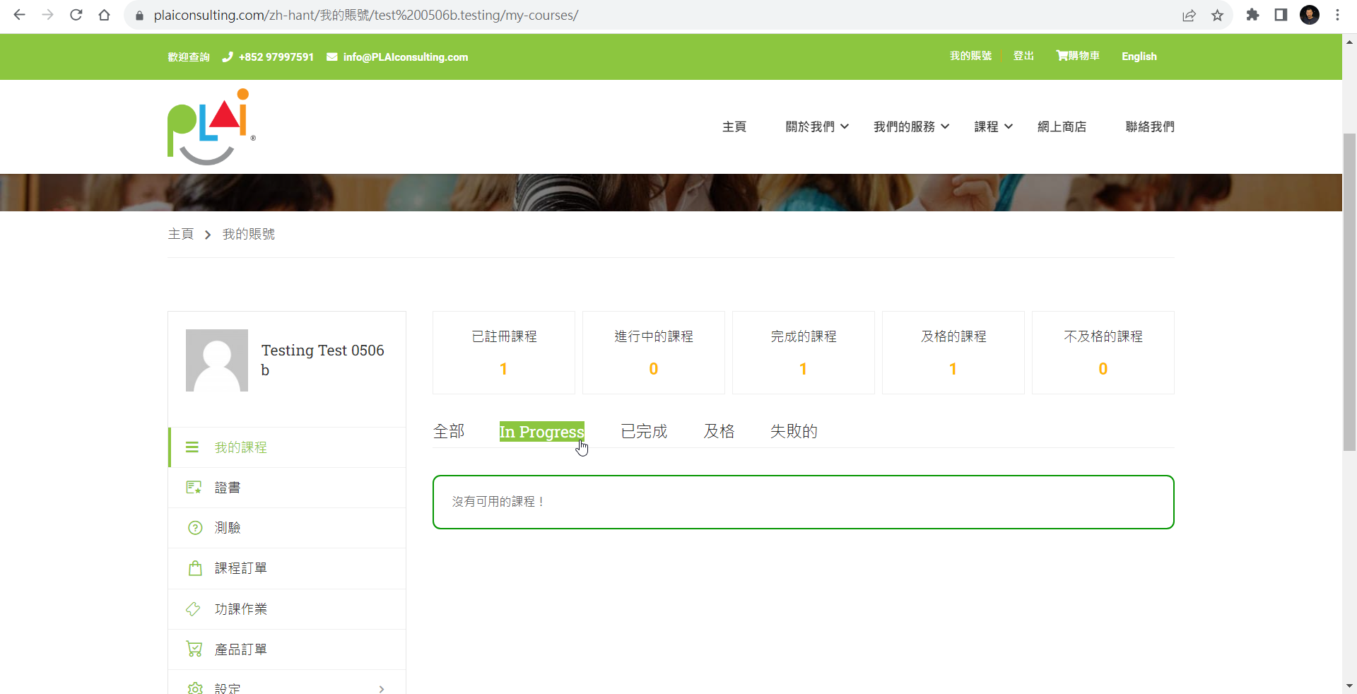

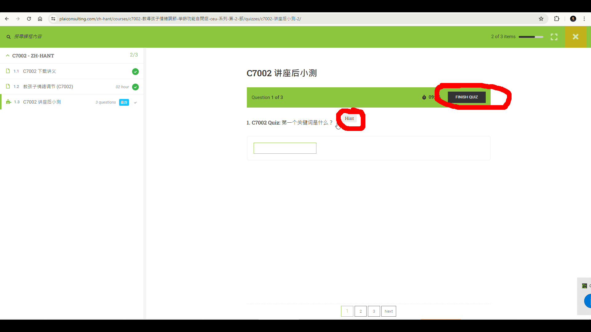

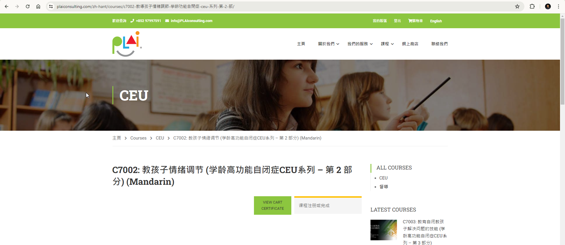

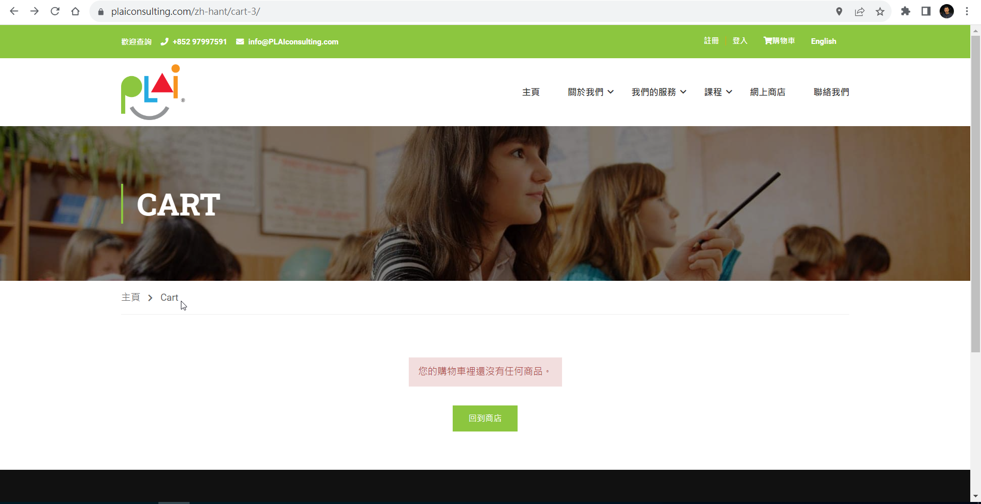

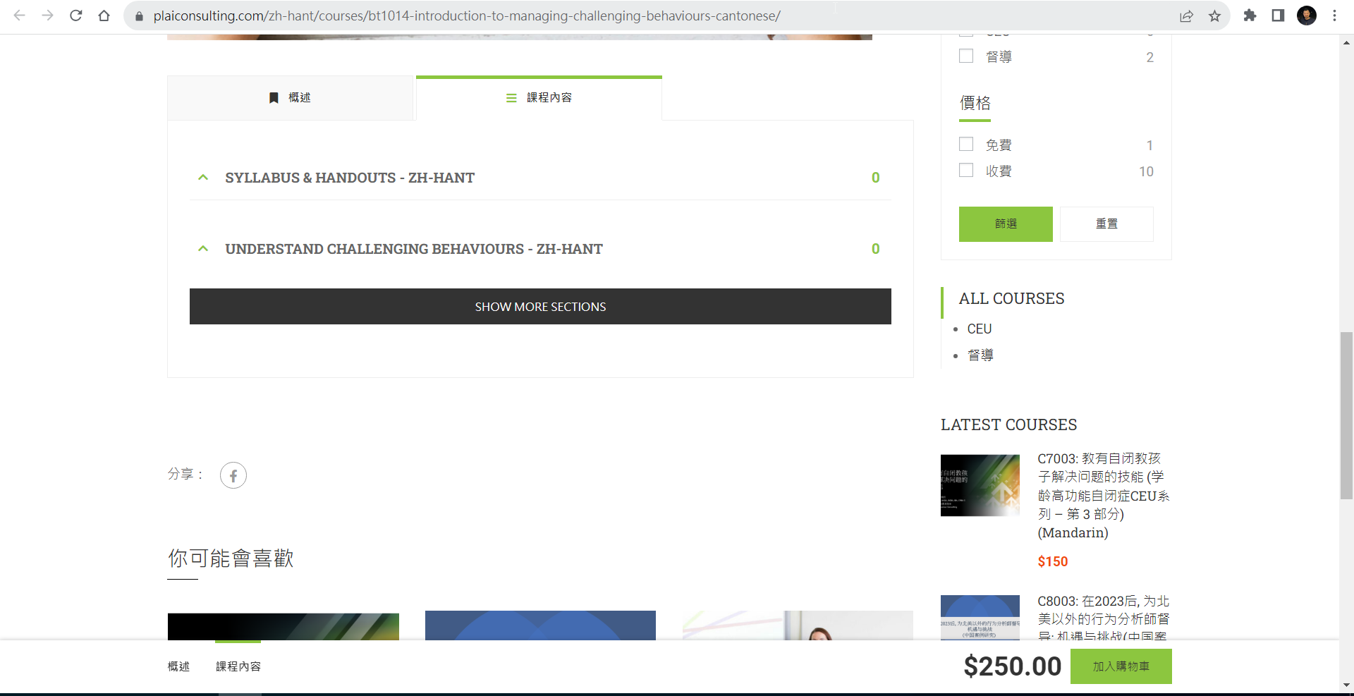

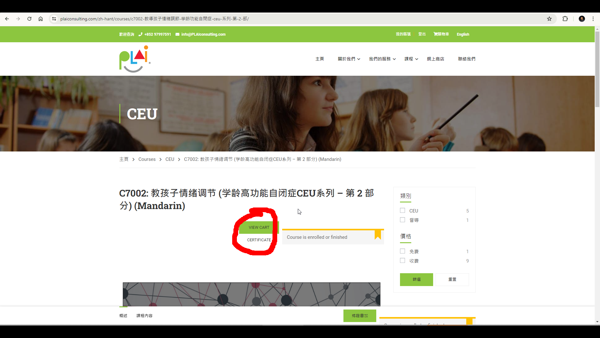

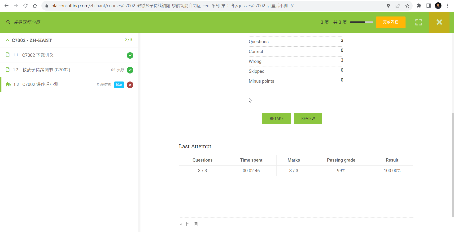

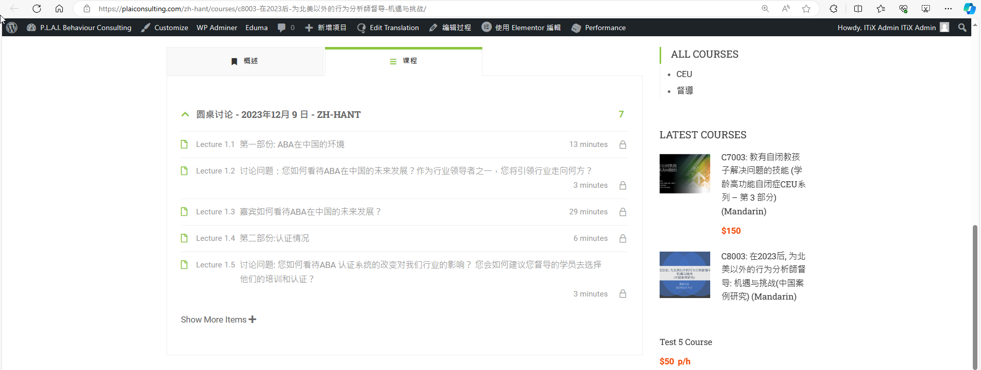

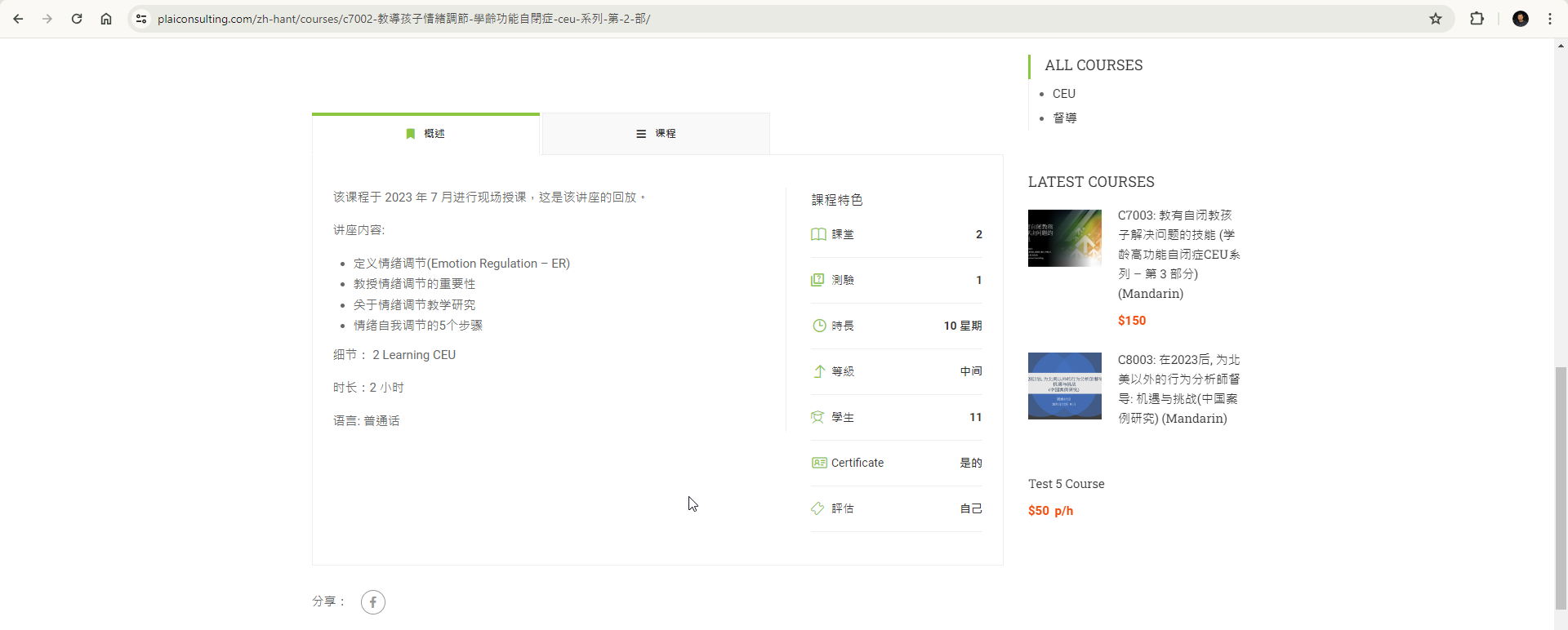

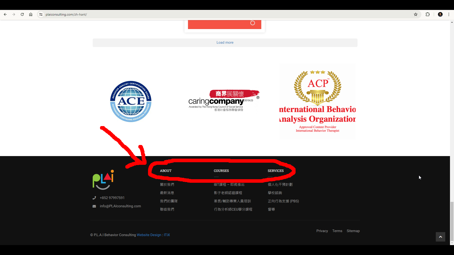

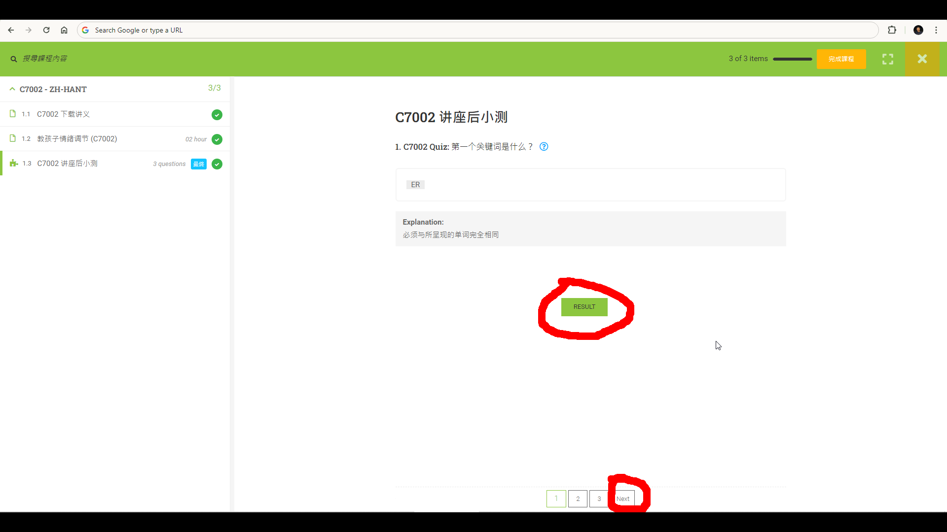

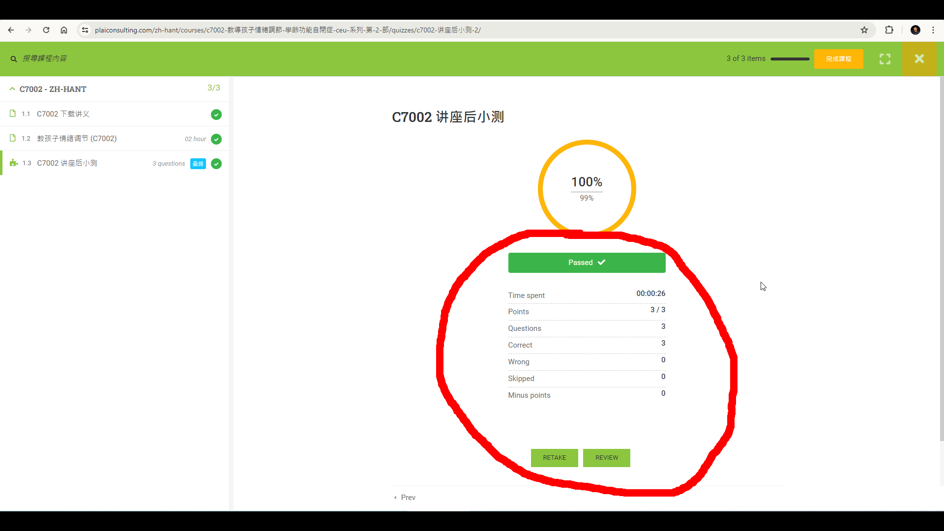

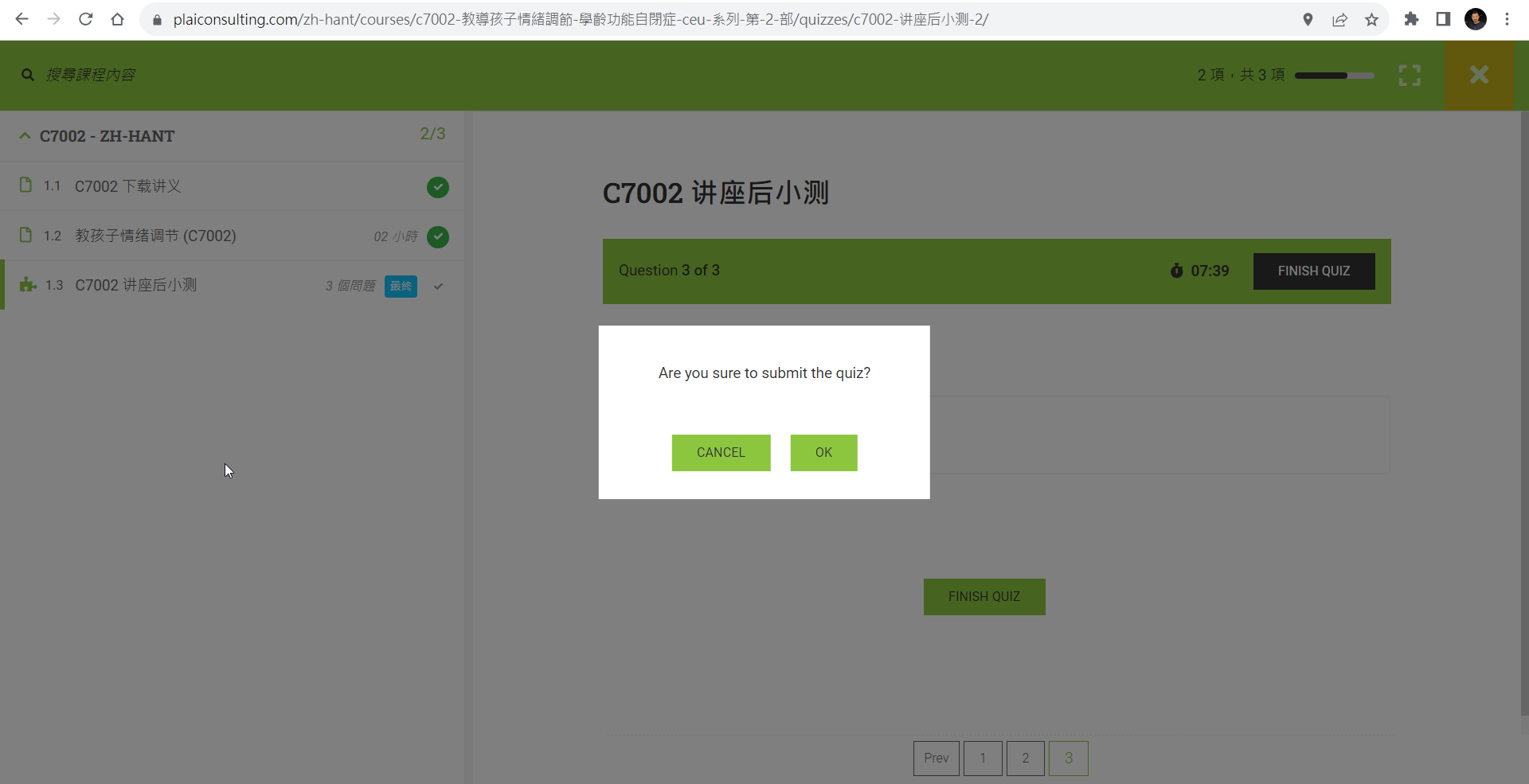

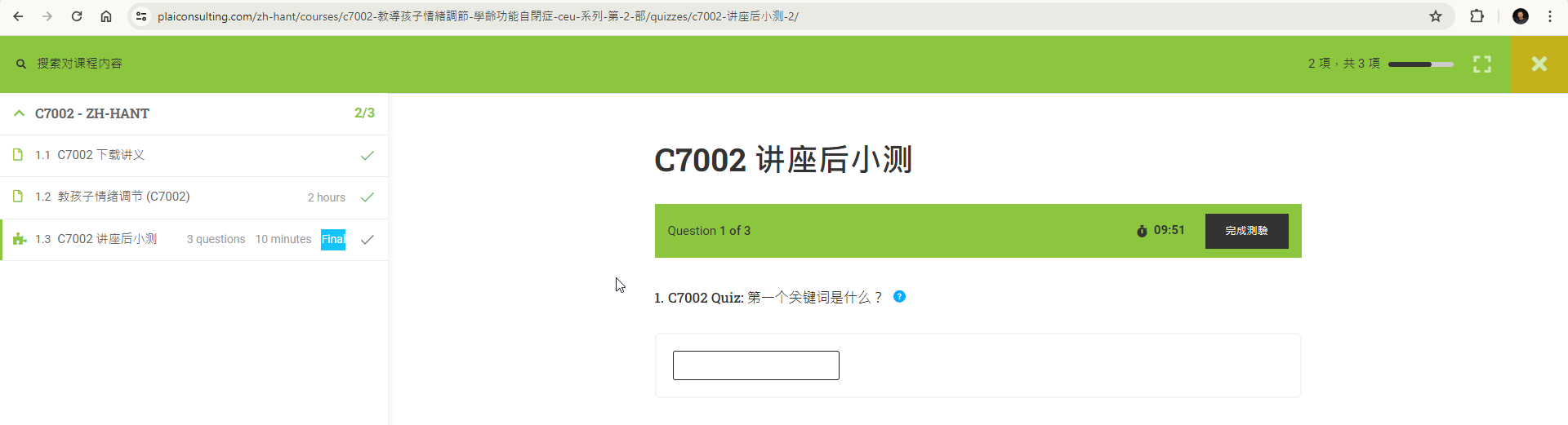

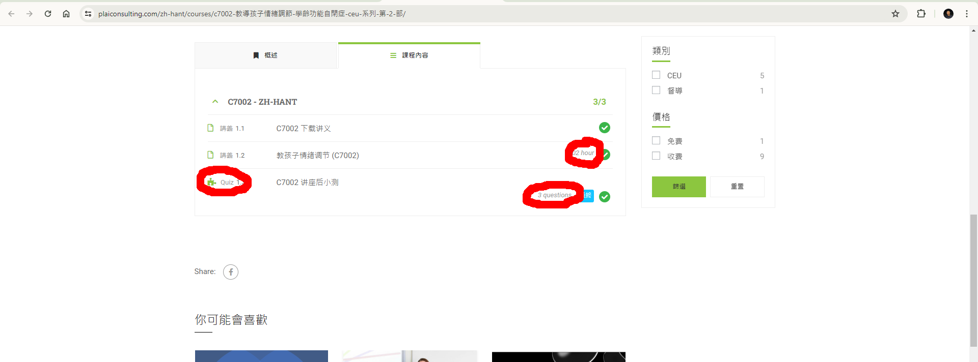

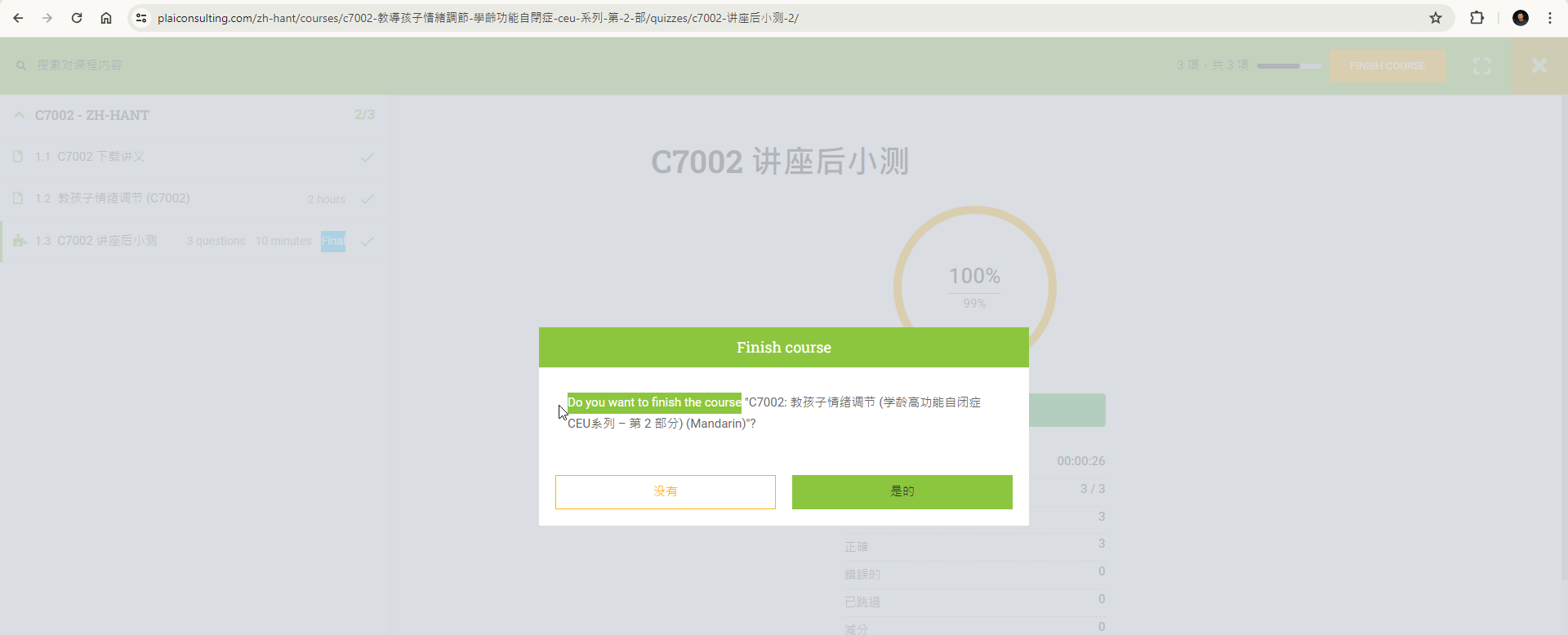

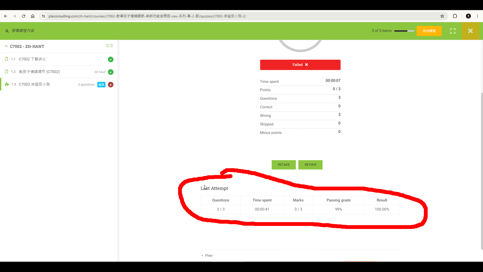

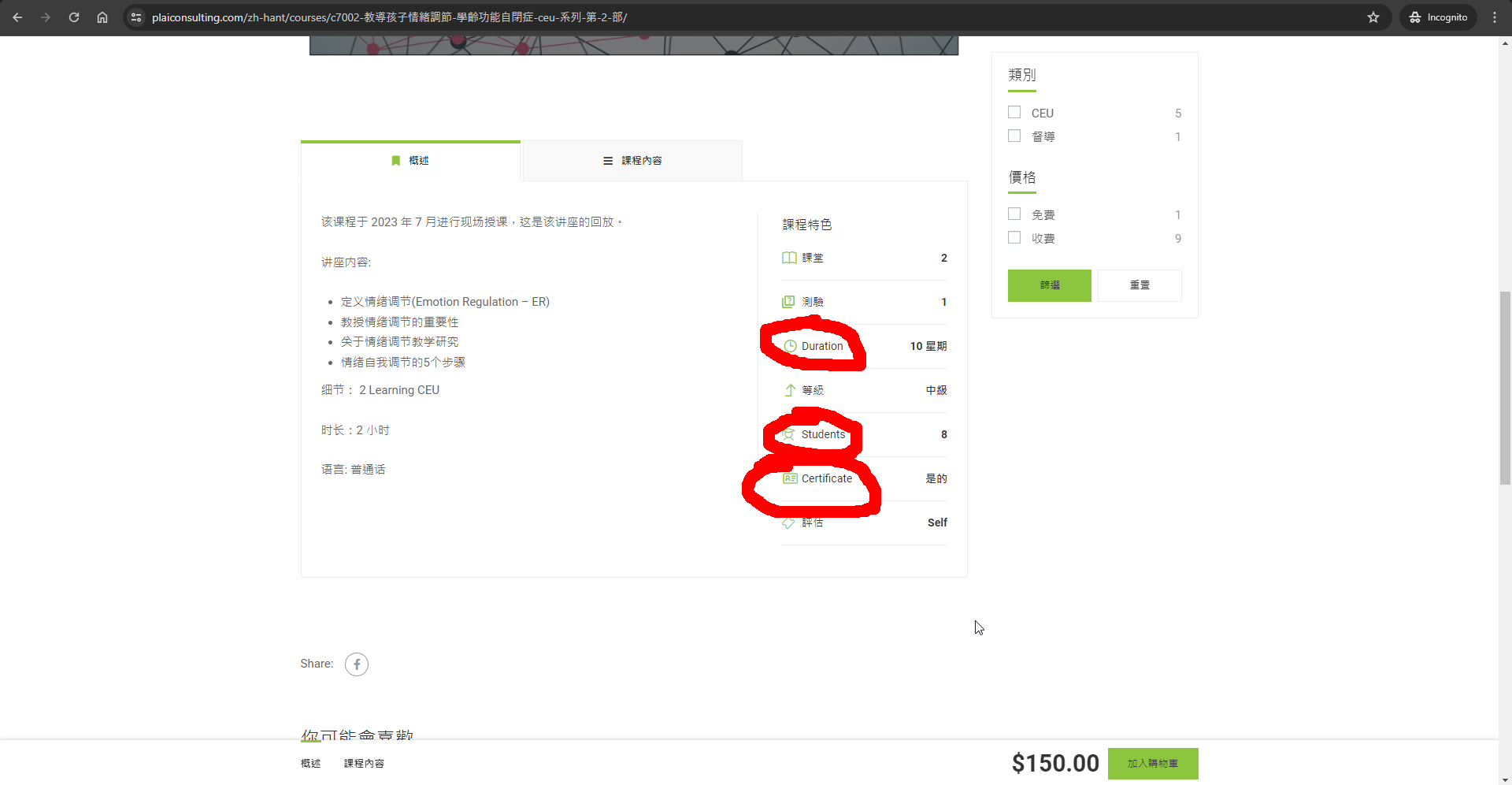

Thank you for your direct feedback. That makes works easier and I translated some of the text. However, some below text was still unable to translate. Please let me know what should I do.
The three footer text.
The text "Certificate" in below screen.
The text "Show more sections" in below screen.
The text "Lecture" in below screen.
The text "Show More Items".
The text "All Courses" and "Latest Courses" in the side bar.
"Cart"
"View Cart"
"Checkout"
"Questions"
"Duration"
"Passing Grade"
"Start"
"Question"
"Hint"
"Finish Quiz"
"Prev"
"Next"
"Are you sure to submit the quiz?"
"Cancel"
"OK"
"Last Attempt"
"Questions"
"Time spent"
"Marks"
"Passing grade"
"Result"
"View cart certificate"
"In progress"

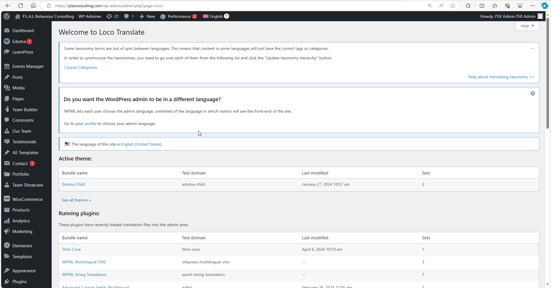

I installed Loco Translate as suggested in your provided link.
https://wpml.org/it/errata/learnpress-cant-translating-strings-from-javascript-files/
But what should I do to search for the text that I mentioned in my previous post? I'm lost.

Can you please check the video here on how you can translate the strings you are having problems with: hidden link
Let me know if you have further questions or need further assistance.

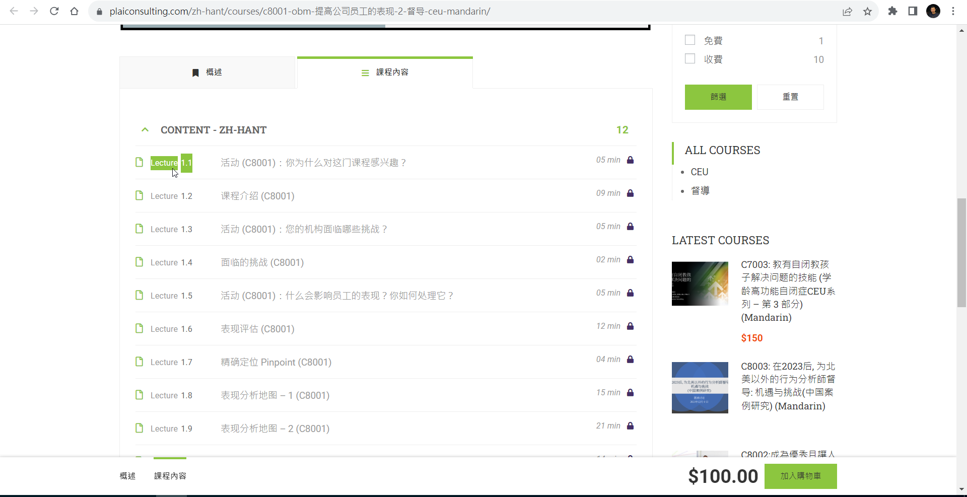

May 20, 2024 at 3:28 am #15643367
stephenH-20
I tried your above suggestion, some text are translated. However, still many text are not done. Please let me know how I can translate them. Thx.
May 20, 2024 at 3:29 am #15643467
stephenH-20
All Courses
Latest Courses
in the side bar.
