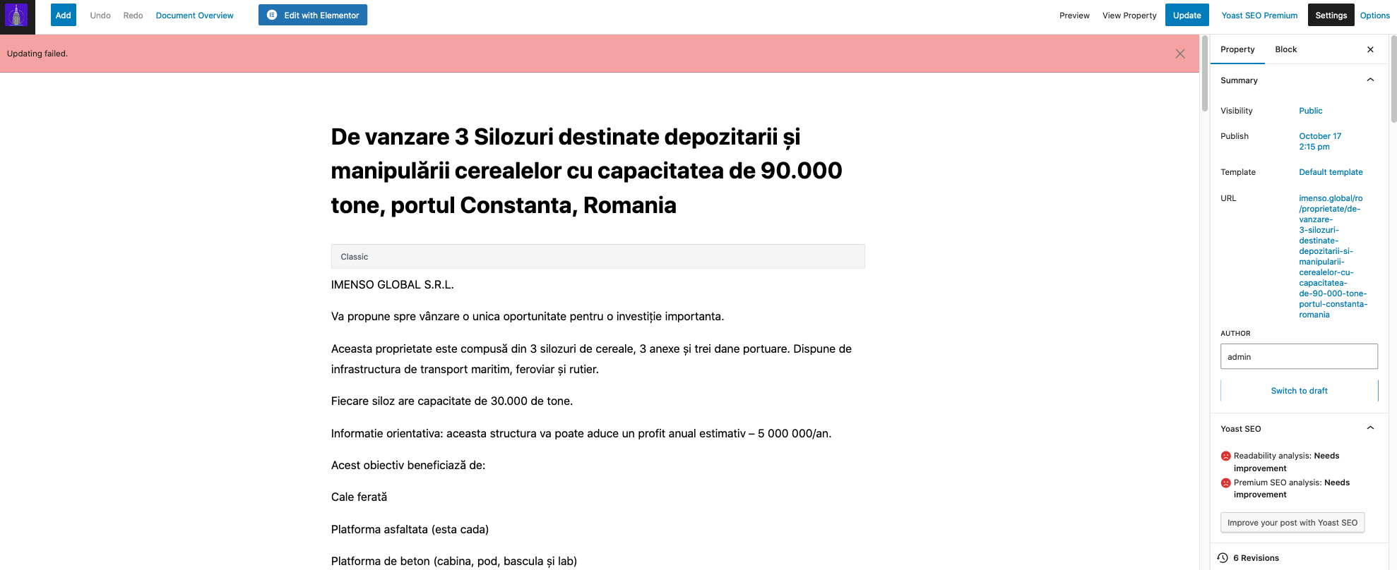

Hello
If I try to modify a translated page, it won't let me save the changes.
Errors:

I can't save the changes to a translated page.
For example, changes to the title, seo, description/content, give an error and do not save.
Error: Publishing failed.
Before there was the error: No route matching URL and request method found

Error:
Updating failed. No route was found matching the URL and request method.
Updating failed. No route was found matching the URL and request method..png
