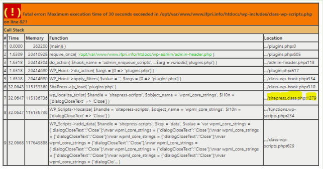

Hi, I'm upgrading the plugin of 4.6.6 (w/ PHP 8.1) from 4.2.7.1 (w/ PHP 7.4) at new dev server. When activating the new plugin, it shows Fatal error below, and it results in blocking to access any /wp-admin pages.
The error message (error1.PNG) and location '.../sitepress.class.php : 1279' (error2.PNG) are attached here.
The same action was tested with longer execution time limit (such as 300 sec), but it gives same result.

I just tested with 4 major versions with PHP 8.1 at our multi site server, but activation was failed. Also, I created empty microsite at the same server, it does not work also.
I see same error message (attached above) at same location in 30 sec limit, and when increasing time limit and memory, it also ended up with memory exhaustion.

I found that the old Share Buttons by AddThis plugin conflicts with WPML Multilingual CMS plugin. Thank you.
