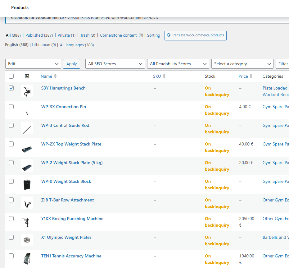

I am trying to install WPML on my WordPress page with WooCommerce. I'm also installing the WooCommerce Multilingual plugin. After doing the setup, I noticed an issue. Here is a link to a page where the issue can be seen: hidden link
I have tried the "fix product_type taxonomy terms"
This site usually isn't supposed to have any grouped products and all variable products had prices before. I have a backup of before installing WPML.

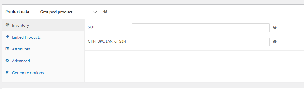

After installing WPML, all products that were once variable products have changed to grouped products and lost their prices and variations. I expected to see a WPML installation with variable products remaining on the original language, but instead, I got a WPML installation with broken products.
Why are my variable products changing to grouped products after installing WPML?
How can I fix the issue of products losing their prices and variations?

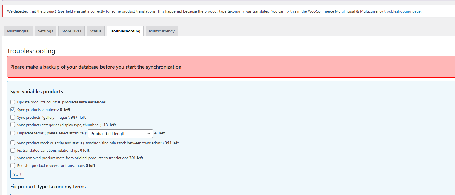

Reference to our recent chat, I tried several options and as soon as I try that fix taxonomy option in WCML troubleshooting, variable products turn into Grouped ones.
Before that, variable products also not showing variations, despite there's a count shown in variations section (about the available variations).
I've hidden link to observe all this. And also have added this with my notes for my colleagues.

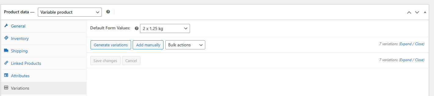

I guess that resolved the product type issue, but the variations are still being hidden, as seen in the screenshot I attached.
In this product: hidden link

June 5, 2025 at 7:47 am #17108878
Dražen
this fixes the issue:
- Update WPML to latest versions
- Run troubleshooting function from WPML>Support> Troubleshooting > Set language information
Drazen
June 5, 2025 at 9:37 am #17109364
oliverR-34
Hello, that did fix it.
