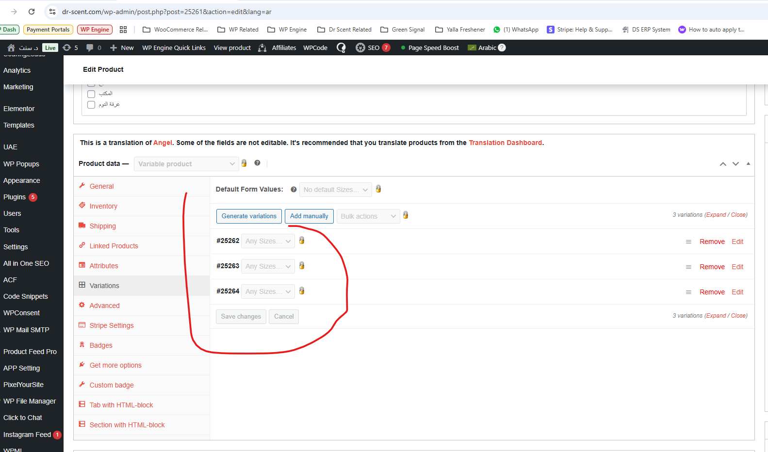

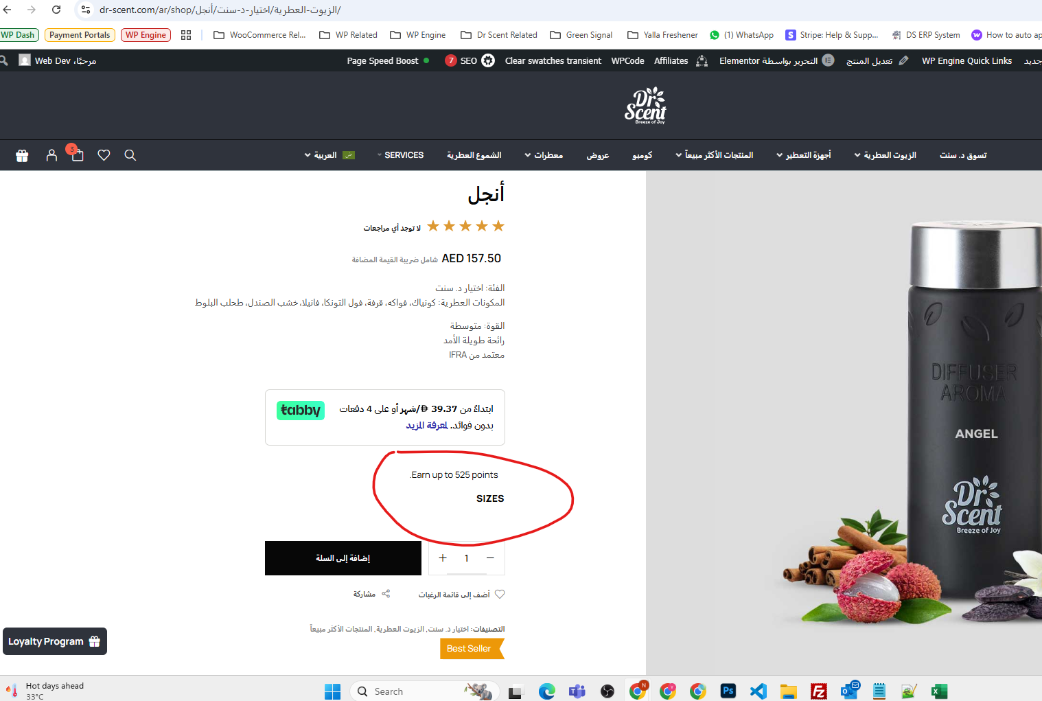

I am trying to ensure that variable products on our main website, dr-scent.com, are working correctly. The content is already translated from English to Arabic using WPML. The site iraq.dr-scent.com is functioning properly in both languages.
Variable products on the main website dr-scent.com are not displaying variations correctly in Arabic.
What settings might I have missed that are causing variable products to not display correctly?
Why are composite and variable products not working on the main site but working on the Iraq site?

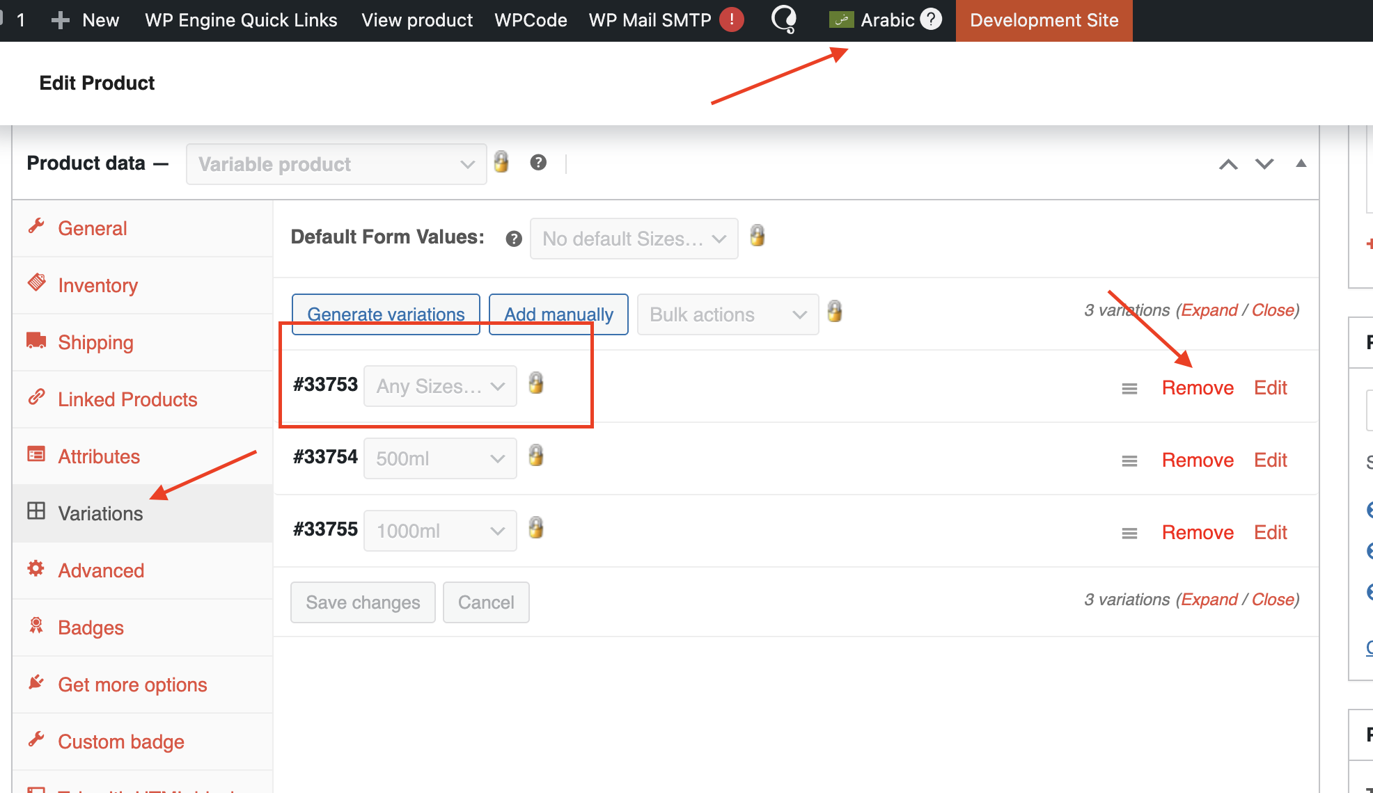

The scone tier support checked the issue and found out that for some reason, the Variables are set as ANY if you go to the edit screen of the product and from the top admin language bar, change the flag to the secondary language.
By clicking the REMOVE link next to those variables (even if they are shown as locked, it is possible to click the REMOVE link) and saving the product and doing a small change to complete the translation, it worked.

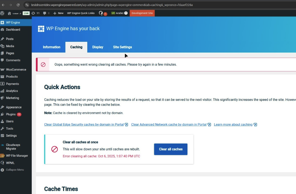

But I tried to do that on your staging version of the website and clear the cache, but for some reason cache is not clearing (check the screenshot attached)
Would you please investigate why the cache is not clearing so you can test the steps I mentioned?

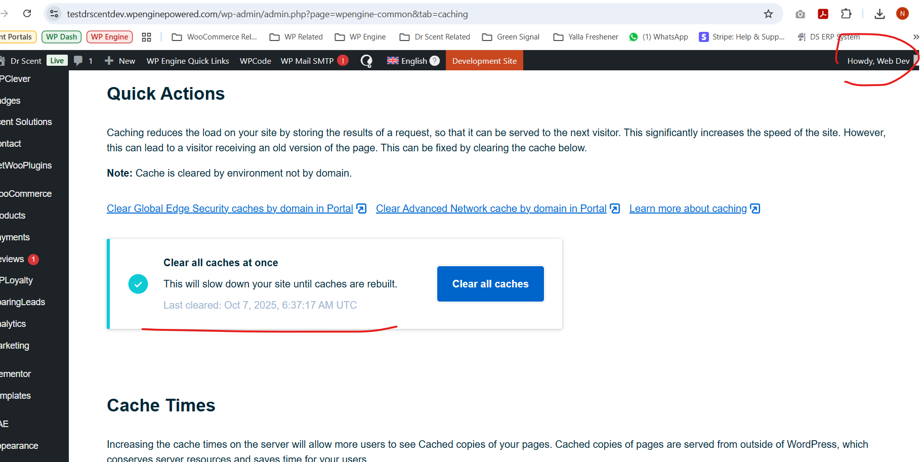

drS
I removed the cache using the same login I gave to you, oh there can be one reason, if you copy it to your local how come WP Engine cache will work? or get clear? WP Engine cache can work or be remove only when it is present there, if i make its copy on my local then this option will not work for sure, because then there is no cache

Thank you for clearing the cache, I also checked the staging website and could clear the cache:
Now if you check the product in question that I was checking it works:

So basically, Doing the steps below fixed the issue:
- Go to the Product edit screen in Arabic.
- Click the variations tab and you will see that the locked variations show as ANY instead of having the correct values.
- Click the remove link for the variations.
- Save the product.
- Send the EN product for translation again.
- Clear the cache.

October 7, 2025 at 11:51 am #17463603
drS
Also I think composite products have still the issue.
English Link:
Arabic Link:
