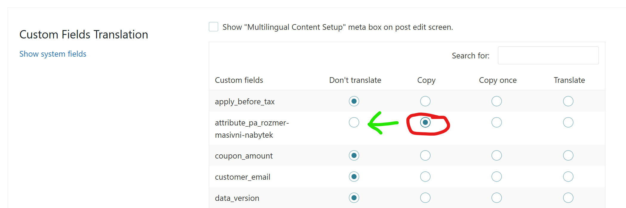

Root cause probably identified: switching taxonomy translation mode caused WPML to register attribute_pa_* custom fields as Copy in Translation Management settings. This silently overwrote correctly translated variation attribute slugs on every sync.
Fix: setting the field to Don't translate in WPML → Translation Management → Custom Fields.
