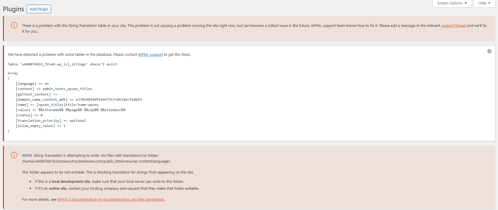

The client was trying to install and configure the WPML plugin but encountered an error stating that the table
...wp_icl_strings
does not exist. Additionally, the 'Support' option was missing from the WPML side menu, preventing a reset.

I am trying to install and configure the WPML plugin on my site hidden link. I am following the documentation from hidden link and https://wpml.org/documentation/getting-started-guide/.
I have a problem with the table ..._icl_strings in the database.
How can I resolve the issue with the ..._icl_strings table in the database?

I've already restored my site from a backup, but every time I install the WPML plugins — specifically the String Translation plugin — I run into this problem again.
I tried the solution suggested here: https://wpml.org/forums/topic/error-table-wp_icl_strings-doesnt-exist/, but when I delete that PHP file, the issue comes back and I lose the theme content.

When I first installed the WPML plugin, I encountered the error:
"Table '...wp_icl_strings' doesn't exist."
Additionally, the "Support" option did not appear in the WPML side menu, so I couldn't perform a reset as instructed here:
https://wpml.org/documentation/getting-started-guide/language-setup/deleting-languages-and-plugin-data-by-doing-a-wpml-reset-on-your-site/#step-3-do-the-wpml-reset
Following the steps suggested in this thread — https://wpml.org/forums/topic/error-table-wp_icl_strings-doesnt-exist/ — It "completed" the installation process. After that, the "Support" menu item appeared, and I was finally able to perform the reset. Once the reset was done, the error disappeared and everything worked as expected.
