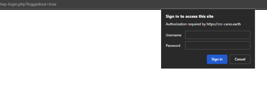

The WordPress login information might be fine, but I need the username and password for the server protection. See screenshot.

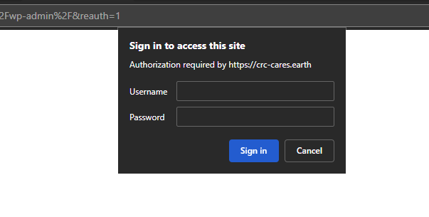

I can sadly still not access the WordPress login form. Please revise the attached screenshot.
I need the username and password for the server protection dialog.

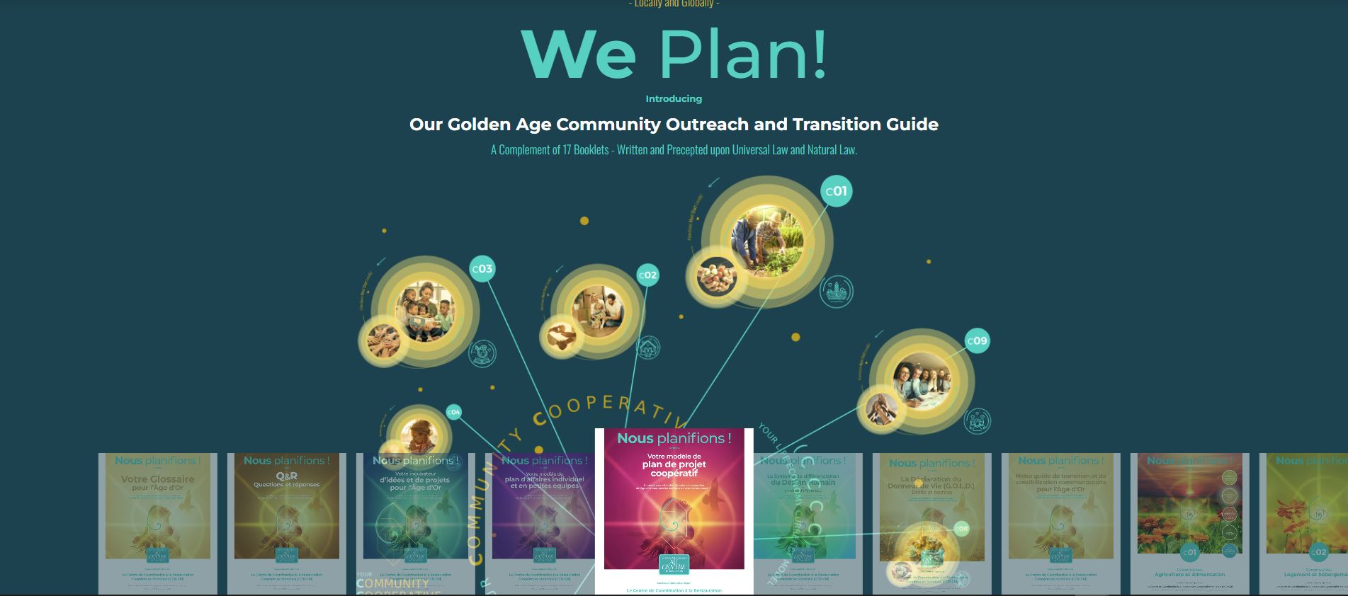

I see French images on your original English homepage inside the section "We plan":
You are using a Template (Container) called "We plan".
Inside there, you use the widget "Coverflow Carousel" from Unlimited Elementor for Elementor, which does not filter the images correctly by language.

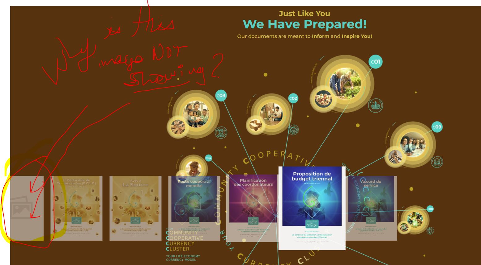

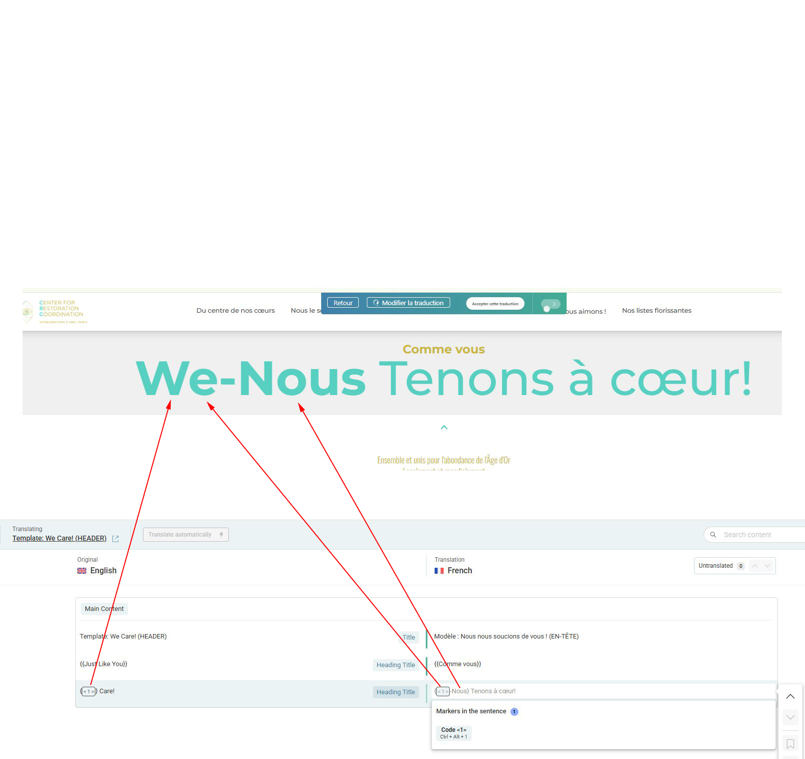

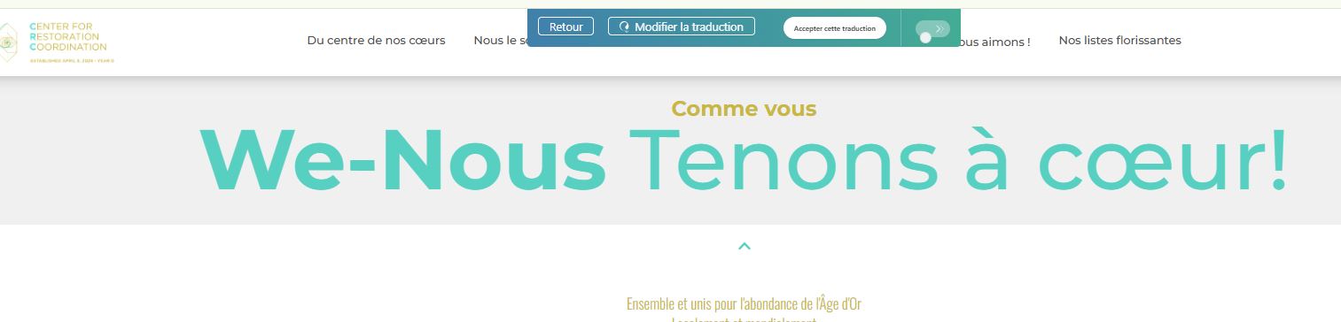

HI Andreas, the is the problem!
The WPML plug-in is not showing the correct language in some widgets
1. The CoverFlow
2. The Dual Heading (which keeps the EN version within the brackets).
See same images attached.
How can you adjust the WPML settings so it recognizes the languages settings of the imagery (like it is sold to us)?

On my test site, I can confirm the issue with the images inside the "CoverFlow Carousel".

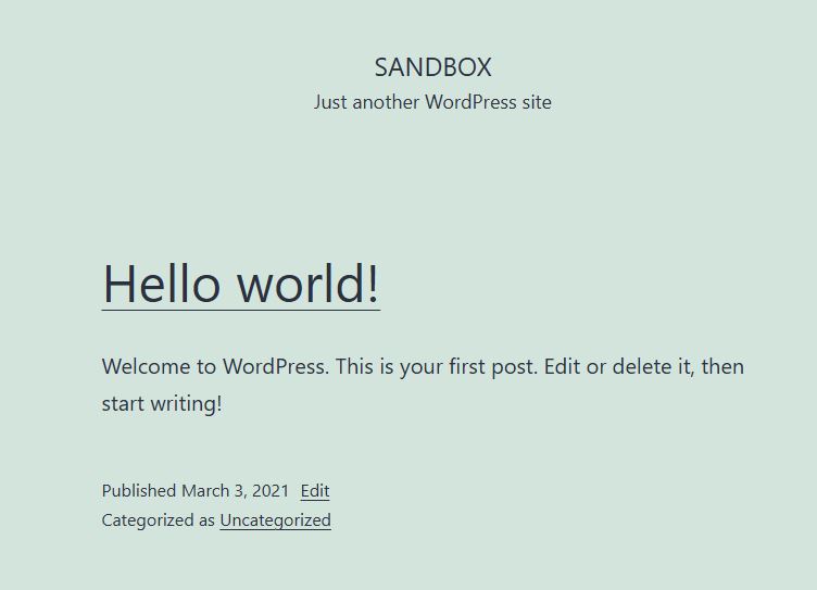

October 14, 2025 at 4:34 pm #17484915
If you click on the link, you will be logged into a test site.
Please try to recreate the issue with the "Dual Color Heading" and let me know if you can confirm the same issue there. Make sure to use the same field values and settings, as for now, I could not confirm any issue regarding this widget.
Note, I already escalated the image issue to our compatilbity team, too. They will try to reach the author about it.

As for the link you had sent me, here is what it goes to (attached image).
Since I still don't get it, I chose to try another widget that I have purchased to give be the Dual Text.
Since it is from Unlimited Element For Elementor as well, I will be able to get BOTH tech support to match WMPL.
Thank you again, Andreas!!!
I look forward to a happy resolution 😉
Have a great day!
October 14, 2025 at 4:50 pm #17485013
After clicking on the link, you can go to hidden link to access the backend.
You said that the "Dual Heading" widget is also causing issues.
Please create a new page with the widget or widgets that are currently causing issues on the site. Try using the same settings and confirm if the issue will also exist on this test site.
Or provide more details, or screenshots, and I can assist you in trying to recreate the issue.
