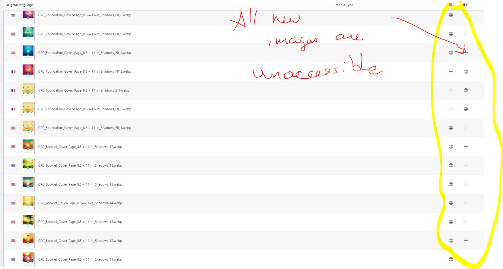

Now that the 3D Flipbook is solved, NOW I still can't have access to some newly uploaded images from yesterday (see attached images).
Can you please find a permanent fix with the access I provided you.
SiteGround didn't understand what you had written regarding JavaScript conflit so they could do anything with the info.
Here is the issue again.

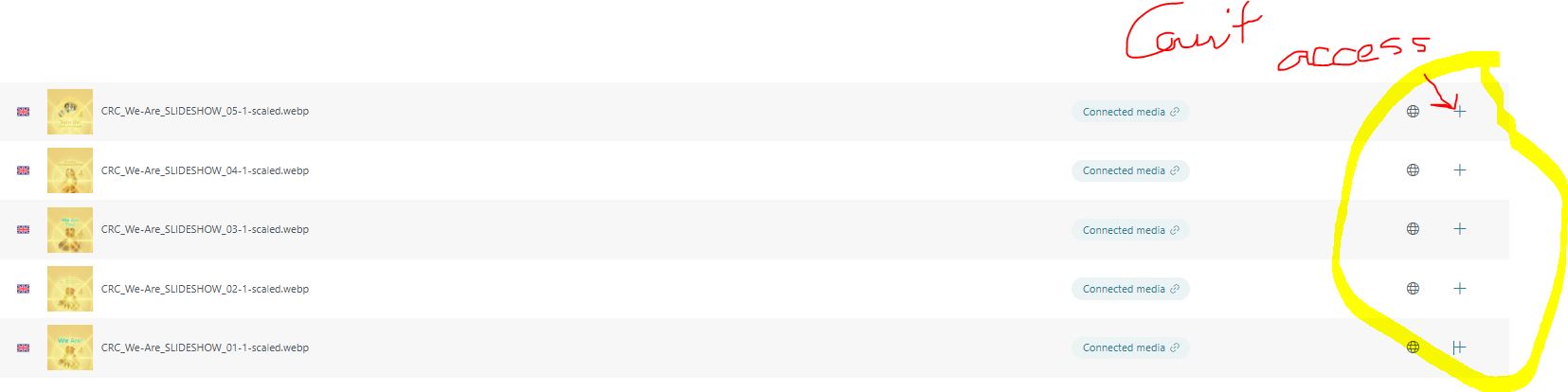

sachaJ
CORRECTION:
All of my new images since yesterday are all blocked from updating the media translate button

November 7, 2025 at 3:01 am #17555877
Your site seems to be fine after clearing the SiteGround cache:
I tried to disable the Speed Optimizer - Media Features on your site, but this does sadly not solve the issue.
Even after disabling "Speed Optimizer" and "Security Optimizer" the error still occurs:
Uncaught TypeError: Cannot read properties of null (reading 'siteground_optimizer_compression_level')
I then randomly deactivated some plugins and synced the media again. At this point, the issue seems solved, as this error only occurs if the media was not yet synced.
At the moment, the issue does not occur, even when I upload a new media file.

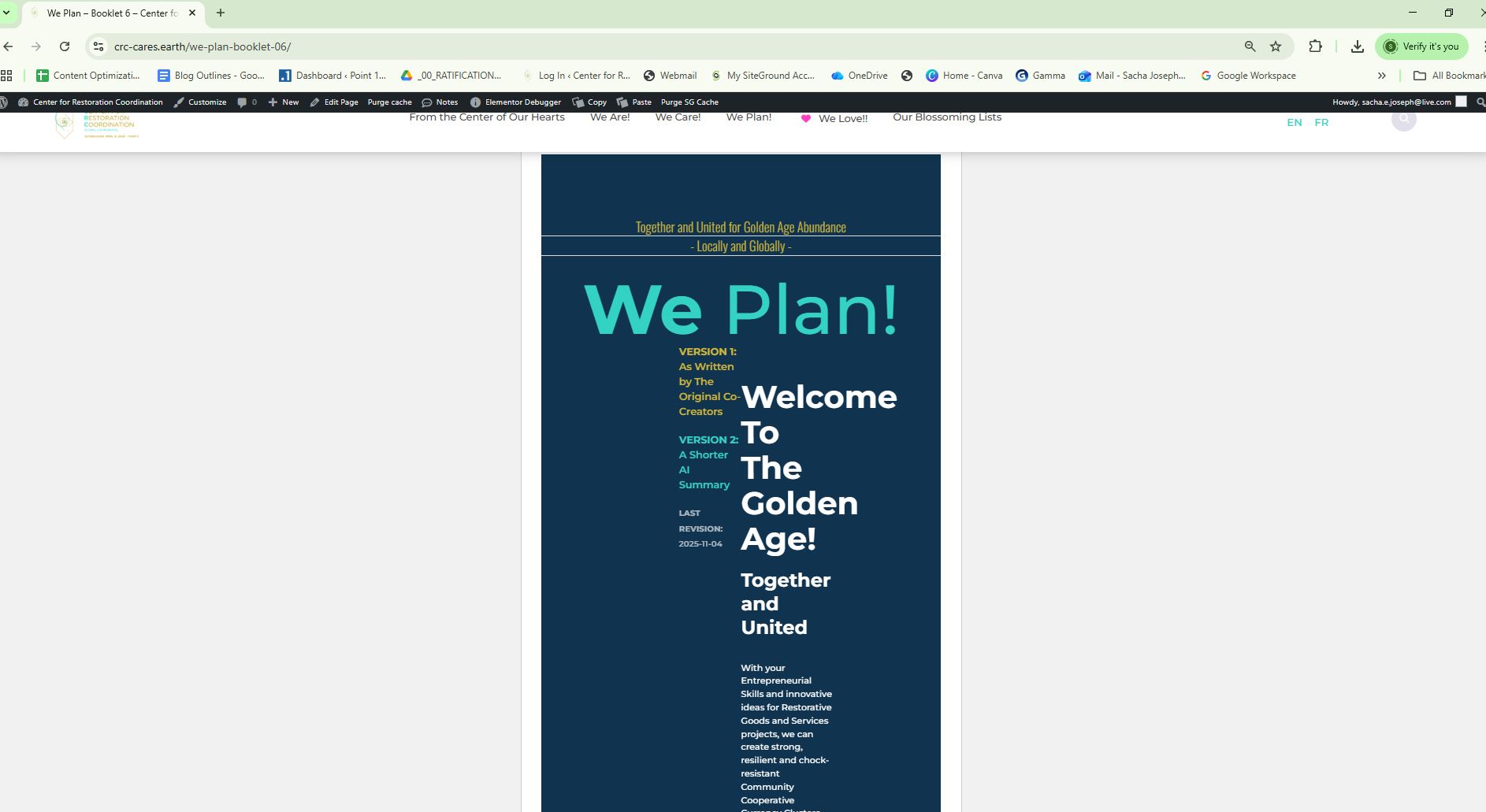

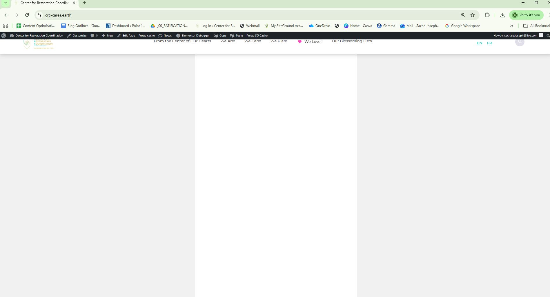

November 7, 2025 at 1:22 pm #17557317
sachaJ
HI Andreas,
Thank you for the clarity on the plug-ins.
As for my site blank page errors (images attached), SiteGround solved today (the problem occurred when I was trying to match my Media Translation with the Media Library so as NOT to have duplicate images)
BUT below is the info from SiteGround;
I’ve identified and resolved the issue that was causing your website to display a blank page.
The problem was coming from a compatibility issue between the WPML Page Builders add-on and Elementor. Specifically, WPML includes a function that processes Elementor’s display conditions using JSON decoding. However, after a recent Elementor update, the data being passed to this function changed format — in some cases, it was already an array instead of a JSON string.
When WPML tried to run json_decode() on this array, PHP threw a fatal error, which caused the page to stop loading completely (resulting in the blank page you saw).
The exact error logged in the php_errorlog of the website was:
[07-Nov-2025 05:05:15 UTC] PHP Fatal error: Uncaught TypeError: json_decode(): Argument #1 ($json) must be of type string, array given in /home/customer/www/crc-cares.earth/public_html/wp-content/plugins/sitepress-multilingual-cms/addons/wpml-page-builders/classes/Integrations/Elementor/Hooks/DisplayConditions.php:108
Since $conditionJson was sometimes an array, PHP failed with a TypeError.
I modified the function to safely check whether the data is already an array before attempting to decode it. This prevents PHP from throwing an error and restores normal page rendering.
After applying this fix, the blank page issue was resolved, and the site is loading correctly again.
