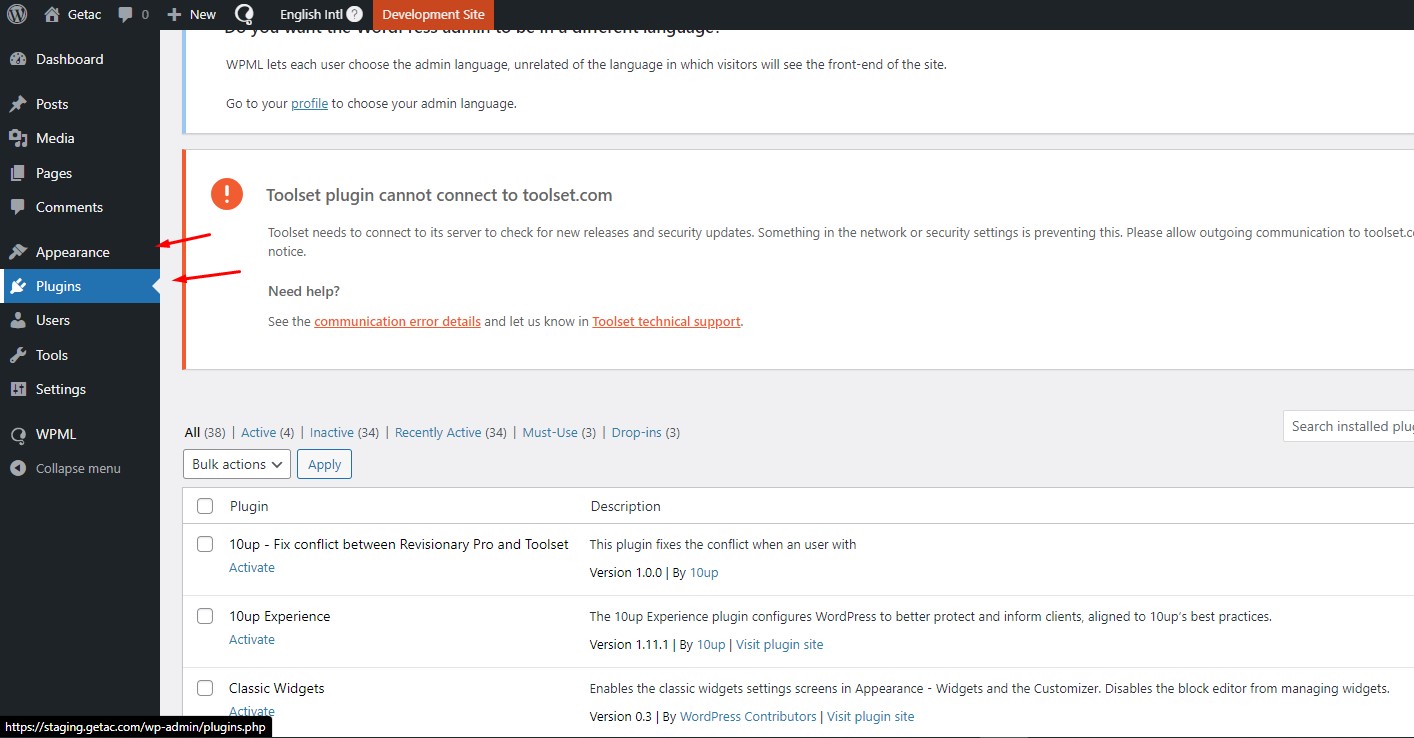

I checked and I see there are still some plugins active and some backend options hidden, so I suspect something is more involved here.
I also see you have some custom roles which might be the reason for this.

Something has changed the capabilities of the role, either by code, some plugin or etc.
For example, I do not have access to the Theme file editor, or plugins > Add new, so this role doesn't have default role capabilities by WordPress.
This also has not added all the needed WPML capabilities for this role and causing issue you have reported. You can try adding all from the URL I shared in my last reply.
Otherwise, I would need to test and further check this, but you need either to reset this role capabilities so I have default WP admin access or provide FTP access.
