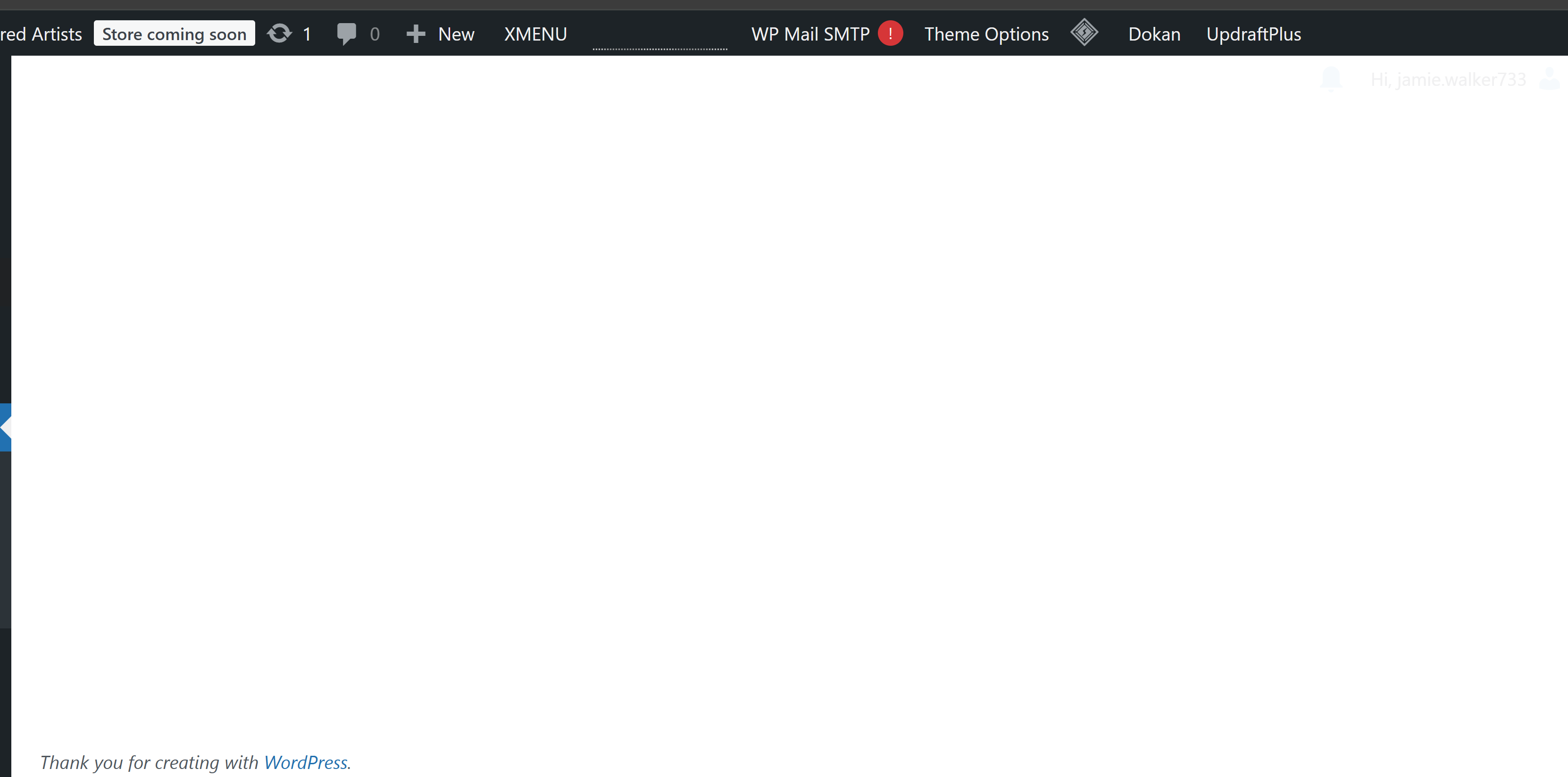

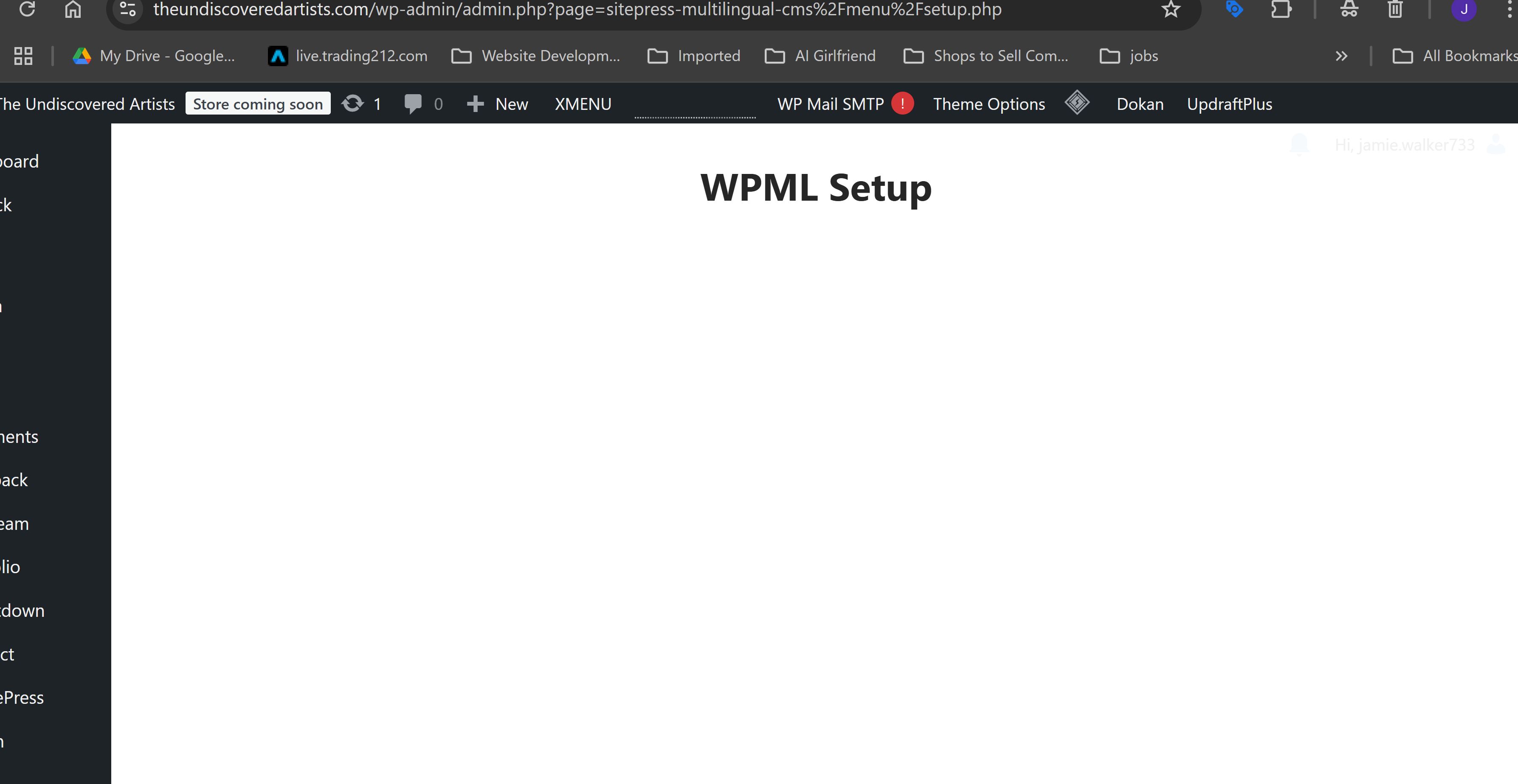

I am trying to set up WPML on a site that is currently under development. I am following the setup guide.
I encountered a white screen during the setup process.
I'm stuck at setup, all i get is WPML setup and a white page?

The issue persists after the initial checks. So, I have created a copy of the site using Duplicator for detailed debugging. We will continue investigating and get back to you as soon as possible. Please wait.

We were able to reproduce the bug in our local copy, and the issue persists after following all the troubleshooting steps. Unfortunately, the available workarounds did not resolve the problem.
So forwarded the ticket to our second-tier team for expert analysis. We will keep you updated as soon as we have further information. Please wait.

This issue seems to be caused by a corrupt entry in the database. Have you used WPML on this site before? We noticed multiple language folders inside the *wp-content * folder.
We were able to get the expected results in our local copy after following some steps.
Please try the same steps on your end after taking a full site backup (mandatory) and let us know your feedback.
1) Visit WPML >> Support >> Troubleshooting
2) Select the WPML Reset action
3) Deactivate WPML
4) Log in to your database using a tool like PHPMyAdmin
5) Run the following query and delete all the matching records
SELECT * FROM `wp_options` WHERE `option_name` LIKE '%wpml%'
6) Clear all types of caches
7) Activate WPML and configure it
Refer to this article for more details: https://wpml.org/documentation/getting-started-guide/language-setup/deleting-languages-and-plugin-data-by-doing-a-wpml-reset-on-your-site/#step-3-do-the-wpml-reset
