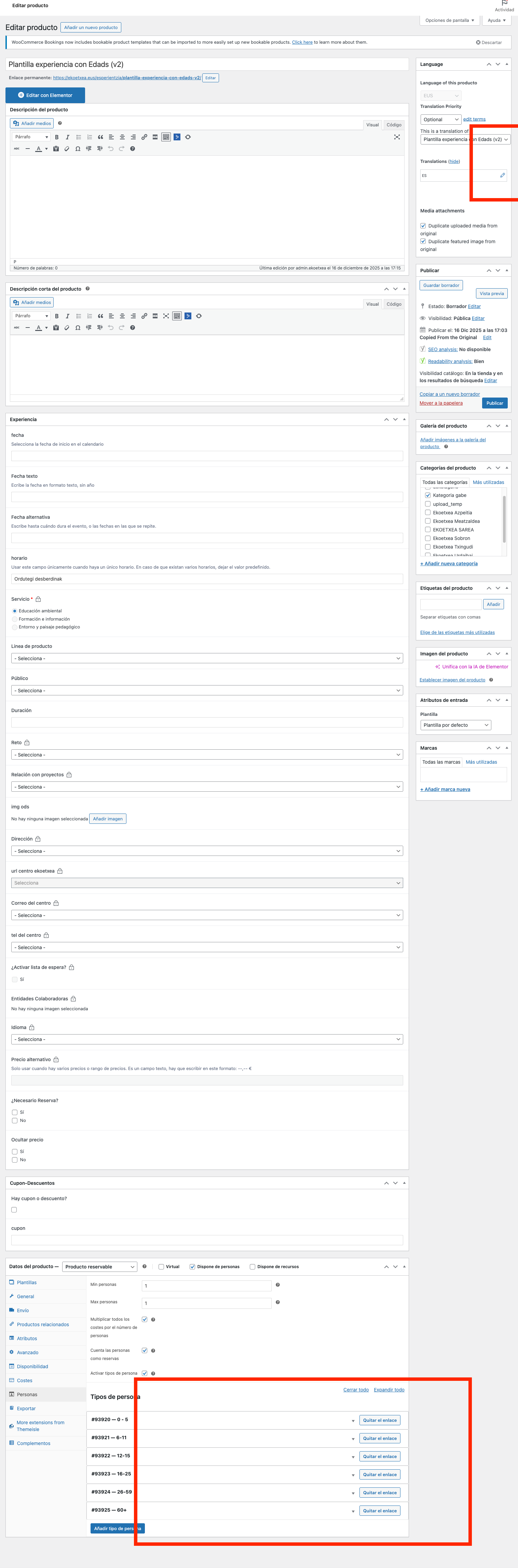

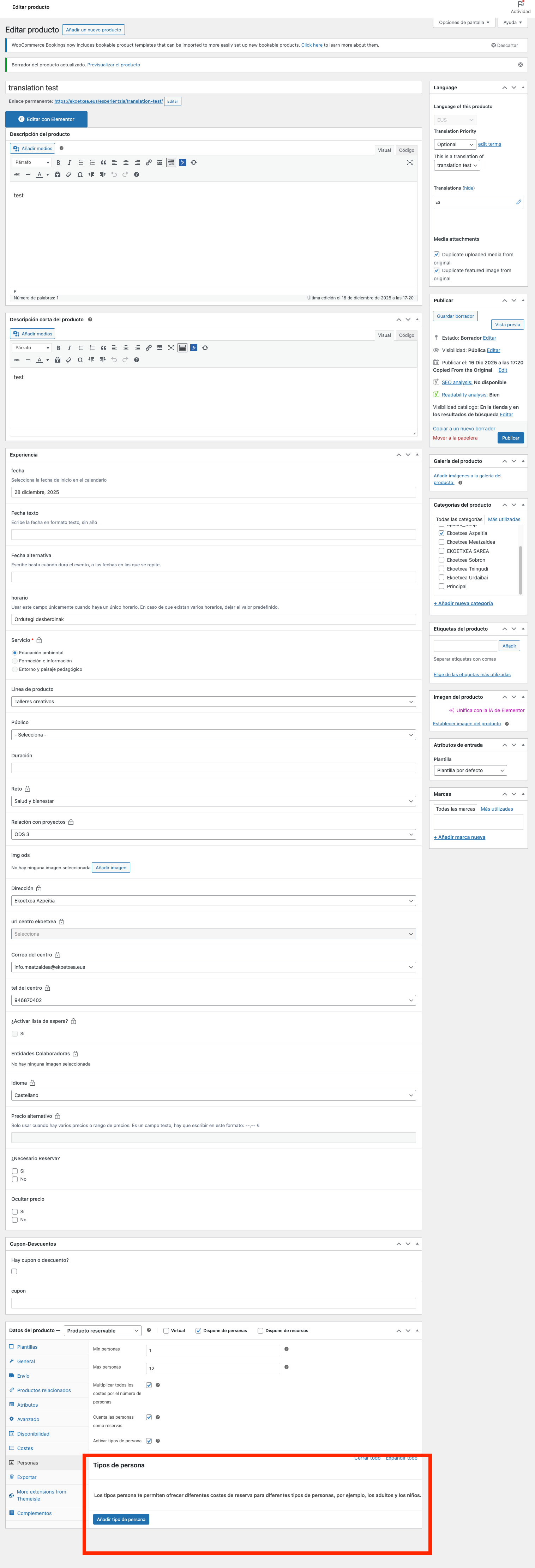

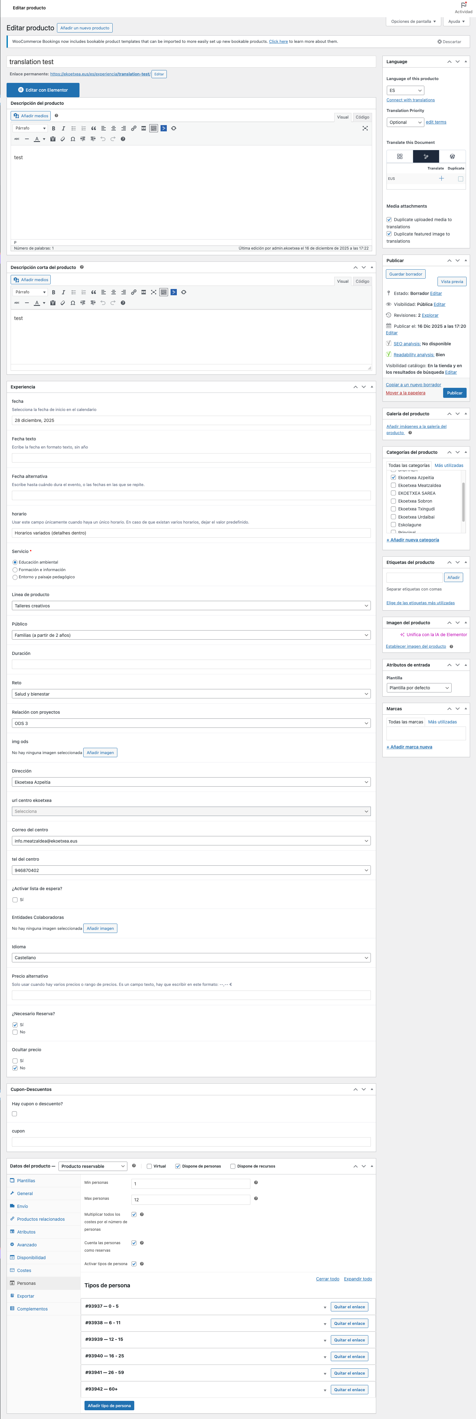

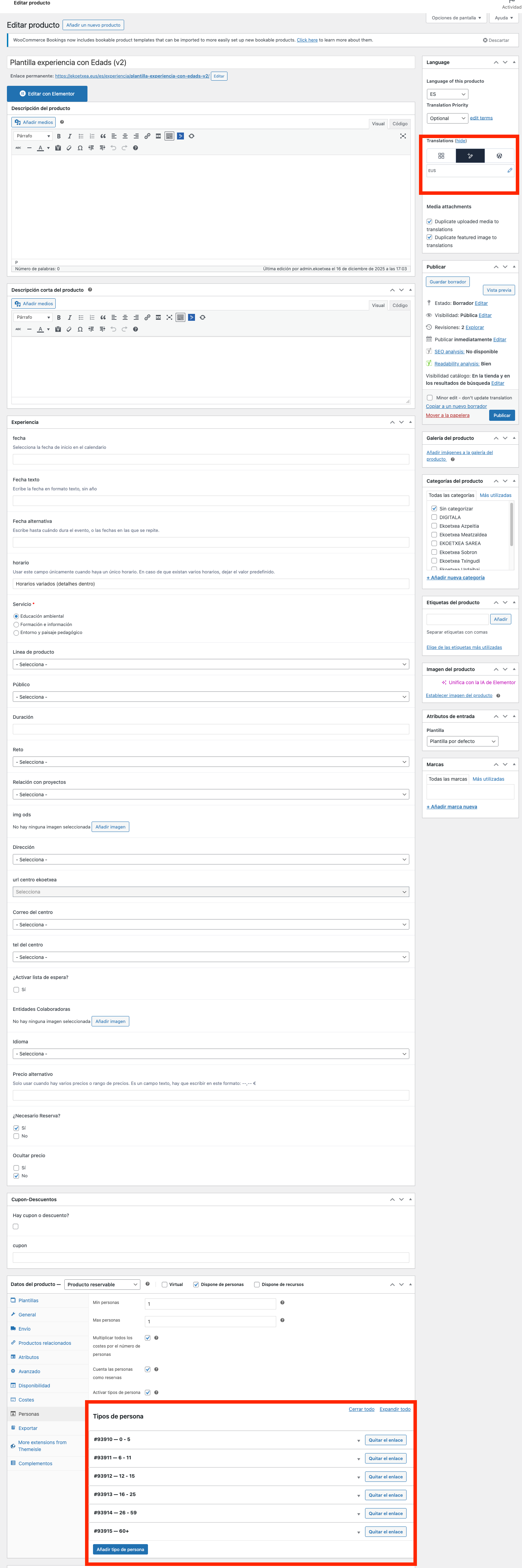

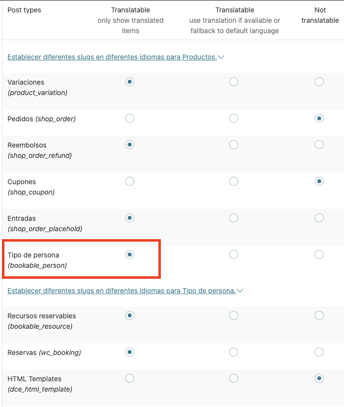

After recent updates, my products (bookable) stopped making the translations correctly.
Now, fields like availability and bookable persons, are not sent over to the translation.
One one hand, i use a template, that before the update, added the translation automatically after saving as draft, and now it doesn't.
On the other hand, even if i add the translation manually, it still doesn't add the bookable persons.

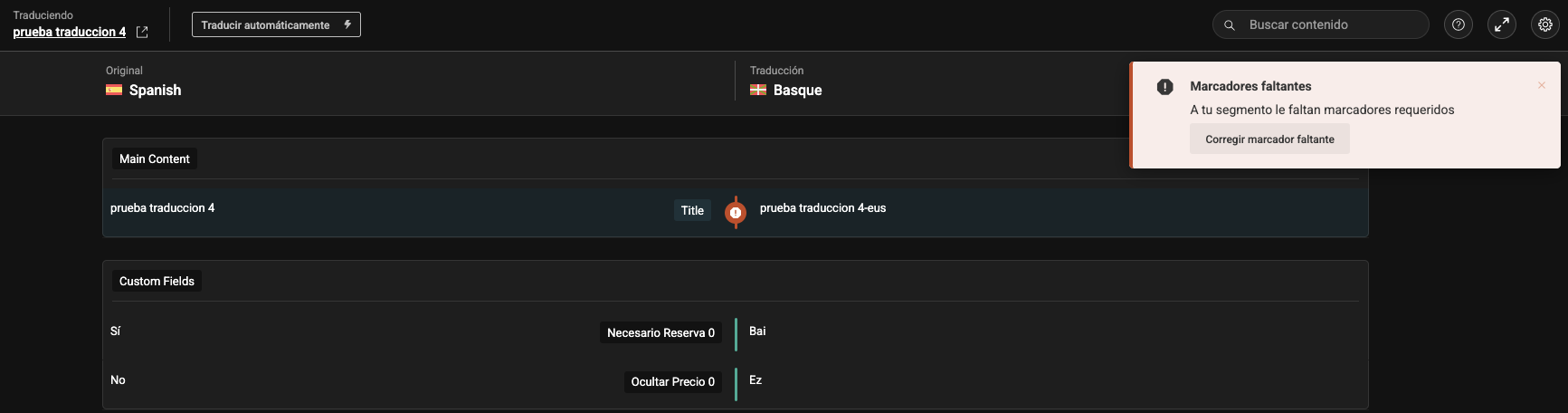

On another note, i also noticed that when i try to use the wpml editor i always get an error that i cannot understand or fix : "Missing markers. Your segment is missing required markers". I get it with simple text strings, no markers...
Attached are screenshots of the issue and of my current settings

rafaelF-23
About the wpml editor, i still have that error: hidden link

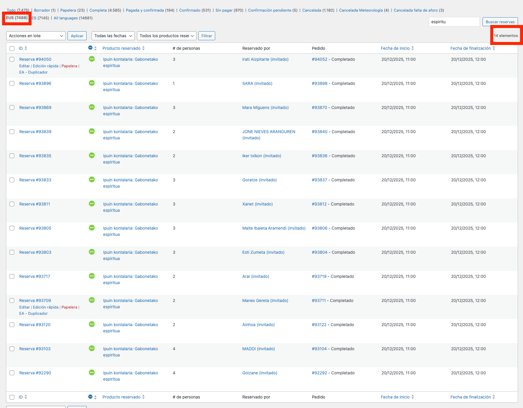

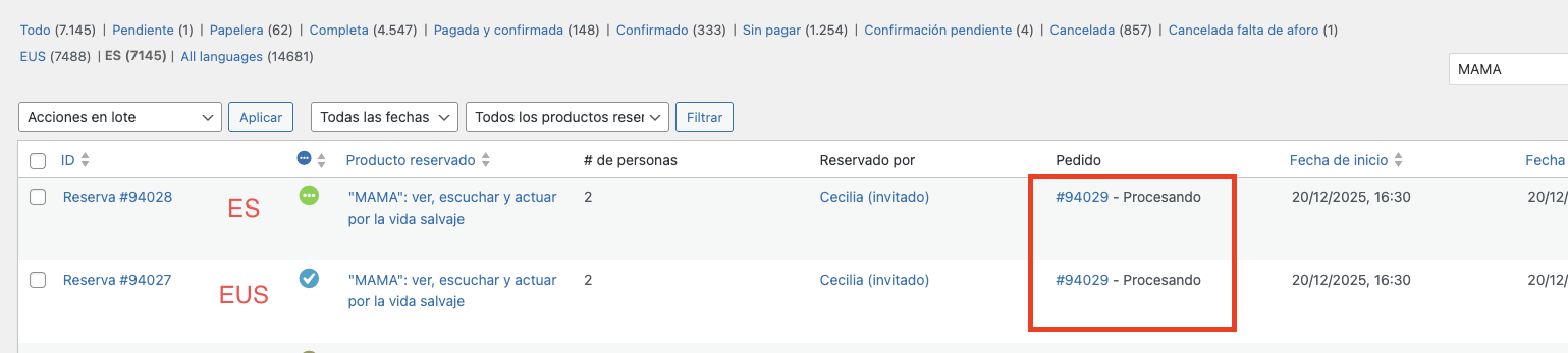

You have admin access and should be able to see all those options. If you can't, maybe i can share a temporary login link if you allow e to send it privately.

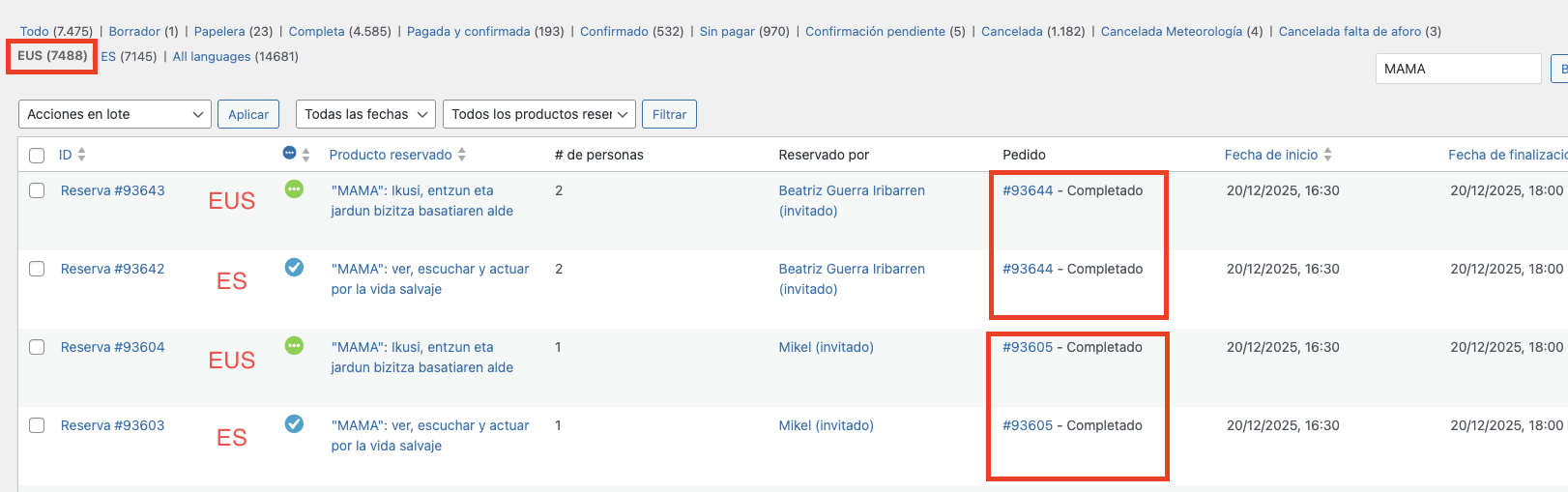

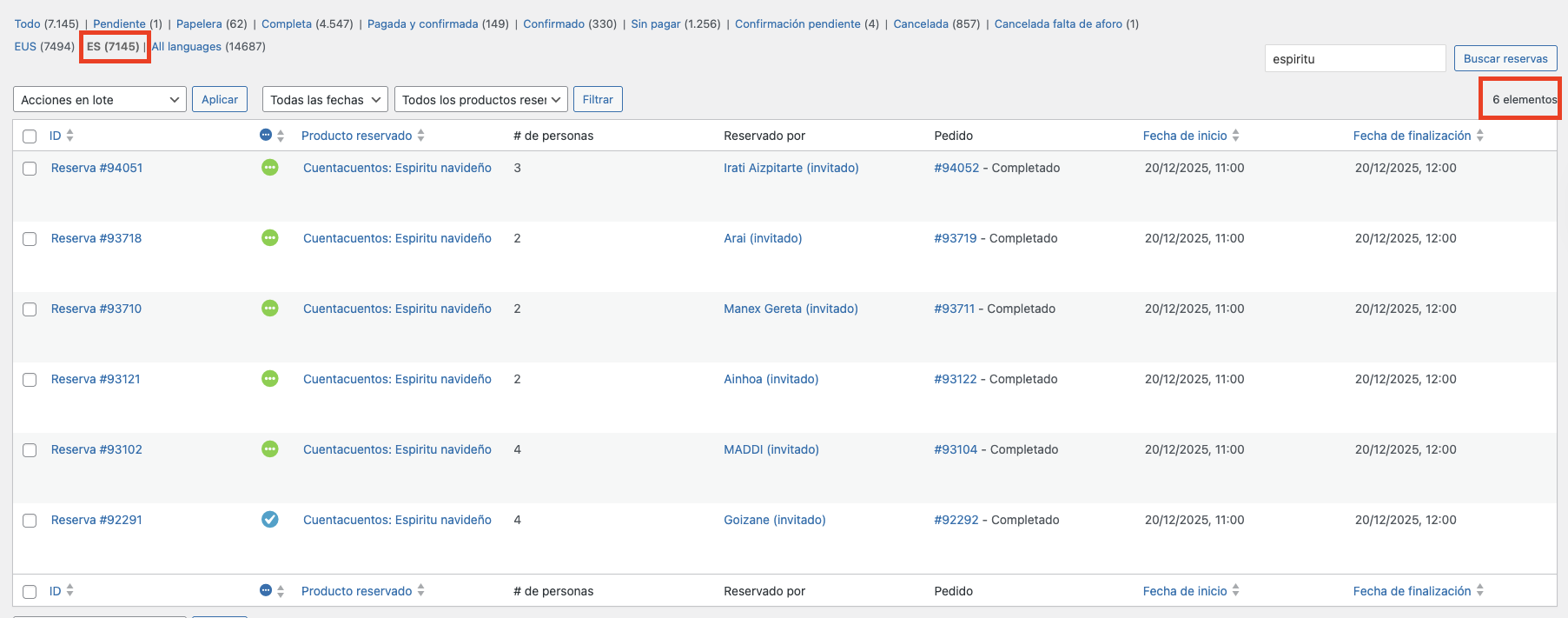

In this case i'm no longer talking about products, but bookings.
Case 1: bookings that don't generate a translation
Case 2: bookings that generated a translation but are not linked

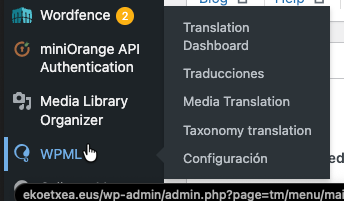

1) Please check the attached screenshots to see my view of WPML, and when I try to enter the URL manually.
