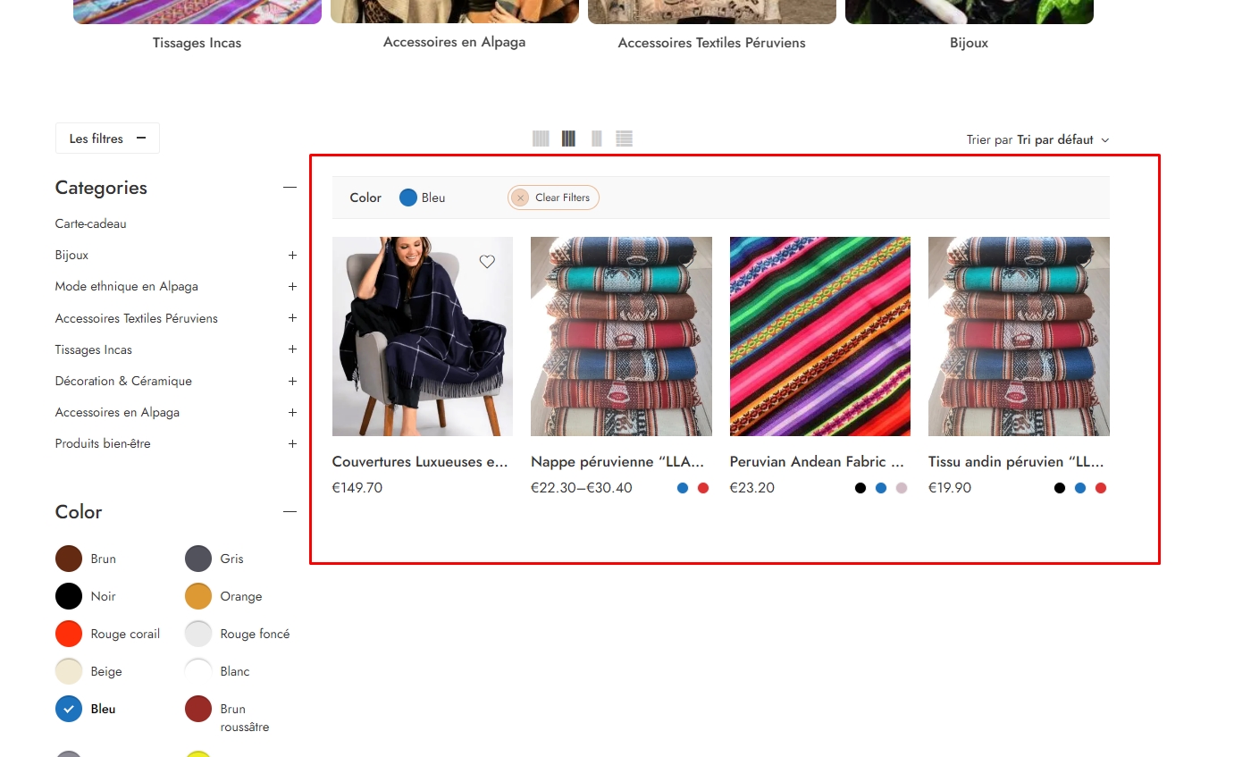

In my woocommerce store with three languages, the color filter on the shop page shows the products with the chosen color, however, in the additional languages, it only shows one or two of the total products
You can see the difference here (original version):
French version:
I had already opened a ticket about this, but the error still persists. They recommended that I go through troubleshooting and then update the products. It worked with one product but as minutes or hours passed, they disappeared again from the filters in the additional languages.

Hello. Thanks for your answer. Yes, we have already tried it. The products have the correct configuration. As mentioned in the previous description, when updating the products (recommendation from the WPML team) the products sometimes appear in the filter, but then they stop appearing. That is, as if no solution had been applied.

Thank you for providing the credentials. Upon inspection, I noticed that the term 'Blue' was giving proper results in both the English and French versions of the staging site. However, the term 'Orange' did not produce consistent results between the English and French versions.
However, after making some adjustments, I was able to get the correct result in both versions of the site. Please try the following steps and I hope it will help.

Thank you. It seems to be working correctly now. I only performed step two: "disable table usage option", this because I have configured the permalink without the "product" slug by default, for SEO reasons.
