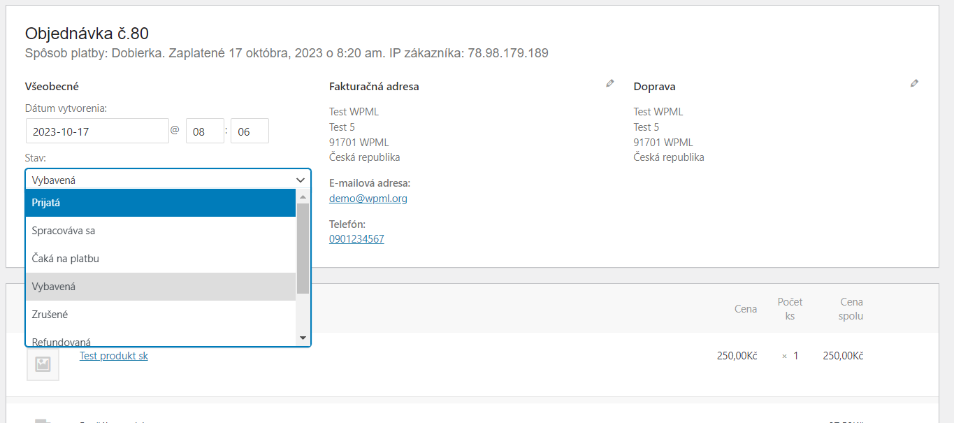

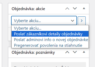

it is simple to reproduce. Change status on order detail page to trigger any wordpress default email or manually trigger order action. You can see in attacments.
Then go to email log plugin to see captured email message. Or you can create new order with existing email to see in your inbox.
Note, thah first email order created is with correct logo. Problem apears when you change order status or trigger manual action in admin area.

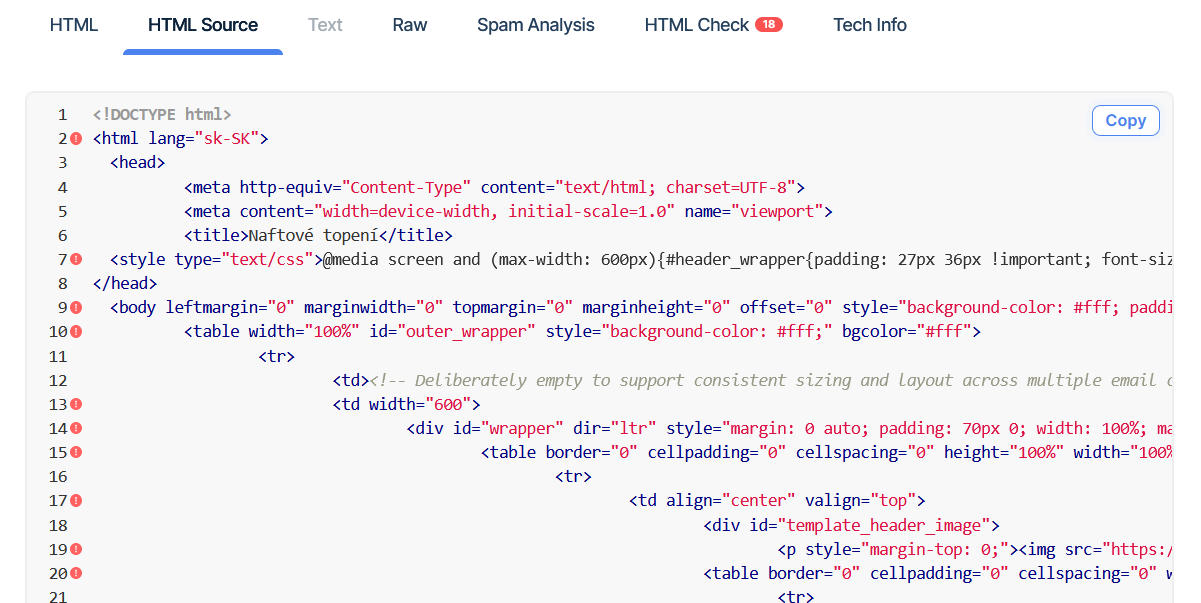

I also found, that language_attributes() function in default wc email header template is also printing worng language, but this you can not see in email log only when you send mail to real adress or via mailtrap. Can you please find solution for this also?
It seem that whole template email header it not translated. Can you check it with you team?
Thanks for reply.
October 24, 2023 at 7:57 am #14643377
Bruno Kos
The first issue is simply a bug that is escalated to our developers team but is not yet resolved.
As for that other issue, can you send me a screenshot from email as you receive it into inbox or through mailtrap?
October 24, 2023 at 9:53 am #14645525
andrejO
as you can see in image the lang attribute is in wrong locale.
