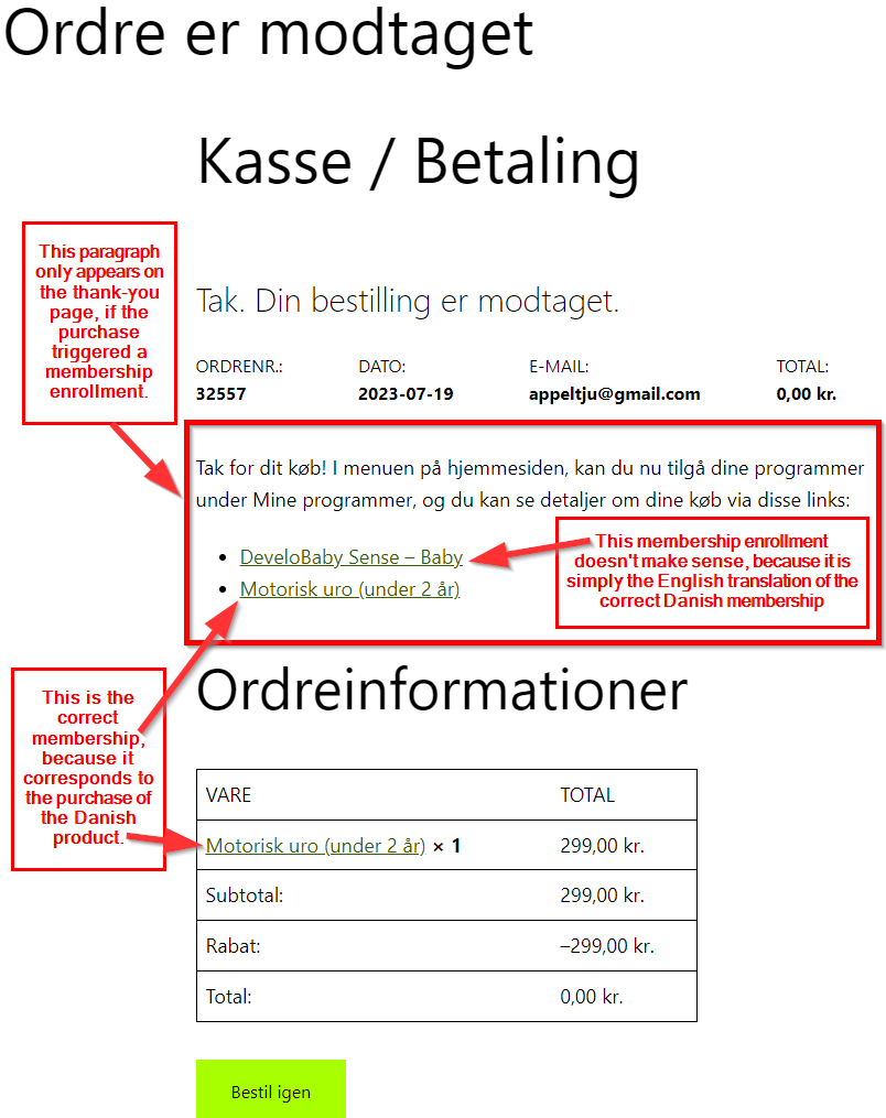

My website uses WooCommerce and WooCommerce Memberships. Customers are enrolled in Memberships, when they purchase a corresponding product. I translated the WooCommerce product, the Membership plan and the page that the membership plan grants access to.
Now, when buying a membership product in the main language, the customer is enrolled in the corresponding membership (expected) and also enrolled in the translated membership (not necessarily expected).
The real problem is this though: when buying a *translated* membership product, the customer is *not* enrolled in any memberships (definitely not expected) and I can't figure out why.

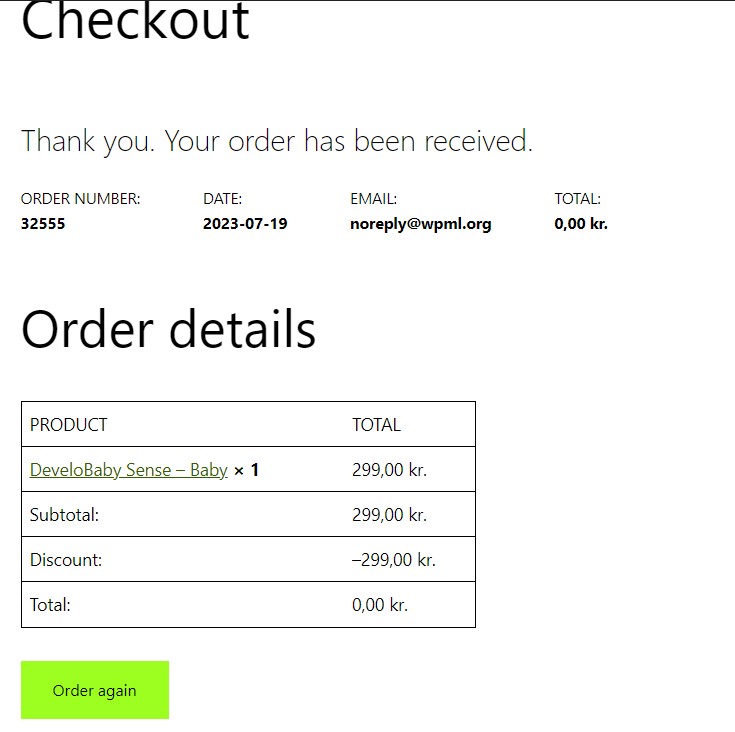

Unfortunately, I cannot confirm that it works now. As a matter of fact, the behavior is exactly as originally described above, i.e. I see two memberships, when ordering the Danish product and I see no membership at all, when ordering the English translation of that product.
My guess is that you confused yourself by not cleaning up your orders before testing orders in different languages. Your screenshots even confirms that. If (and only if), the order process works correctly, then the Thank-You page will contain an extra paragraph describing, which membership your account was enrolled in due to your purchase. None of your two screenshots contains that paragraph. Please see the thick-bordered red box in my screenshot for details.
For your further testing, please note these mechanics:
- if you purchase a trigger product, you will be enrolled in the corresponding membership.
- if you already are enrolled in that membership, then you will not be enrolled again and the thank-you page will thus not contain the special "membership paragraph" (see my screenshot, pls).
- it is therefore important that you remove your orders AND your memberships from WooCommerce in between test orders.
For details on how to remove orders and memberships, please refer to my howto sent along with the temp. login link in my previous (private) message.
Thanks again for your help!
Maria

- Visit store in Private Mode and purchase product in ENGLISH language using coupon code "vip" (just to make test checkouts faster)
-- Note: on thank you page, there is no membership mentioned anymore. This is not expected! I would expect that I am enrolled in the English membership "VIP Membership EN".
-- To confirm, check WordPress backend, under WooCommerce Memberships: and yes, there are no memberships despite the purchase of the English Trigger product

I did test this in your sandbox and I see a row of problems - did you apply the above work arounds to the sandbox?
I'll describe, what I see step by step:
Step 1:
I removed the existing membership and its translation. Then, I created a new membership plan "VIP Membership Plan Manual" that does not depend on a trigger product, ie. the only way to become member in this plan is to be assigned by an admin. Under "Restrict Content", I only chose the membership page in the first language, but not the translated page. I created this plan to test how memberships are handled by WPML independently of the extra complexity of trigger products.
Observations:
Note, that I have not translated the membership plan yet, but yet reviewing the membership plan configuration, I can see that under "Content Restriction", there are now four pages listed, namely "Membership Contents (60)" (twice) and "Membership Contents EN (62)" (also twice). This is unexpected! Only "Membership Contents (60)" should be listed and only once. I suspect that the translated page is listed, because it is not filtered away (similarly to your above work-arounds), and that all pages are eventually listed twice, because two languages are configured in WPML language settings (but I haven't tested either claim).
Step 2:
Now, I translated the membership plan "VIP Membership Plan Manual" to "VIP Membership Plan Manual EN" and double checked that the slugs are different.
Observations:
Looking at the settings of the translated membership plan in the back end, I can see that there is nothing listed under "Restrict Content". That is not expected. I would like to see "Membership Contents EN (62)" to be listed here.
Step 3:
Under WooCommerce, Memberships, Members, I clicked "Add Member" and added "Maria" as member and enrolled this user to "VIP Membership Plan Manual (#100)".
Observations:
When enrolling "Maria" in a membership plan, I could choose between "VIP Membership Plan Manual (#100)" and "VIP Membership Plan Manual EN (#101)". This is not expected, as I believe the translations of a membership plan should be handled transparently, ie. I would only expect the membership in the first language listed here. Also, after publishing the enrollment, I am only enrolled in the membership plan "VIP Membership Plan Manual EN (#101)", but not in its English translation. I would think that this is unexpected, because enrollment in the membership plan in the first language should trigger automatic enrollment in all translated memberships, too. But let's see, how things look in the front end.
Step 3:
Logged on as "Maria" in private browser, I checked out the membership under my-account:
Observations:
On the front end, under my-account, I can see the membership plan in the first language, and nothing else. Expected! I can also browse the content page at hidden link. Expected. Scrolling to the bottom and choosing English, I get a 404 (ie. I don't have access). This is most definitely not expected, because customers should be able to switch language, once they bought a membership (in any language). It is also not expected, because the membership plan did specifically list all translated membership content pages under "Restrict Content" (see observations under Step 1).
Step 4:
Now, I unenrolled myself from all memberships and enrolled myself in the translated membership "VIP Membership Plan Manual EN (#101)". I want to see, if I get access to the correct pages.
Observations:
On the front-end, under my-account, I can now see the enrollment in the translated membership plan, but the plan has no content, which (kind of) makes sense, because that is what we saw under observations in step 2. Curiously, I do have access to the translated membership page at hidden link, but not to the first language page at hidden link. Again, not expected.
Step 5:
Just to see, what it would look like to be automatically enrolled in all translated memberships, I enrolled myself manually in "VIP Membership Plan Manual (#100)" and also in "VIP Membership Plan Manual EN (#101)".
Observations:
Under hidden link I can now see that I am enrolled in two memberships. I sort of expect this, because I enrolled myself manually in first and second language membership plans, but normally this shoudn't happen. I expect that only the membership plan that I was originally enrolled in, would be listed here and the translated membership plan enrollments are handled invisibly in the background. Yet, I have access to both membership content pages now. This is good.
I might misunderstand the basic concepts of how WPML handles memberships plans. I noticed that memberships as listed at hidden link can have translations, too. So perhaps being enrolled in one membership plan, should result in me becoming member of that plan, but also member of all plan translations, however via automatically translating the membership rather than being enrolled in all translated membership plans? Either way, in its current state WPML does not work for WooCommerce Memberships - not even without trigger products.
