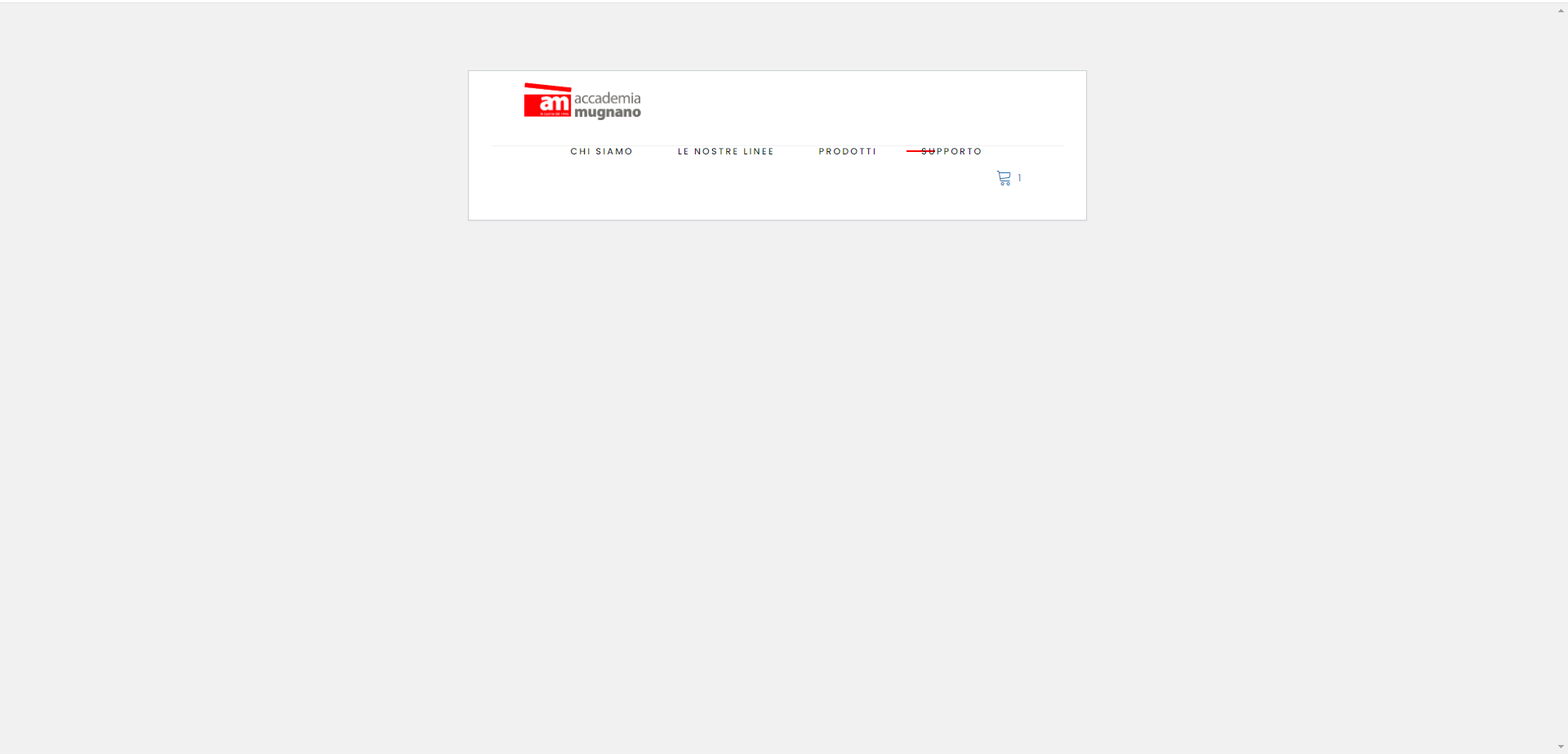

We are currently in the process of translating our website. The plugin is working fine, but we are having a problem with 'WooCommerce Multilingual & Multicurrency'. Whenever we activate this plugin there seems to be no problem. However, when an item is added to the shopping cart, the website doesn't display anything: hidden link. At the moment we keep this function disabled as we do not sell outside Italy at the moment. However, we need this plugin because the account page is managed by WooCommerce and not being translated means that the endpoints are not applied (for example, the voice 'orders' just refreshes the page).
When an item is added to the shopping cart, the website doesn't display anything.
Why does the website not display anything when an item is added to the shopping cart with 'WooCommerce Multilingual & Multicurrency' activated?
How can we ensure the account page is translated and endpoints are applied correctly?
