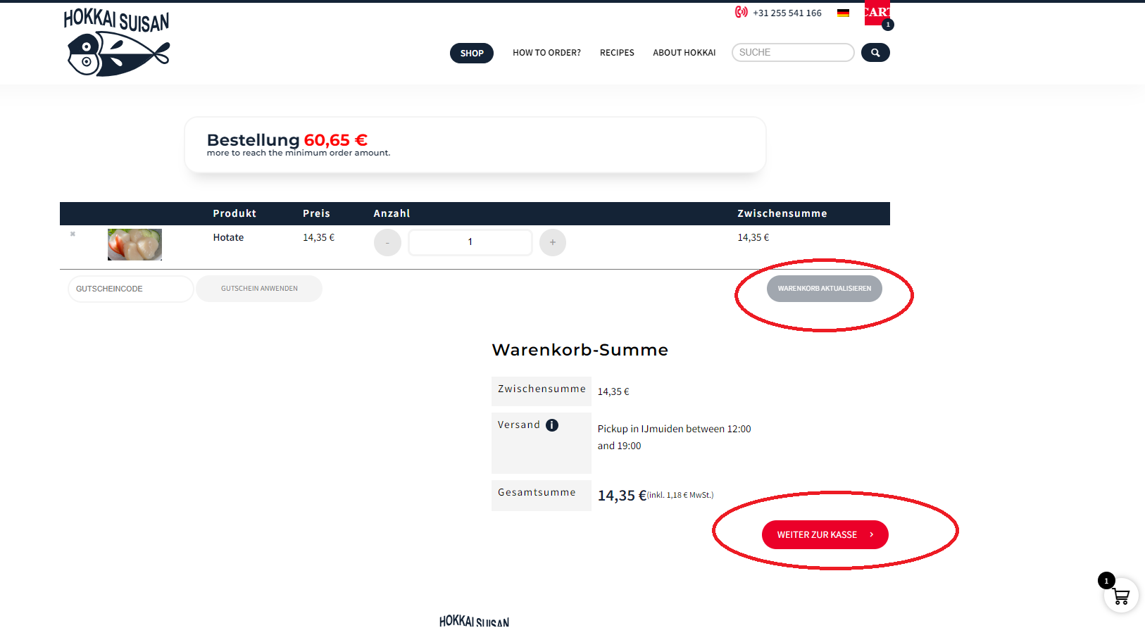

Some time ago a client asked us if we had done something on the website hidden link. The client said that some translations were missing on the checkout page. The strings are translated in WPML but all of a sudden they do not show anymore. And expecially on the checkout page of WooCommerce.
We have tried to solve this problem and tried everything but the translations don't show. Is there anything we can do to get this working again? As far as we know nothing has changed.

Thank you for your reply. I tried what you suggested but it is not working. The strange thing is that most problems occur with common WooCommerce strings. For example the string Proceed to checkout on the cart page: hidden link And the strings on the checkout page: hidden link. Nothing is translated anymore. And I have no clue why it is not working anymore.
I tried to clear the cache. Including the WPML cache. I purged the CDN. I tried to safe the strings again. But to no avail. And I tried your suggestion. But the translations won't appear.

February 9, 2024 at 4:00 pm #15286916
Mateus Getulio
Hello there,
I'm checking the site and the issue seems fixed. Please check the screenshot.
Did you manage to fix the issue on your end?
Thank you, please let us know.
