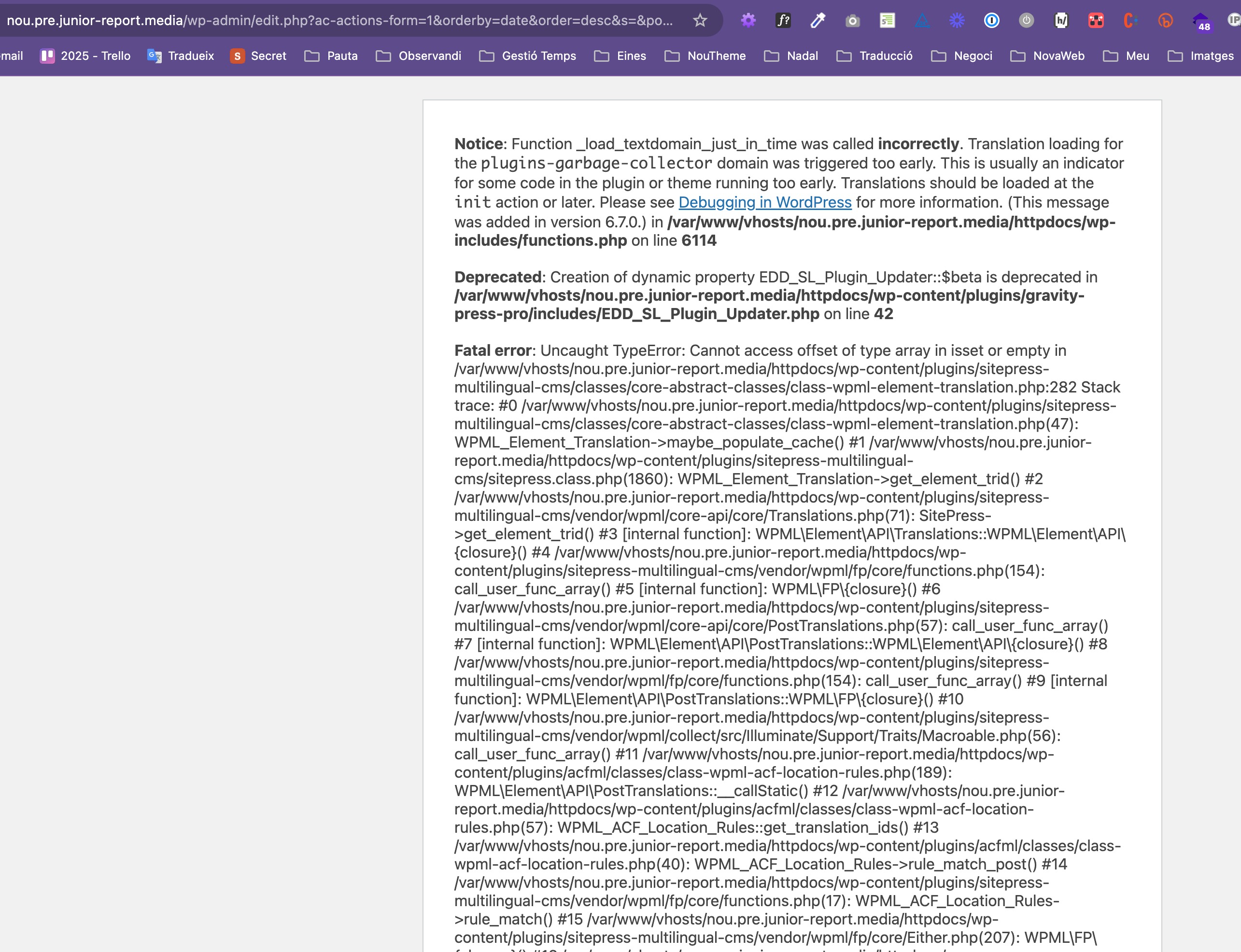

I am trying to bulk edit a group of posts with the bulk edit tool from WordPress when Advanced Custom Fields Multilingual is active. You can only see this in the admin of hidden link. This issue is coming from a database just migrated from the production site. In production, this problem is not occurring. But in this staging site, we have added new ACF field groups from JSON files that come from my local development site. This will be the new version of the site, with a new theme.
I got a fatal error: 'Fatal error: Uncaught TypeError: Cannot access offset of type array in isset or empty in /var/www/vhosts/nou.pre.junior-report.media/httpdocs/wp-content/plugins/sitepress-multilingual-cms/classes/core-abstract-classes/class-wpml-element-translation.php:282'.
The issue only occurs when Advanced Custom Fields Multilingual is active. If I deactivate it, no issue. I have reviewed the ACF field groups and resolved two warnings about not setting the language translation, but the problem persists.

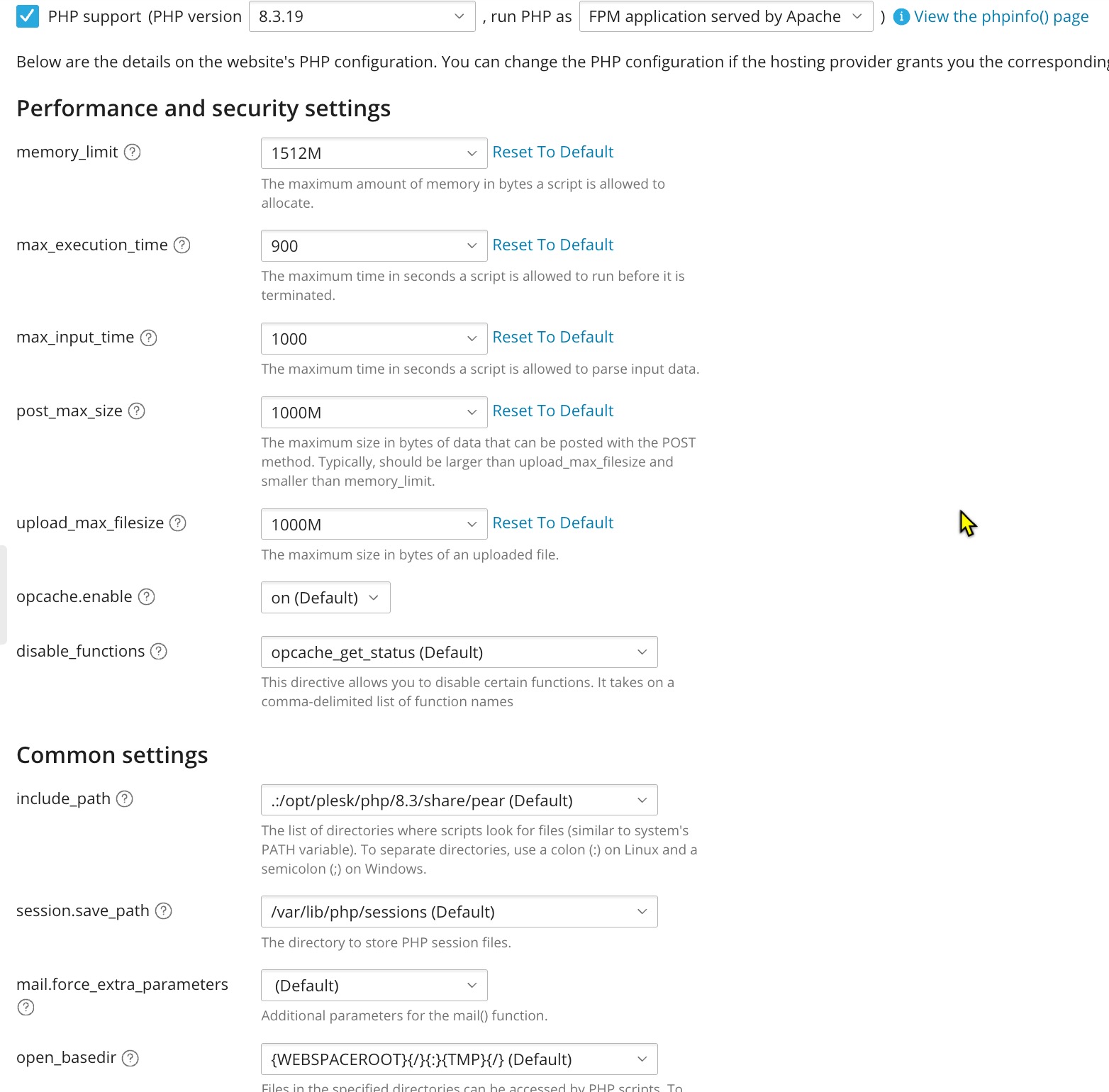

About memory limits, I have changed them directly in the server, trhough Plesk, yesterday. But I have changed the wp-config.php also as you reclaim.

I add an screenshot from the settings on server.

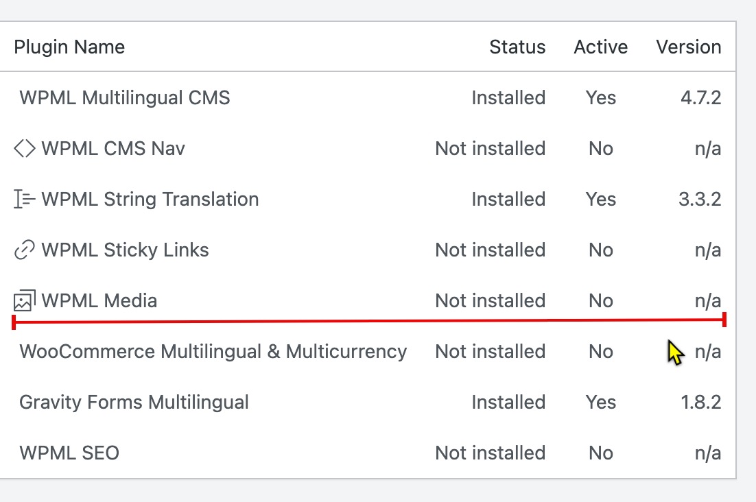

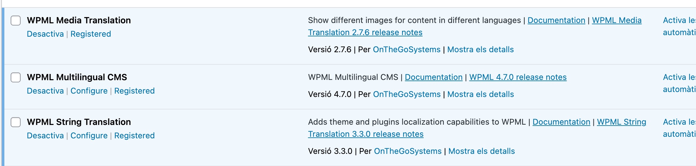

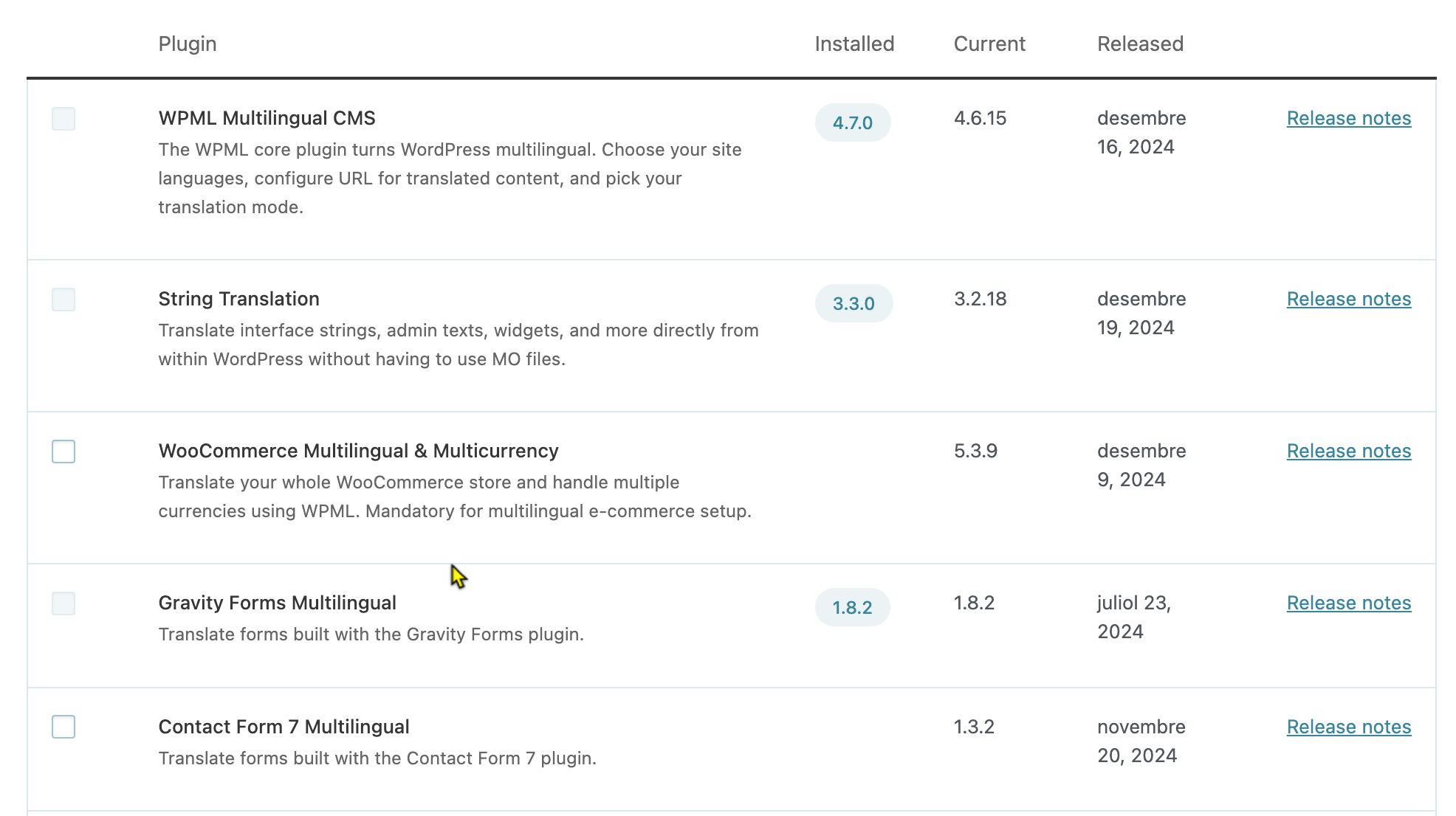

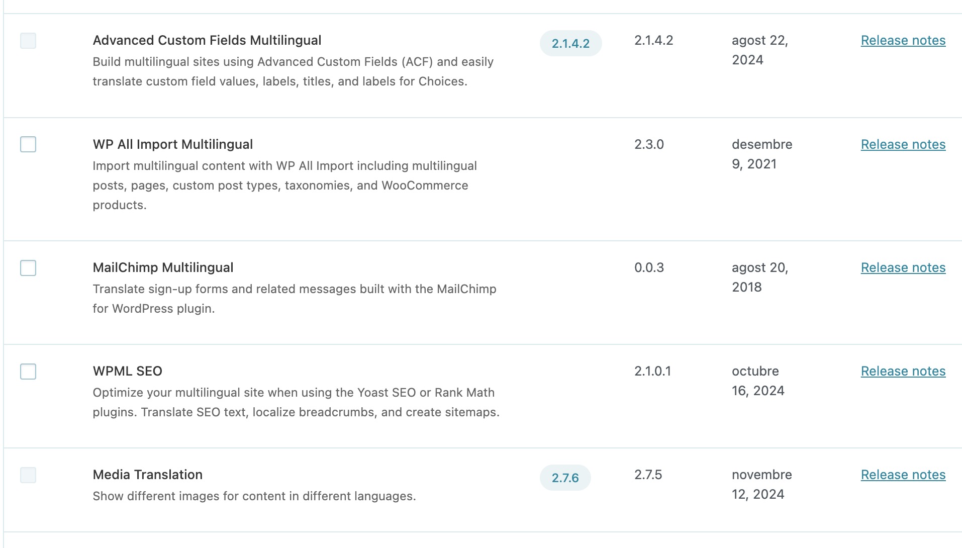

I have to tell that I couldn't update yours plugins because they didn't appear to be updatables. First image is a print screen from the commercial tab, where you can see how there was not installed the latest version, but it's not askng for updates.
In second image you can see also the others wpml plugins in same screen.
Then, third image show the plugins list page, where wpml plugins are not telling the have to be updated. May be this is normal now, but I found it rare.
In forth image, I show you what is displaying in WPML Support Page, after update the fourth plugins. You can see that WPML Media seems not to be installed, but it is, as you can see in third image. Is this normal?

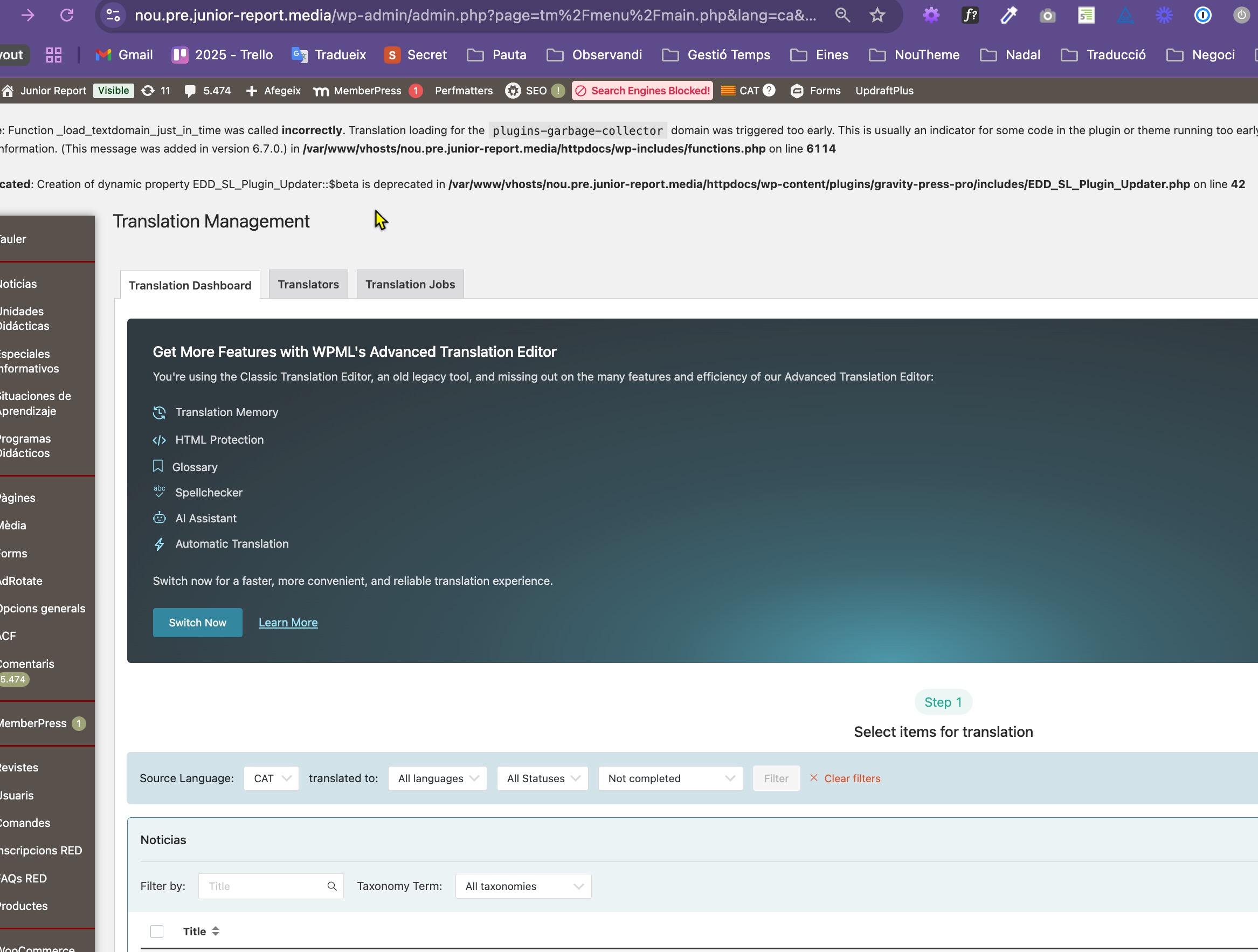

Hi, Otto, I can't see the notification that you said. I have tried also in settings of wpml, but I can't see any notification. Here is the screen I see.
I tried in catalan and spanish. We are not using english.

The issue does not happen with PHP7.4. In PHP 7.4 the code may only produce a warning/notices, whereas PHP 8 treats it as a fatal TypeError, which is why the issue disappears. Likewise, disabling ACFML likely avoids executing the problematic code path in WPML/ACFML, preventing the error.
We already have a similar issue, but it should be fixed now:
https://wpml.org/errata/advanced-custom-fields-fatal-error-uncaught-typeerror-illegal-offset-type-in-isset-or-empty-in
In the error stacktrace I can see:
/var/www/vhosts/nou.pre.junior-report.media/httpdocs/wp-content/themes/junior-report-2024/source/inc/admin-functions/acf-functions.php(18): acf_get_field_groups()
I'd start debugging from there. Debugging custom code is outside the scope of our support, but please let me know if there is something on our end and we will be happy to help.
Best Regards,
Otto
March 28, 2025 at 9:05 am #16871632
francescC-6
Thanks for pointing me in the right direction. The issue has been resolved after removed the function that calls the acf_get_field_gropus(). I will do the same in another way and I will contact the ACF plugin authors, because it seems something related with the compatibility of this function and PHP 8.
