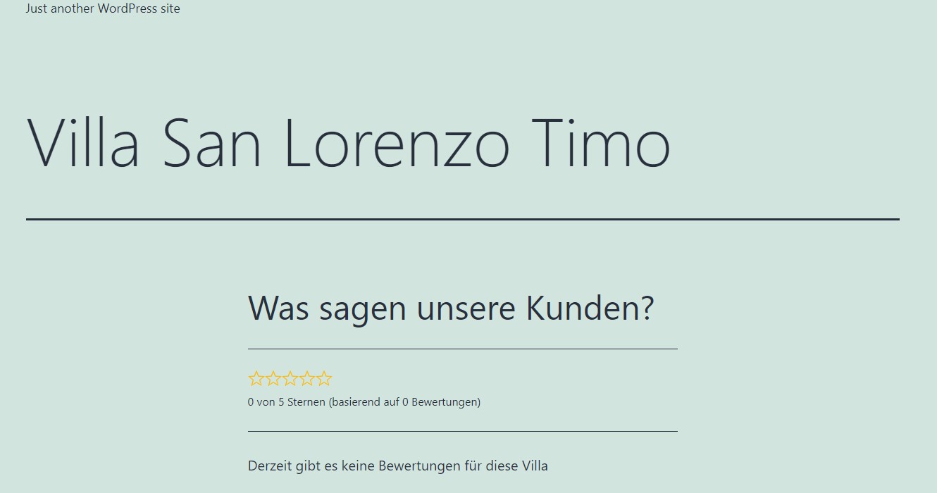

We are trying to import custom posts type in 3 languages in WPML based WP 5.8 system.
1: default lang EN => loads okay
2: second lang FR => loads okay and switching languages works fine
3: third lang DE => loads okay without noticeable errors but switching languages does not work okay. EN language is shown instead of EN translated in DE

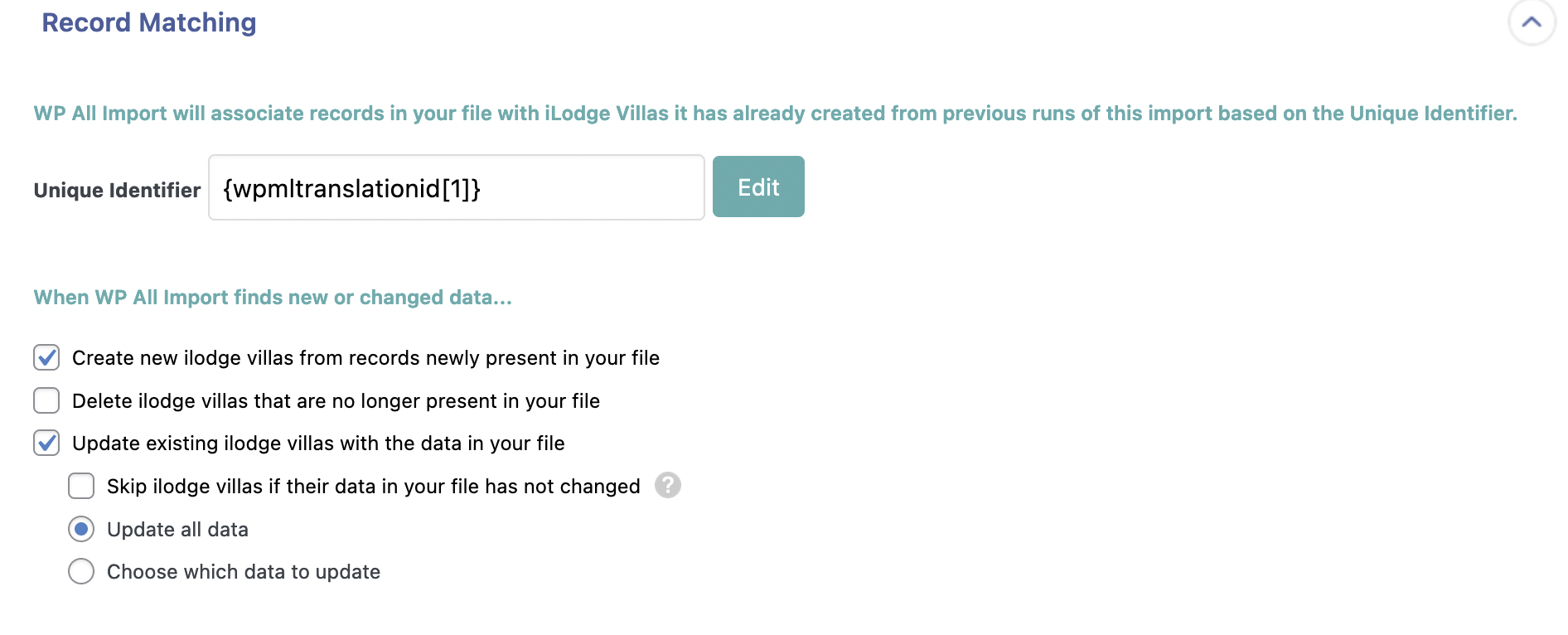

Hi Drazen,
Yes we managed to implement the workaround successfully on our website with one exception to your workaround though:
We changed the " Skip ilodge villas if their data in your file has not changed ?" setting from ticked to un-ticked.
So:
1 import of the EN lang (" Skip ilodge villas if their data in your file has not changed ?" un-ticked)
2 import of the FR lang (" Skip ilodge villas if their data in your file has not changed ?" un-ticked)
3 import of the DE lang (" Skip ilodge villas if their data in your file has not changed ?" un-ticked)
(ilodge villas = custom posts type)
We think it is safe to conclude that two (2) passes are currently required to upload multiple language .csv's to create functional multi-language posts when using WP All Import / WPML WP All import add-on to import data.
