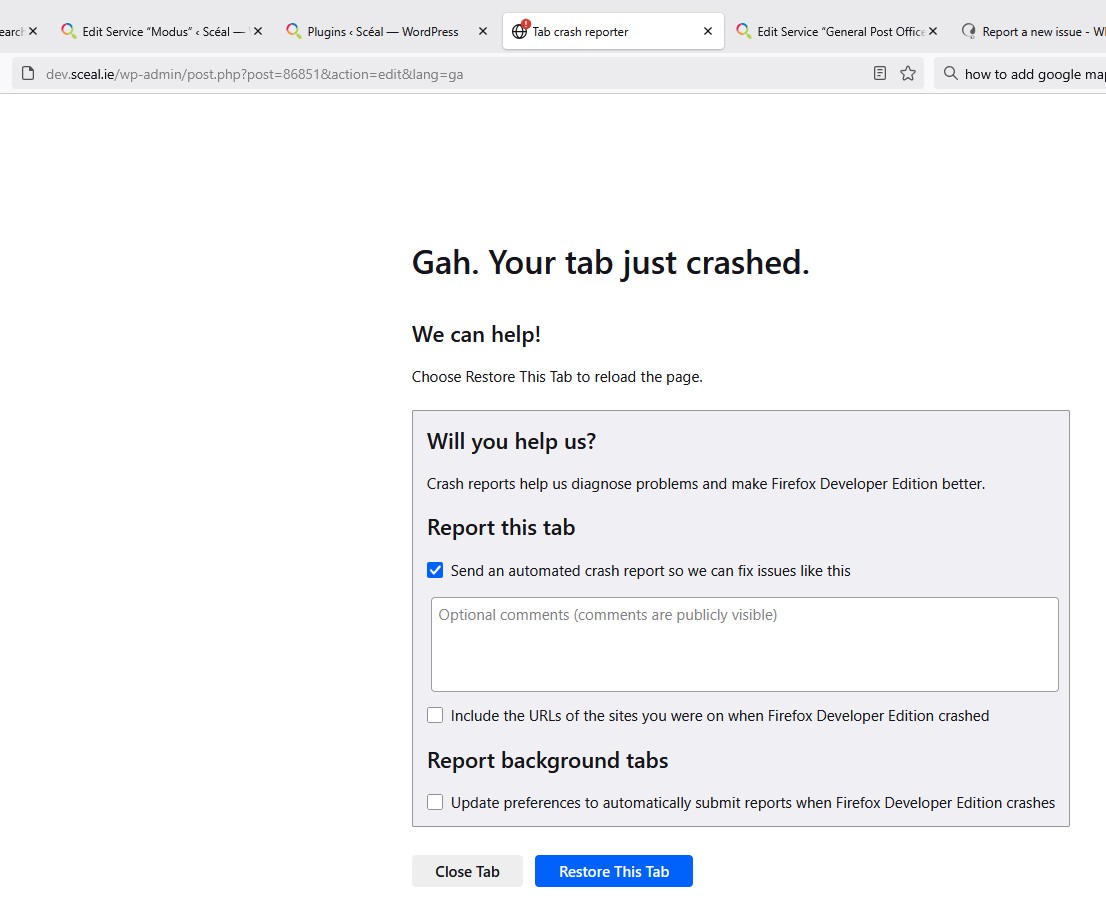

I am trying to use WPML and Classic Editor together, but when both are enabled, my browser tabs crash. I was attempting to access the page admin interface with the classic editor. The issue can be seen at this link: hidden link.
The browser tabs crash when WPML and Classic Editor are both enabled. Sometimes the editor opens but is squashed, though mostly the tab just crashes.
Why do my browser tabs crash when using WPML and Classic Editor together?
How can I prevent the editor from being squashed or the tab from crashing?

The complete crashing of the tabs has stopped, but you can see what's happening to the editor, I've created a video for this:
In console you'll notice this:
Uncaught TypeError: can't access property "top", $top.parent().offset() is undefined
The common plugins are WPML and Classic Editor.
May 14, 2025 at 2:44 pm #17033094
Thank you for your reply. As shown in this screen recording, the issue also occurs even when the WPML plugin is deactivated: hidden link .
I suspect that a third-party plugin may be causing the issue. I recommend deactivating your third-party plugins one by one to identify which one might be responsible.

David Henry
Thanks, there is a conflict between Betterdocs, Classic Editor and Simple Jobs Board.
