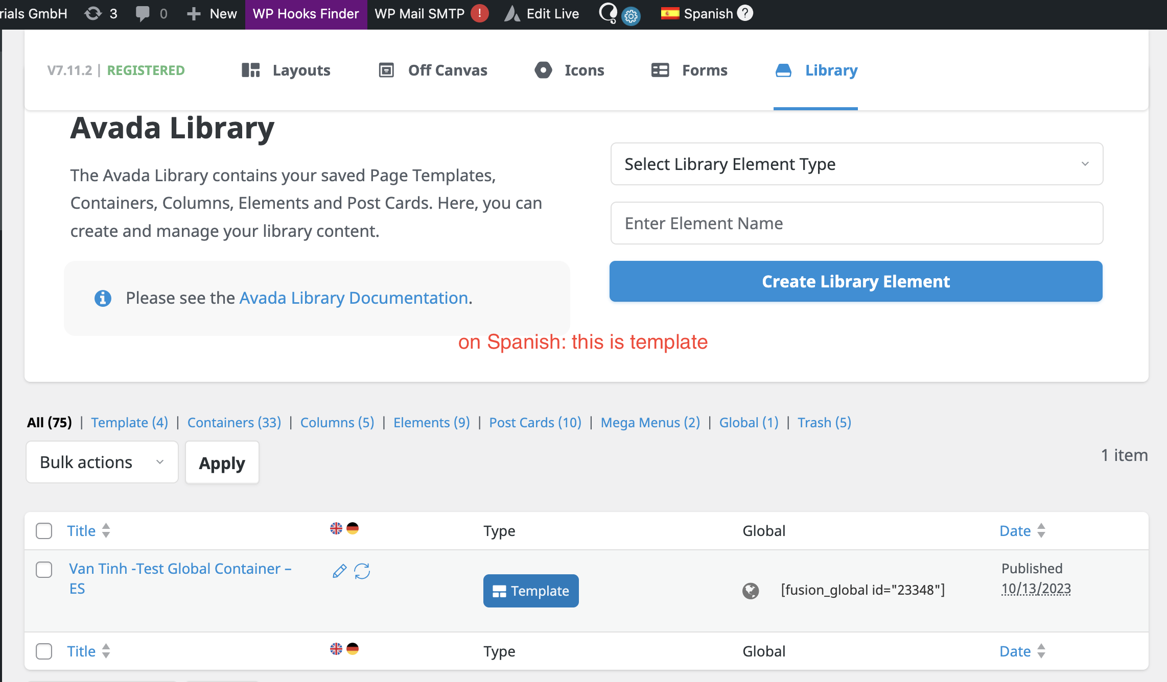

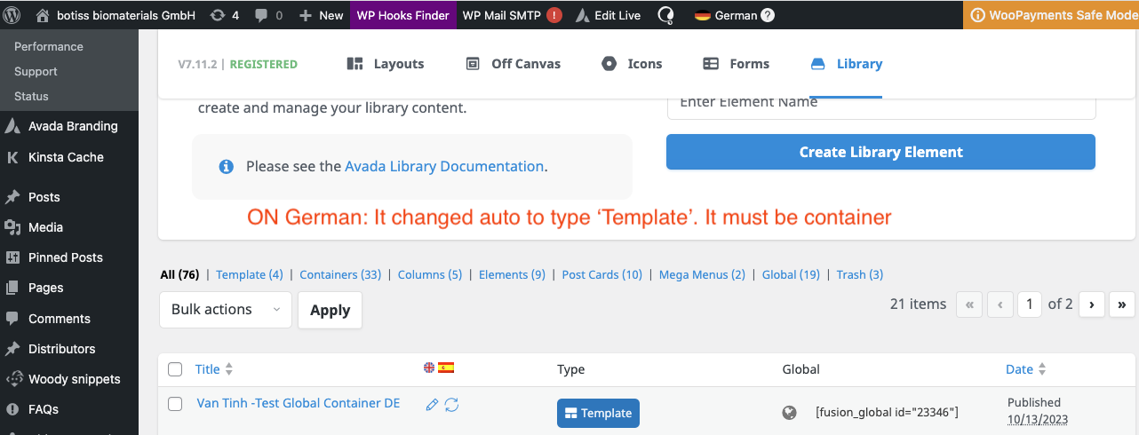

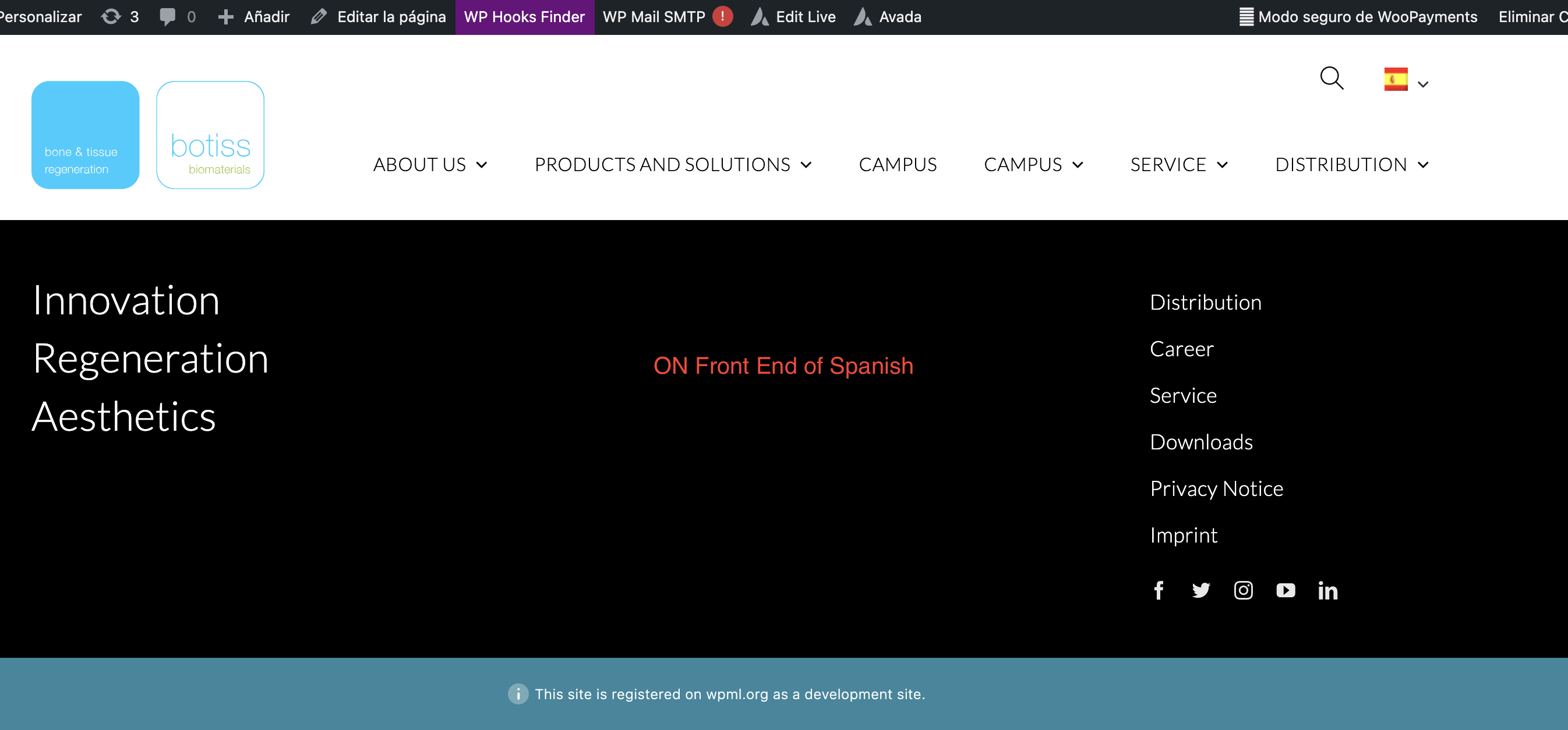

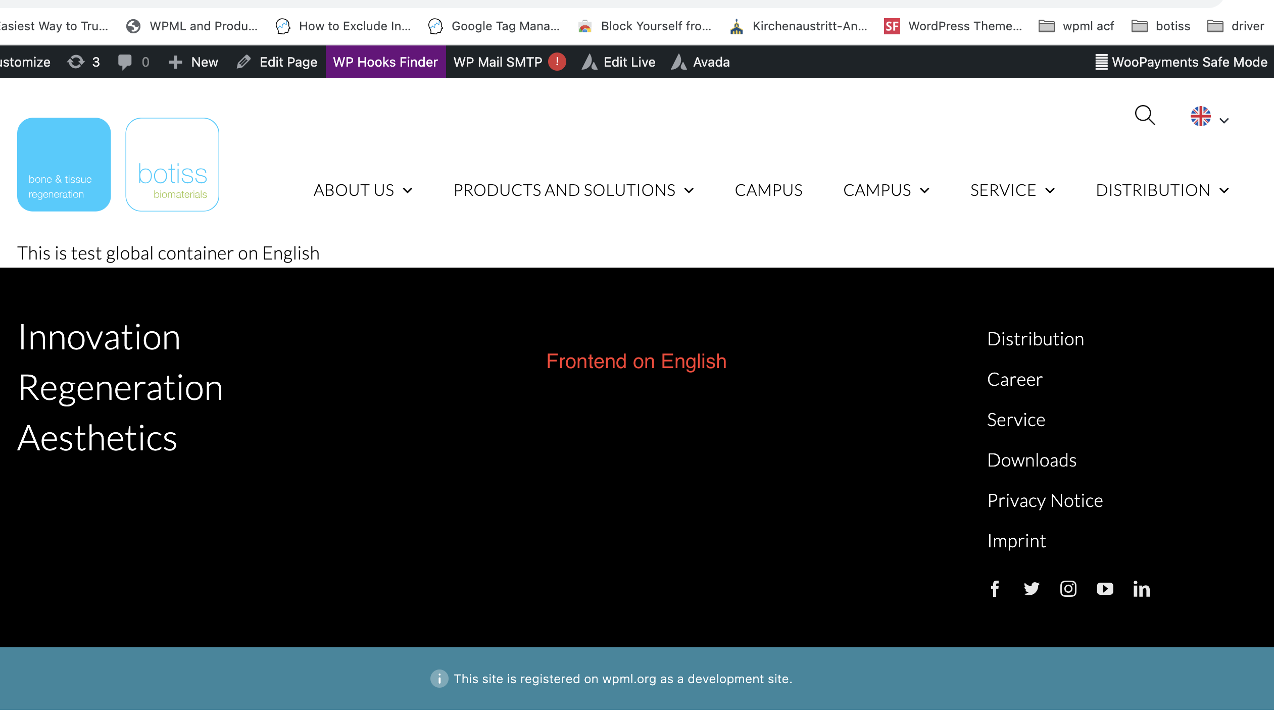

We want to translate this products, where contains normal element of avada page builder and somes global element of Avada Library. Then, the problem appeared during trying to translate the elements in Avada Library that:
- In English: The type of post is "Container"
- In German: After post's translating, the post shows another type "Element". I think it should be same type as Container like English Version. Because the translation did not show on frontend, even though the Library Container is already translated on German and Spanish.
