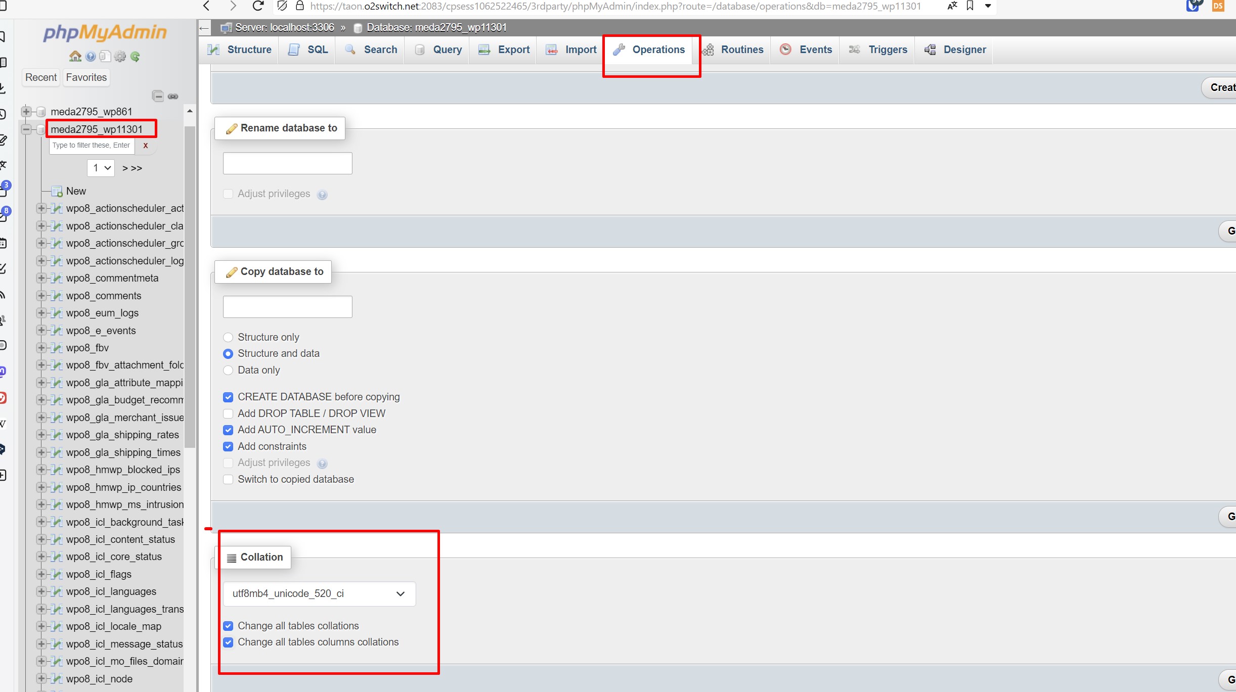

You mean having access to phpmyadmin ? This will be difficult to give you access to this, but here is a screenshot showing that all the tables and rows on the staging website now use "utf8mb4_unicode_520_ci" : hidden link
If you only need to use WordPress, I already gave you the credentials for the admin password.
Please tell how I can help.
October 7, 2024 at 11:30 am #16261038
You would need to make this adjustment also for the single rows on each table.
Is this the case?
October 7, 2024 at 11:39 am #16261056
daivyM
Yes. I used the Operations -> Collation tools for that.

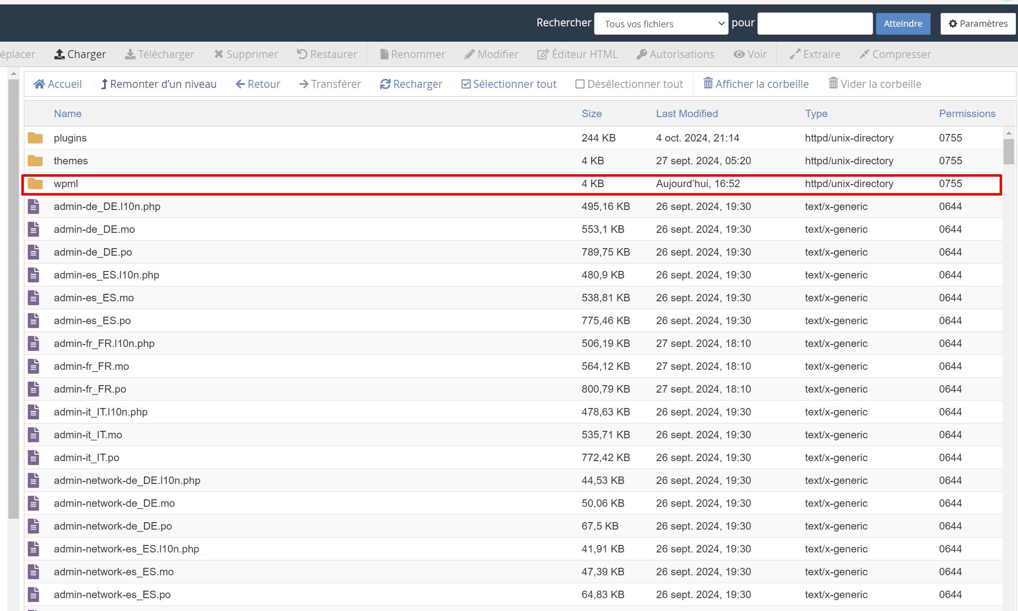

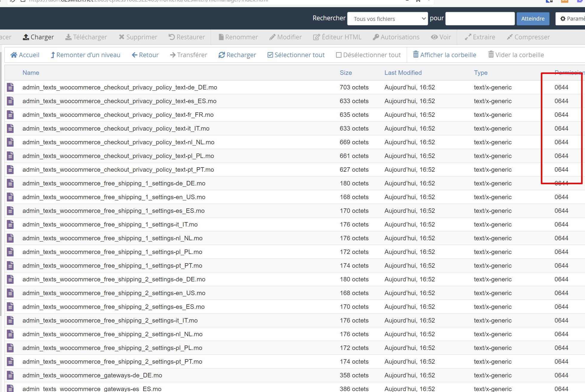

October 7, 2024 at 3:37 pm #16262610
daivyM
I appreciate your dedication and would like to thank you.
The WPML folder has the correct permissions (755), but not the .mo files (644).
Please check my sreenshots.
Should I change .mo permission to 755 ?
