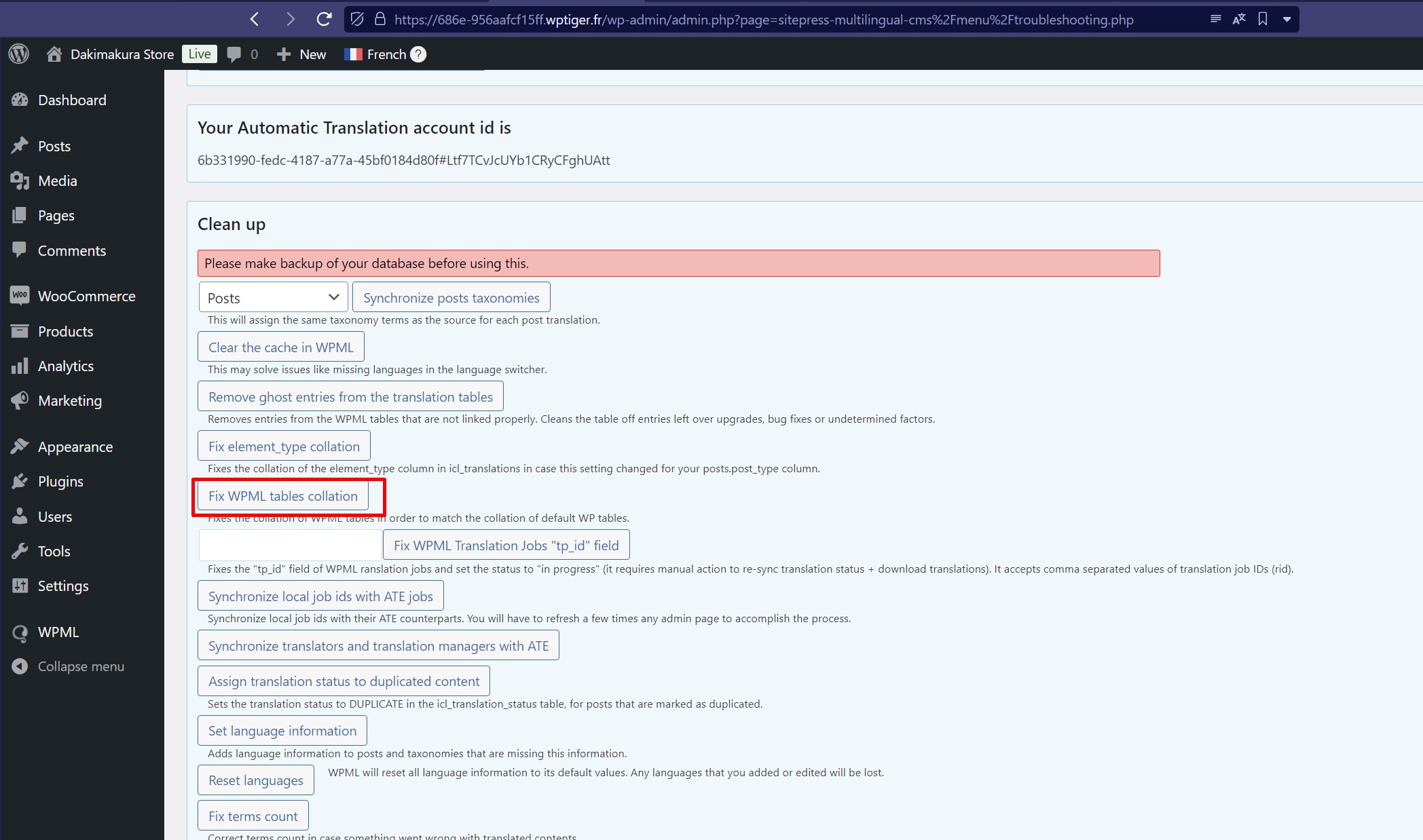

By the way, I noticed that clicking "Fix WPML tables collation" does not work either.
When I click on it, nothing happens.

When I last visited the site, all the translatiosn showed up on Frontend but not on WPML > String Translation. This is an unexpected and rare behavior and I was not able to figure out what is causing it.
On the local copy I had the same issue. Somehow everything was registered inside WPML to the text-domain "default". I cleaned up the whole string table, then scanned theme and plugins again and then it worked.
You find an option on WPML > String Translation to delete strings by domain. This was another step I took, but take note, that you might remove strings that you translated aleady.
