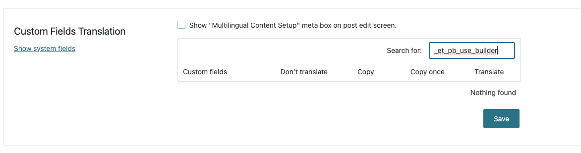

I have moved my website to the Elegant Themes Divi Builder and am using the classic editor to translate. Only the pages have been recreated in Divi. I created a wpml-config.xml file and put it in my child theme folder to make WPML recognize Divi Builder's custom fields. The file contains the following code: _et_pb_use_builder _et_pb_old_content _et_pb_layout _et_pb_post_hide_nav _et_pb_page_layout _et_pb_side_nav _et_pb_template_type _et_builder_version _et_pb_built_for_post_type I cleared the cache in WPML, set language information, and fixed the element type collation. Link to a page where the issue can be seen: hidden link
I still could not view the custom fields and make them translatable. On the front end, the translations are visible, but in the back end, I only see a title to translate and no page content. The layout is not updating as if the translations were no longer linked to the page. I am unable to set the Divi custom fields to 'Copy' because WPML doesn't recognize them.
How can I make WPML recognize Divi Builder's custom fields?
Why are the translations visible on the front end but not in the back end?

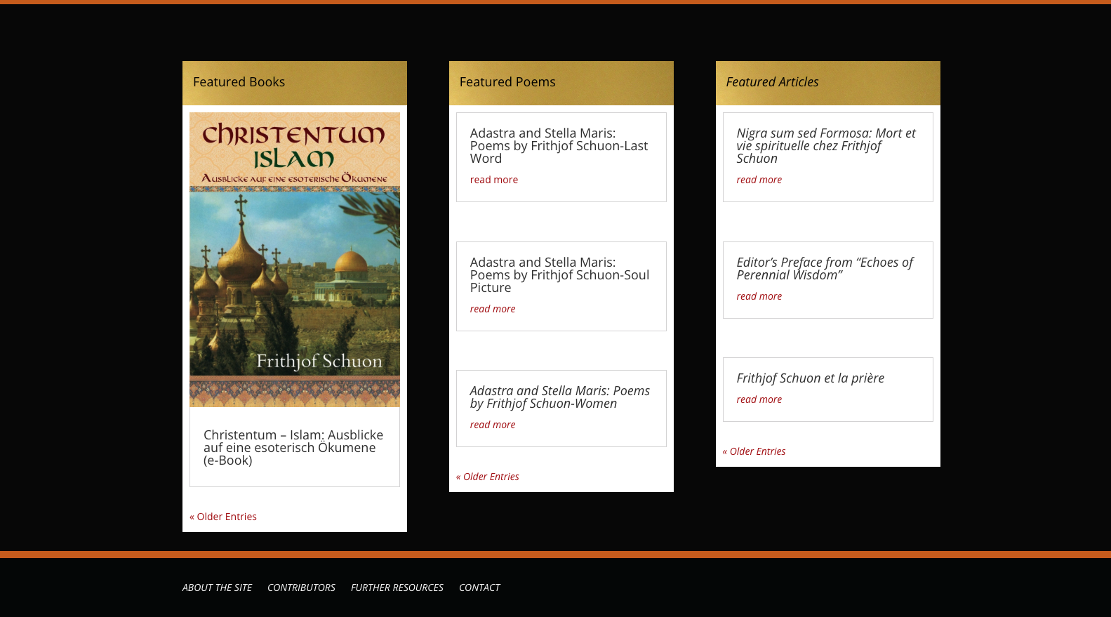

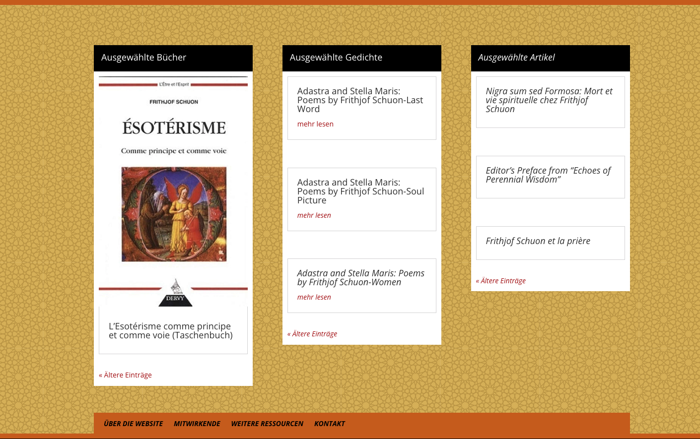

Hi and thanks for your wonderful help. I have now tested the home page and part of the content now is showing in the editor and I have been able to translate it into german. However, a part of the page (the footer) which is a global divi element does not show up on the translated pages. There is still an old footer layout there which I cannot make changes to. Can you check? The original english shows the correct footer which has a dark background whereas the german and french pages show an old version with a light background. I don't understand why wpml isn't seeing the changes to the original. Do I need to translate global elements somewhere else? Thanks once again for your great patience and assistance.
