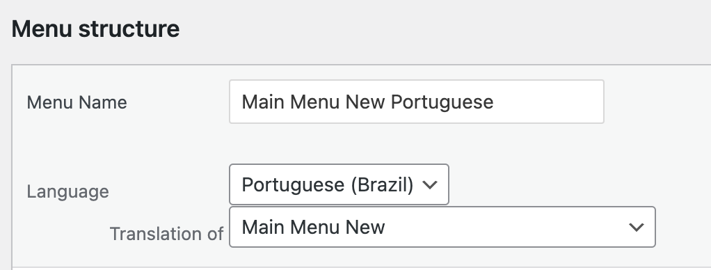

We created block structures for the headers and the footers and implemented them statically for English language. For every other language, we translate it from the English one and create a new header for that language. This way, whenever the page is in another language, it uses the translation of the English one. You can see below the Portuguese menu is the translation of the English one. When we set the fields to "Not Translatable" this translations gets deactivated so the pages doesn't render a header.

as I explained before, copy will only duplicated, while copy-once and translate will stay empty, that is if you translated field group correctly.
That should not be correct and act like this since you are setting field groups to Not Translatable not fields themself. So fields still stay in both languages and you can still translate them as before.
Do you have a staging site where we could try this out and check? You show what is not working when field groups set to not translatable and I think I can fix it, and correct your configuration. Of course, if you wish to proceed in this direction.
