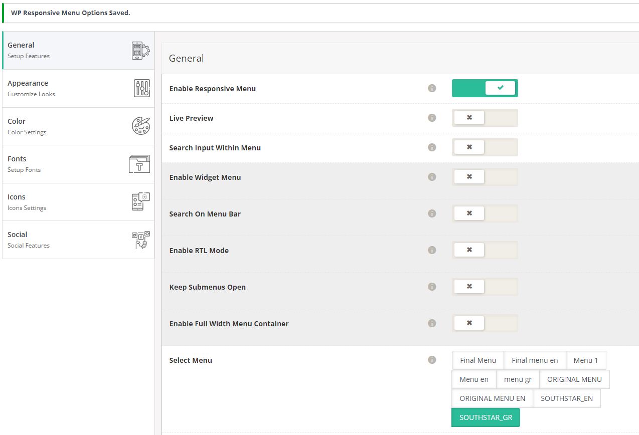

I’ve installed WPML in a development server and constructed a site. The transition of the pages in two languages is working perfectly, the same happens with the menu. I have a problem though with the mobile responsive menu. I use the WP Responsive Menu plugin.
I created a menu (Menu 1) in two languages and the plugin was working properly. I deleted this menu by mistake and created a new menu (SOUTHSTAR.GR) for both languages. Since then, although the menu in the first language is working properly in the mobile, when I change language the menu is not showing. The site is hidden link
I contacted the plugin and gave them access to investigate if there is a problem with them and they replied “As per the WPML correct menu is unable to save that's why the issue is happening. It should automatically save the en language. But it is not saving.”
Please help me to resolve this problem

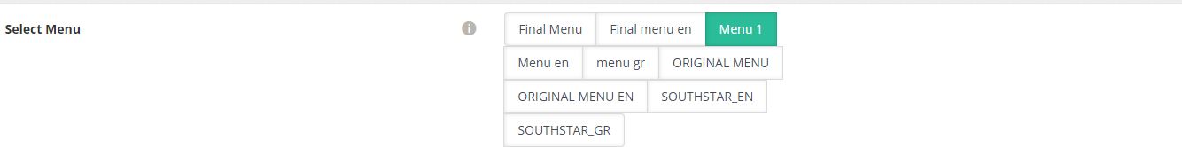

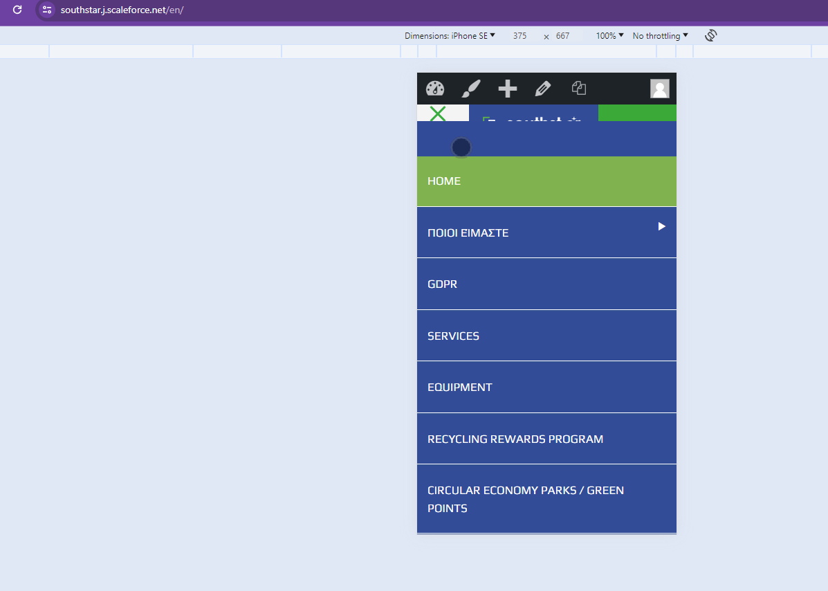

I have contacted them and they responded that they are compatible. And indeed their menu works with your plugin. But only with the deleted menu (menu 1) not with the rest. And when I pointed out that to them, as I did in my note to you, they replied that wpml cannot save the rest menus in order for the plugin to work properly. Check now that I have set the deleted menu as the reposnsive menu to see that it works in both languages.
The problem is that the deleted menu is unaccessible from the wp-admin and the rest menus are not being called by wpml when i change language.

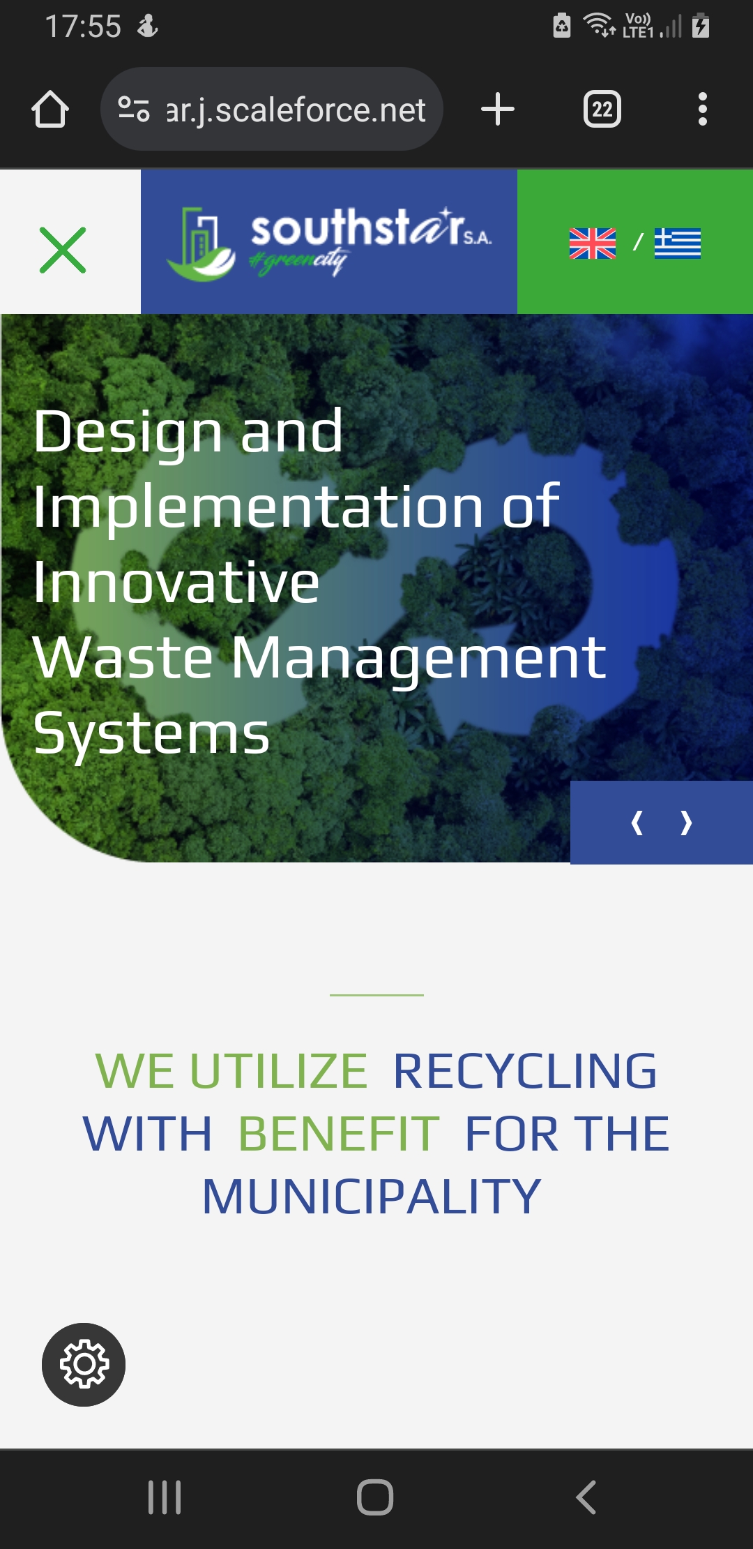

Did you sort it out on your own? because when I check on the mobile screen size, the English language menu shows up as shown in the attached screenshot.
March 1, 2024 at 7:30 pm #15364737
apostolosT-4
No this is the onlt menu that works, all the others are not working.
Check now
March 1, 2024 at 7:38 pm #15364756
apostolosT-4
I use SOUTHSTAR_GR menu with SOUTHSTAR_EN
