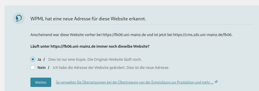

The banner appears as it seems that our system recognized that the main site URL was changed from cms.zdv.uni-mainz.de/ to fb06.uni-mainz.de.
According to our system, it is yet hidden link that is registered on your wpml.org account for this Multisite.
Now, if the primary domain of your site was changed to fb06.uni-mainz.de then the banner would be expected and this site URL should be the one that you use to register your Multisite on wpml.org.
At the moment I can not confirm that fb06.uni-mainz.de is registered on your wpml.org account.
Now, if in doubt, the best option to pick on the migration banner would always be "Copy" as like this you will make sure, that no matter where the site was migrated from, the origin and the new site will remain functioning and you will be able to share their translation memory and glossary.

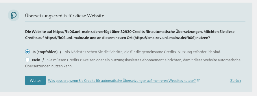

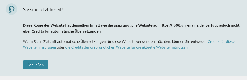

I cannot register fb06 because I do not get to a code:
Unfortunately there is an endless loop:
1. on the banner I choose "Copy" as you advised
2. I choose this link hidden link
on the next page:
Verbinden Sie die Credits für automatische Übersetzungen zwischen den beiden Kopien dieser Website.
Damit die Websites, die auf hidden link und hidden link laufen, dieselben Credits für automatische Übersetzungen verwenden, müssen Sie Folgendes tun:
3. I am on the banner page, again and have to choose between copy and new address
Help!

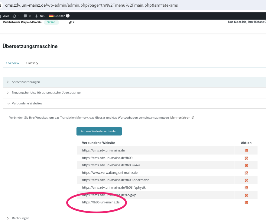

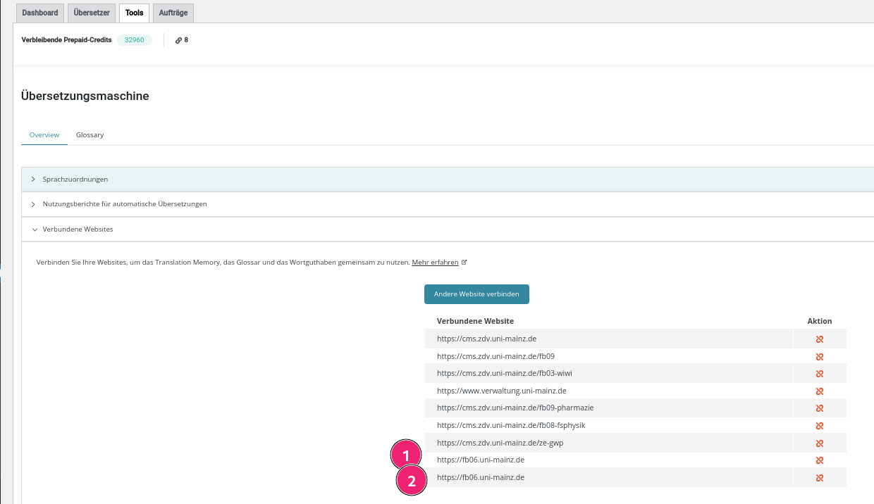

I took desperate measures und got out of the loop via unsetting and setting the credits new. Now the subsite cms.zdv.uni-mainz.de/fb06 with the primary domain name fb06.uni-mainz.de stars twice in the list in the main sites wpml. (See attached image)
How do I remove the double entry? How do I identify the old one?

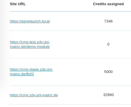

You do have both site URLs registered here:
https://wpml.org/account/sites/
Please remove the second domain and only leave the domain of your multisite's main site.

After this, in fb06.uni-mainz.de/wp-admin I get "WPML hat eine neue Adresse für diese Website erkannt".
If i do answer yes, it is a copy then I am in the Loop mentioned again, instead of the key after the next screen I get the start screen again. (first and second screenshot)

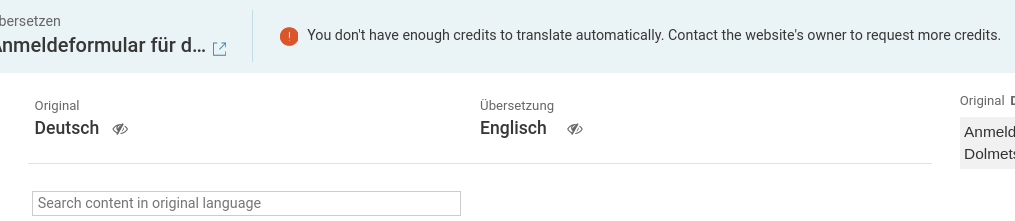

If I do answer no it seems that I have no credits (third and last screenshot)
In the main sites wpml: hidden link
there are still two lines for fb06.uni-mainz.de
How do I get rid of these?
