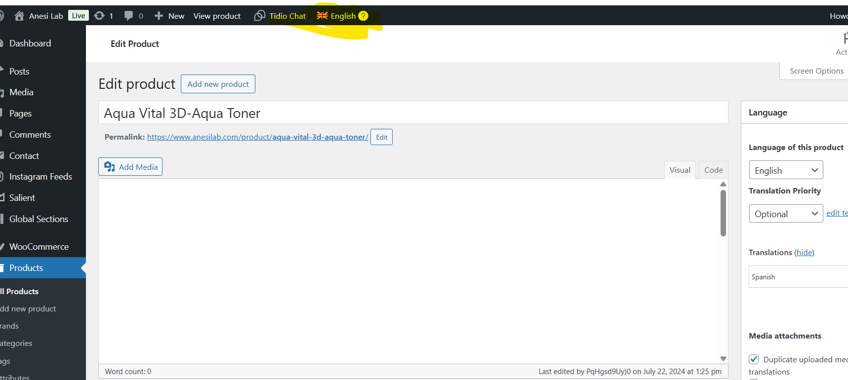

When I removed from my website WPML String Translation and Wocoomerce translation the permalink were not available anymore to translate. As you can see in the picture and as I told you I remove them because WPML String Translation was getting by default my gallery in English and did not give me the option to add them in Spanish. And now I have not translated my permalinks because I removed those plugins.
Please can you help me with this problem. What is the correct way to do it. To get a gallery for each language and do not get by default the gallery of the page translated. And at the same time translate the permalinks.
Thank you so much.

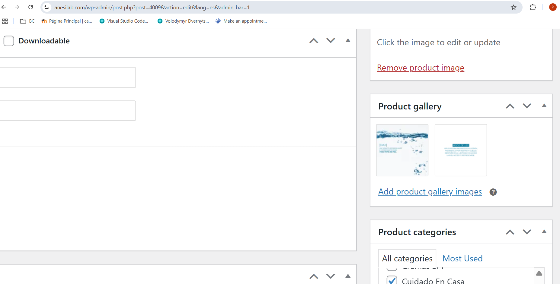

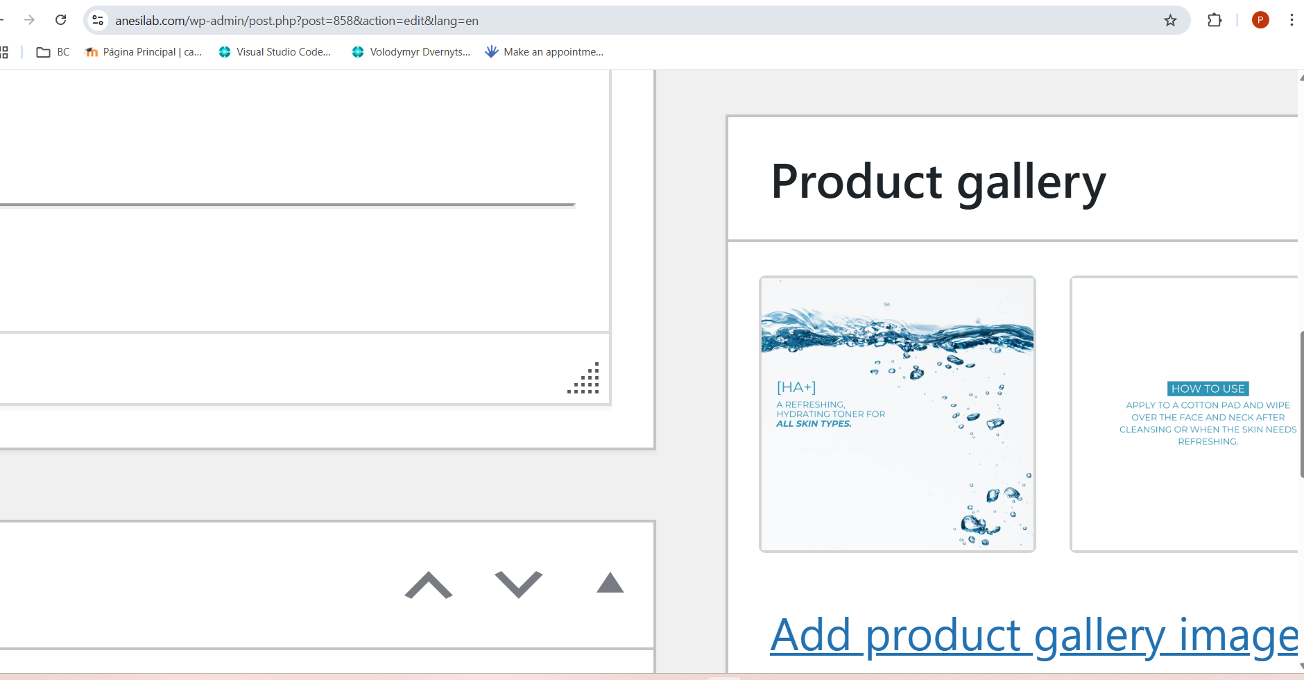

August 11, 2025 at 3:18 pm #17310579
grupo-drvP
They are the standard gallery and a standard way to translate them.
As I told you, I did this :
Page A version English -> I add my gallery in English.
And Page A version Spanish -> I add my gallery in Spanish.
I translate them using the button English and changing to Spanish. Why? because, it was the only way to do it.
Thank you
